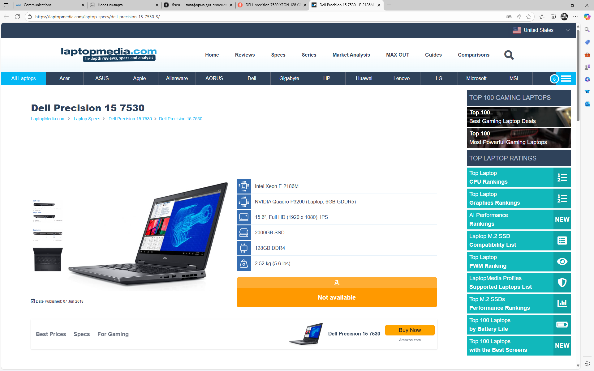

Mambucho Posted September 10, 2025 Share Posted September 10, 2025 1 hour ago, uzi said: im abit skeptical about if 128gb works, I bought the 96gb kit, what do you think reference: this is for models 7530 7730 7740 7540 with XEON 32Gb*4, for other models from this series only 16*4 or 32*2 maximum Dell Precision 7680, RTX 3500 ADA, CAMM 32 ГБ, FHD+, WIN 11 Pro for Workstations (25H2.Dev) Link to comment Share on other sites More sharing options...
uzi Posted September 10, 2025 Share Posted September 10, 2025 1 hour ago, Mambucho said: this is for models 7530 7730 7740 7540 with XEON 32Gb*4, for other models from this series only 16*4 or 32*2 maximum @Mambucho how confident are you that it will be able to support 128gb 😄 Link to comment Share on other sites More sharing options...
Mambucho Posted September 11, 2025 Share Posted September 11, 2025 On 9/10/2025 at 8:25 AM, uzi said: @Mambucho how confident are you that it will be able to support 128gb 😄 https://notebooktalk.net/topic/2482-precision-7530-upgrade/ Dell Precision 7680, RTX 3500 ADA, CAMM 32 ГБ, FHD+, WIN 11 Pro for Workstations (25H2.Dev) Link to comment Share on other sites More sharing options...

uzi Posted September 13, 2025 Share Posted September 13, 2025 On 9/12/2025 at 3:54 AM, Mambucho said: https://notebooktalk.net/topic/2482-precision-7530-upgrade/ I mean for 7680, won't it cause instability or maybe processor modified by Dell to only support up to 96gb? I'm asking cuz I'm really tempted 😂 Link to comment Share on other sites More sharing options...
Mambucho Posted September 13, 2025 Share Posted September 13, 2025 5 hours ago, uzi said: I mean for 7680, won't it cause instability or maybe processor modified by Dell to only support up to 96gb? I'm asking cuz I'm really tempted 😂 You have already been answered about 96 Gb RAM, in the comment above Dell Precision 7680, RTX 3500 ADA, CAMM 32 ГБ, FHD+, WIN 11 Pro for Workstations (25H2.Dev) Link to comment Share on other sites More sharing options...
