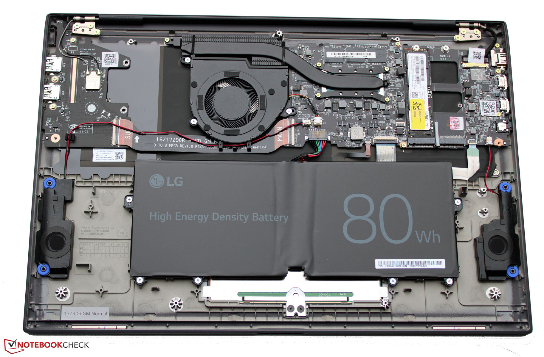

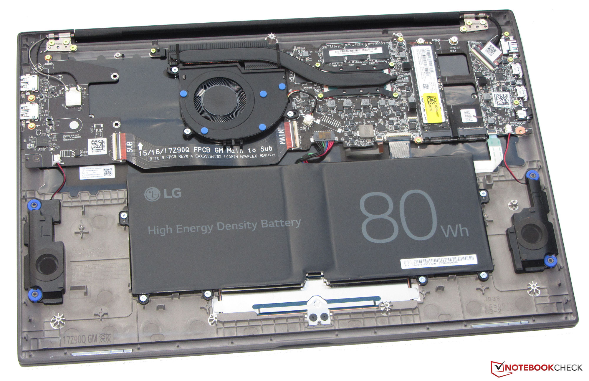

I've just checked the LG UK website and it mentions "**Modified keyboard location to improve the airflow. Larger fan with more blades. Applied graphite sheet under the keyboard. The advanced cooling feature is in comparison to the preceding model" with this video. Comparing notebookcheck's internal photos of the 2022 and 2023 versions confirms that the latter has a larger diameter fan.
2022
2023
csm_LG_Gram_17_17Z90R_Hardware1_57595fa6
This difference isn't mentioned in the notebookcheck review but could well be a factor in the 2023 model being about 50% faster in the benchmark tests than the 2022 model. i7 vs i5 CPUs doesn't make much difference once there's thermal throttling.
