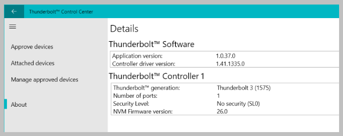

So far, so good!     I've setup two WD19TB and two WD22TB4 docks to be shared among two 7710 laptops at various office locations.
Prep work involved:
- Updating to latest 7710 BIOS Version/Date:  Dell Inc. 1.31.3, 3/9/2023
- Uninstalling old legacy Thunderbolt Control Center apps and drivers and installing latest shown below:
Works great with the WD19TB and WD22TB4 docks!  Very happy once I completed all the cable management.
