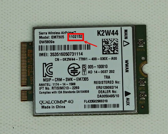

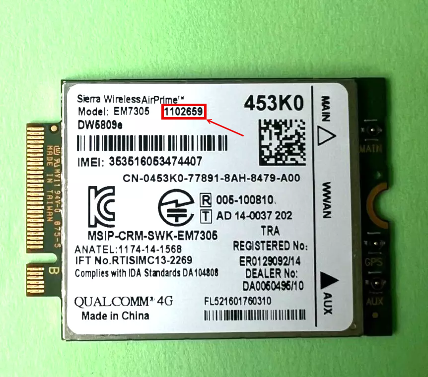

the difference appears to be their SKU's from Sierra who are the card manufacturer. the SKU is the seven digit number that is on the same line as the model name:
0453K0
0K2W44

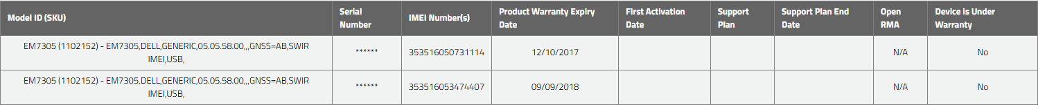

the warranty checker on the Semtech\Sierra Wireless website is a great way to see the differences between two modules: https://csm.semtech.com/WarrantyChecker.aspx inputting the IMEI of the two modules i've posted above shows that they are in fact the same SKU despite what the label on the 0453K0 shows:

lead me to believe that there is no difference between the hardware of the p/n's that you posted.
