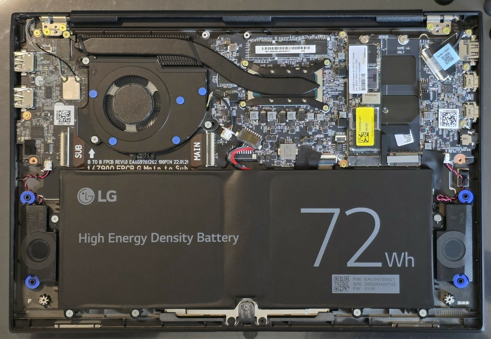

5. The case, battery and display seems to be that used for the other 2025 models (the bottom cover has a February 2025 date stamp).
6. The keyboard is backlit. It has two SSD slots, so no spec trimming for the budget model. The supplied SSD, however, is Phison - not a well-known brand.

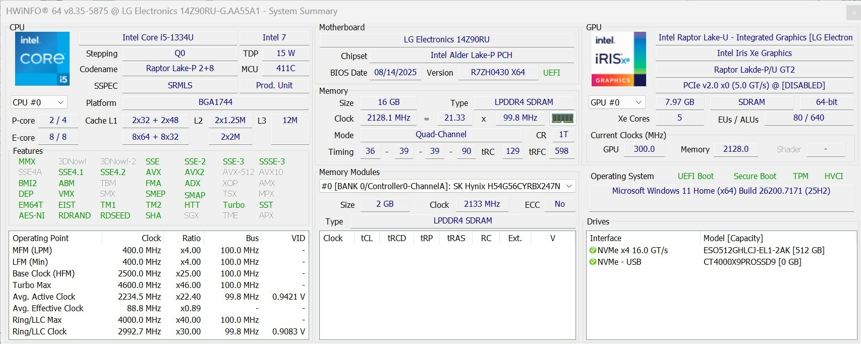

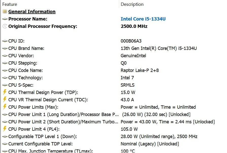

7. HWiNFO provides some useful information about the CPU power limits:
This shows that the CPU is capable of much higher power for shorter periods. Under load the fan noise is noticeable but not annoying.
8. On first charging the battery showed 69.7 Wh - about 3% short of the rated 72 Wh. This may improve with a bit of power cycling.

20. The battery capacity is around 69Wh and not the 72Wh on the label. However, this is still more than most 14" notebooks and very good considering the notebook weight of less than 1kg. There may also be a clever battery charging algorithm at work which has realised that I don't need the full 72Wh.
