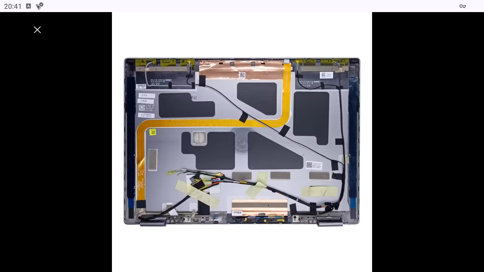

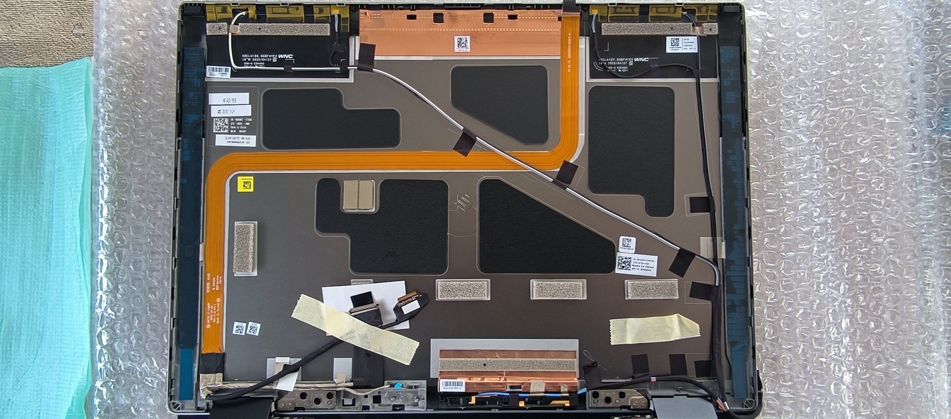

Mambucho Posted July 15, 2025 Share Posted July 15, 2025 On 2/3/2024 at 2:27 AM, rintalahri said: I found wwan lid in ebay, but where i can search antennas? any recommendations where i can found those? https://www.ebay.com/itm/357068970082?_skw=Laptop+Back+Covers+for+Dell++precision+7680+WWAN&itmmeta=01K04YDTQDQ610QDKABHNDCVYZ&hash=item5322f81862:g:ZCQAAOSw~0RoR5Cz&itmprp=enc%3AAQAKAAAA8FkggFvd1GGDu0w3yXCmi1f8YMtuFTqUtzp2e%2FRyXTzbXC2BQi0VS4NsT8%2BvSedCyYqBSQXuxtr3zFqtJZiStEMGcewSkpYLmmjvmmx5w7Luj8OXgvuQpXKO%2BJipxg9UIZSFJMD1Kw%2F1cmYMfws5hoWMAlheRI2P2IyO9op7SEYQco0biFLH5wMH1z5IifPlyKy88Sj79NbDlKapPfo5iqCPwxWxJG335U8blKS2FOt0O4%2B%2Bch%2FmGNQmeeAbY4NlOKG4uJtnupy8ogvv6zJsjghFM0QMsiNU2Lq8osM7LYYWEpOTnsA3vOzMJqg3066WvA%3D%3D|tkp%3ABk9SR_Srt56BZg Dell Precision 7680, RTX 3500 ADA, CAMM 32 ГБ, FHD+, WIN 11 Pro for Workstations (25H2.Dev) Link to comment Share on other sites More sharing options...
Mambucho Posted July 16, 2025 Share Posted July 16, 2025 Received the order, the cover with antennas came in the factory box, with a double protective film. This cover is for the version with an infrared video camera. If you have a cover with a single video camera, you will need to move the cable and video camera to the new cover Not for 4K! The 4K version does not support WWAN. Dell Precision 7680, RTX 3500 ADA, CAMM 32 ГБ, FHD+, WIN 11 Pro for Workstations (25H2.Dev) Link to comment Share on other sites More sharing options...

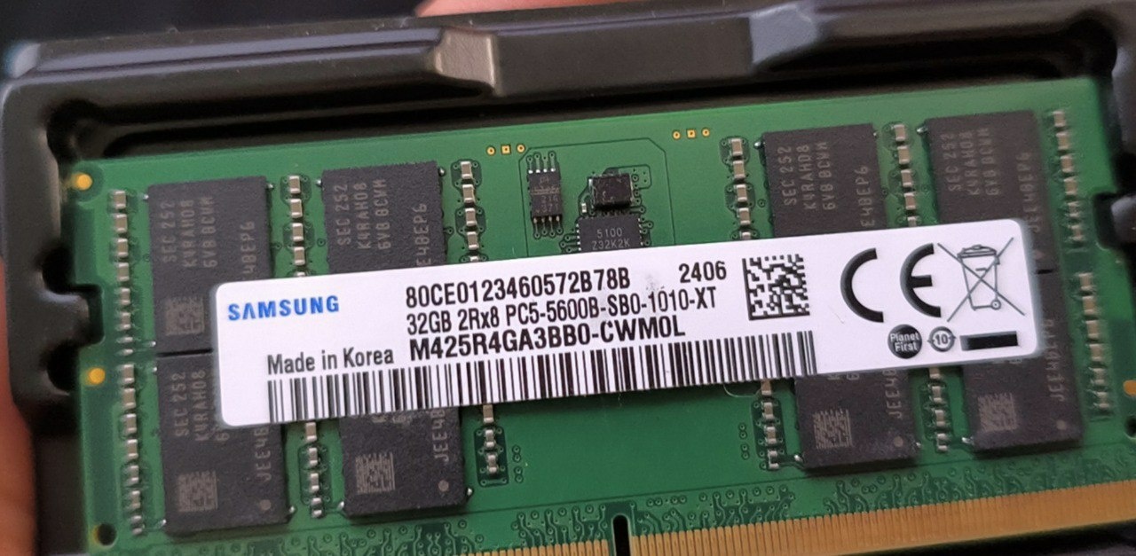

uzi Posted August 19, 2025 Share Posted August 19, 2025 @MambuchoI purchased a sodimm interposer with thin plate for 32gb x 2 RAMs, unfortunately only 1st slot works with both RAMs and second slot always results in 4 white + 2 amber lights indicating memory error. what might be the issue ? 😞 Link to comment Share on other sites More sharing options...
Mambucho Posted August 19, 2025 Share Posted August 19, 2025 2 hours ago, uzi said: @MambuchoI purchased a sodimm interposer with thin plate for 32gb x 2 RAMs, unfortunately only 1st slot works with both RAMs and second slot always results in 4 white + 2 amber lights indicating memory error. what might be the issue ? 😞 I also had this problem at the beginning, when I installed a thin SODIMM plate, there were 4 white flashes and 2 orange flashes, and the power button indicator disappeared. This is not a sign of a device malfunction, so do not worry about the thickness of the plate. Reinstall the CAMM, start the laptop, then turn it off through the "START" menu, and then remove the battery. After installing the SODIMM, make sure that the pressure plate is evenly secured without any distortion, and that each bolt is tightened in turn with a small step. I changed the CAMM to SODIMM several times, and it started. SODIMM initialization takes a few minutes, and if the initialization is successful, the button indicator should not turn off. Be very careful with the contact plate, as the contact may fall out if it is touched with any object. When installing SODIMM 32×2 (64), the memory will be reduced from 5600MT/s to 5200MT/s, as it should be Dell Precision 7680, RTX 3500 ADA, CAMM 32 ГБ, FHD+, WIN 11 Pro for Workstations (25H2.Dev) Link to comment Share on other sites More sharing options...
uzi Posted August 19, 2025 Share Posted August 19, 2025 12 hours ago, Mambucho said: I also had this problem at the beginning, when I installed a thin SODIMM plate, there were 4 white flashes and 2 orange flashes, and the power button indicator disappeared. This is not a sign of a device malfunction, so do not worry about the thickness of the plate. Reinstall the CAMM, start the laptop, then turn it off through the "START" menu, and then remove the battery. After installing the SODIMM, make sure that the pressure plate is evenly secured without any distortion, and that each bolt is tightened in turn with a small step. I changed the CAMM to SODIMM several times, and it started. SODIMM initialization takes a few minutes, and if the initialization is successful, the button indicator should not turn off. Be very careful with the contact plate, as the contact may fall out if it is touched with any object. When installing SODIMM 32×2 (64), the memory will be reduced from 5600MT/s to 5200MT/s, as it should be @Mambucho Thanks for your reply will try this out and update. May I clarify if you faced the exact same scenario as me ?Because the RAM gets detected with 32gb on first slot just don't know why installing ram on the second slot always results in the 4 white + 2 amber error. Even just installing 1 ram stick on the second results in the same error Link to comment Share on other sites More sharing options...
uzi Posted August 20, 2025 Share Posted August 20, 2025 12 hours ago, Mambucho said: I also had this problem at the beginning, when I installed a thin SODIMM plate, there were 4 white flashes and 2 orange flashes, and the power button indicator disappeared. This is not a sign of a device malfunction, so do not worry about the thickness of the plate. Reinstall the CAMM, start the laptop, then turn it off through the "START" menu, and then remove the battery. After installing the SODIMM, make sure that the pressure plate is evenly secured without any distortion, and that each bolt is tightened in turn with a small step. I changed the CAMM to SODIMM several times, and it started. SODIMM initialization takes a few minutes, and if the initialization is successful, the button indicator should not turn off. Be very careful with the contact plate, as the contact may fall out if it is touched with any object. When installing SODIMM 32×2 (64), the memory will be reduced from 5600MT/s to 5200MT/s, as it should be @MambuchoNo luck man, I tried what you recommended but the second slot of the interposer just does not work, the first slot that is nearer to the connector always works with both my RAM sticks. Link to comment Share on other sites More sharing options...
Mambucho Posted August 20, 2025 Share Posted August 20, 2025 9 hours ago, uzi said: @Mambucho Thanks for your reply will try this out and update. May I clarify if you faced the exact same scenario as me ?Because the RAM gets detected with 32gb on first slot just don't know why installing ram on the second slot always results in the 4 white + 2 amber error. Even just installing 1 ram stick on the second results in the same error Yes, that's what happened to me, but then it started working. Do you have XMP 3.0 memory? I read about this issue somewhere, but I can't remember where, and it seems that the default profile is set to 4800 MT/s, which causes an error if it's a SODIMM with XMP, but the DP 7680 BIOS doesn't have a profile management mechanism for DDR5 XMP. I managed to get it working after several CAMM-to-DDR exchanges, so you might need to try more times. I installed the SODIMM board with DDR×2, then I left it for 30 minutes, then I exchanged it for CAMM. You need a little patience, but you can run the DDR modules. I managed to do it Dell Precision 7680, RTX 3500 ADA, CAMM 32 ГБ, FHD+, WIN 11 Pro for Workstations (25H2.Dev) Link to comment Share on other sites More sharing options...
uzi Posted August 20, 2025 Share Posted August 20, 2025 23 minutes ago, Mambucho said: yes, I had it like that, then it started working. Do you have memory with XMP 3.0? @Mambucho this is the one I have, dont think it uses XMP Link to comment Share on other sites More sharing options...
uzi Posted August 20, 2025 Share Posted August 20, 2025 32 minutes ago, Mambucho said: Yes, that's what happened to me, but then it started working. Do you have XMP 3.0 memory? I read about this issue somewhere, but I can't remember where, and it seems that the default profile is set to 4800 MT/s, which causes an error if it's a SODIMM with XMP, but the DP 7680 BIOS doesn't have a profile management mechanism for DDR5 XMP. I managed to get it working after several CAMM-to-DDR exchanges, so you might need to try more times. I installed the SODIMM board with DDR×2, then I left it for 30 minutes, then I exchanged it for CAMM. You need a little patience, but you can run the DDR modules. I managed to do it @Mambucho ok let me try a few more times, by the way what is your rationale for doing the CAMM-to-DDR exchanges and also when you left it for 30 minutes you mean when the 4 white and 2 amber lights were blinking ? Link to comment Share on other sites More sharing options...
Mambucho Posted August 20, 2025 Share Posted August 20, 2025 51 minutes ago, uzi said: @Mambucho ok let me try a few more times, by the way what is your rationale for doing the CAMM-to-DDR exchanges and also when you left it for 30 minutes you mean when the 4 white and 2 amber lights were blinking ? DDR - CAMM - DDR exchange was an attempt to run it by luck, I didn't want to think that I had lost money. I bought a SODIMM DDR5 -5600 XMP.3.0, and I found "4 white and 2 yellow flashes", I thought that this was the initialization of the memory, and I waited for a long time. Then I realized that this was a problem, and I installed CAMM again, and I did this several times, and miraculously, the power button did not turn off when the laptop was on, and I waited for about 4 minutes for the correct initialization. Dell Precision 7680, RTX 3500 ADA, CAMM 32 ГБ, FHD+, WIN 11 Pro for Workstations (25H2.Dev) Link to comment Share on other sites More sharing options...
uzi Posted August 20, 2025 Share Posted August 20, 2025 20 minutes ago, Mambucho said: DDR - CAMM - DDR exchange was an attempt to run it by luck, I didn't want to think that I had lost money. I bought a SODIMM DDR5 -5600 XMP.3.0, and I found "4 white and 2 yellow flashes", I thought that this was the initialization of the memory, and I waited for a long time. Then I realized that this was a problem, and I installed CAMM again, and I did this several times, and miraculously, the power button did not turn off when the laptop was on, and I waited for about 4 minutes for the correct initialization. @Mambuchomay I know what brand/model are your rams ? Link to comment Share on other sites More sharing options...
Mambucho Posted August 20, 2025 Share Posted August 20, 2025 1 hour ago, uzi said: @Mambuchomay I know what brand/model are your rams ? SODIMM DDR5 Kingston FURY impact 64GB (32*2) 5600MT/s KF556S40IBK2-64 (support XMP 3.0) Dell Precision 7680, RTX 3500 ADA, CAMM 32 ГБ, FHD+, WIN 11 Pro for Workstations (25H2.Dev) Link to comment Share on other sites More sharing options...
