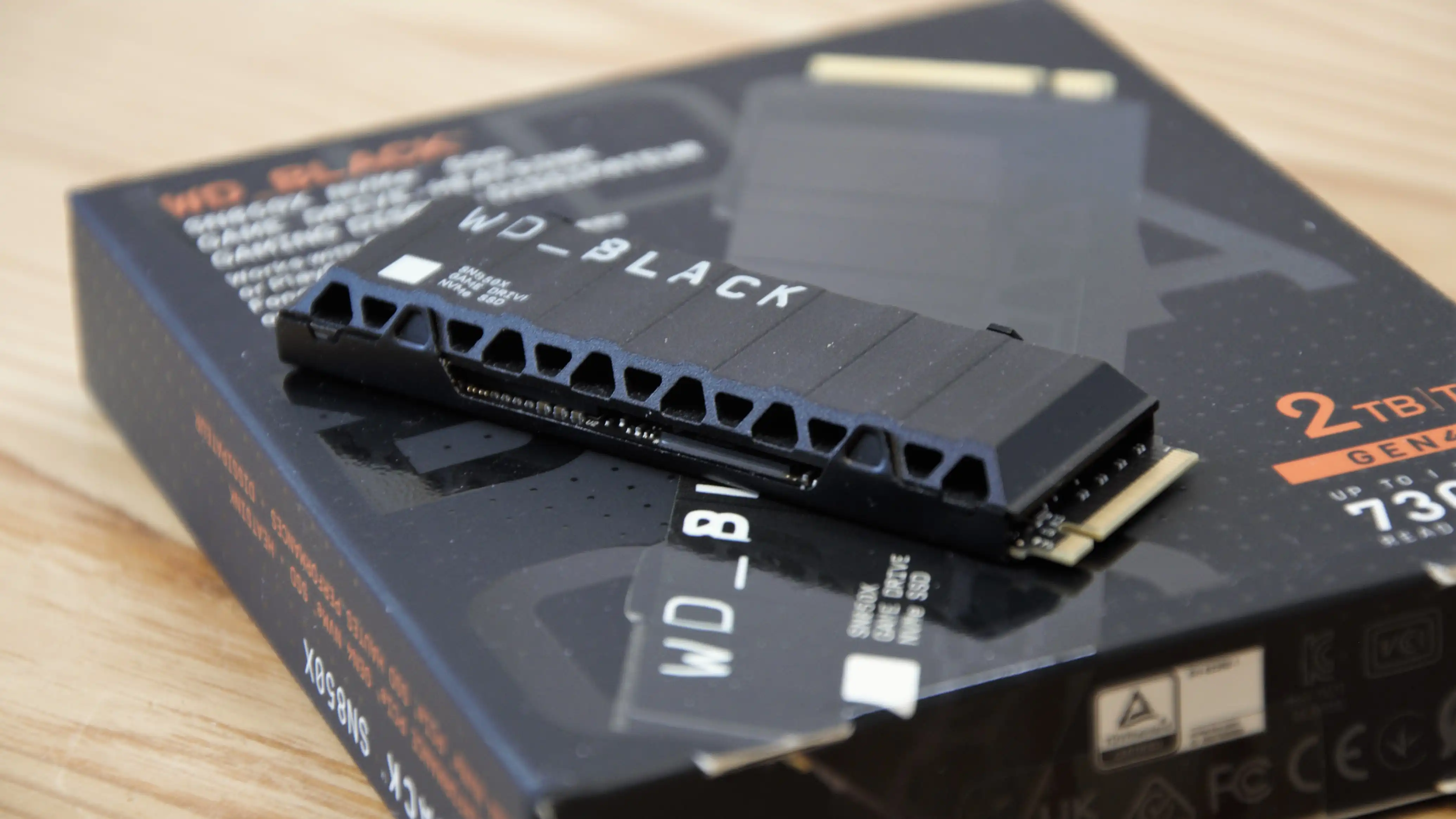

Those likely will not fit. The bottom panel has metal heatsinks for each SSD that make contact via a thick pad. Those heatsinks are riveted to the bottom panel so it would need to be modified.
There is also a concern that the fourth drive slot may not fit a double sided SSD as it is on top of the wifi card. I need to test it out next time I have it opened.

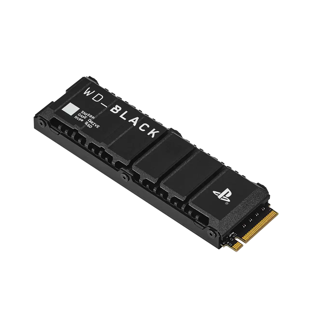

I like the cooling concept but on the other hand it does not bode well for my 8TB WD SD for the PS5:
wd-black-sn850p-nvme-ssd-for-ps5-angled.
It fit perfectly in the Raider 18 HX and it really runs pretty cool so it is a bit of a shame that I may have to get rid of it if I switch to the X580.
According to XMG / Schenker it will take 4 double sided drives, I specifically asked for that. So that is good news for those of use that really have 4 double sided NVME drives to fill up all those slots.
If you did not have those freezing issues before then it may indeed be because of the memory but there also seems to be something that keeps Schenker / XMG from launching the Key 18 model as it still isn't available for order on their website.
I donno I think they might fit, I measured it give you an idea and all
but if it doesn't I can probably remove the heatsinks on the ssds so they can fit(or try and remove the heatsink parts
on the bottom cover lol)

As far as the SSD heatsinks I cannot comment how well they work as I have not paid attention to the SSD temperatures closely. The plates attached to the bottom cover appear to be somewhat thick and heavy, hopefully they are powdercoated copper. I have not swapped in a higher performance drive yet from the stock Crucial P3 1TB which likely does not generate much heat under sustained transfers. I will try to test those things out when I can.
