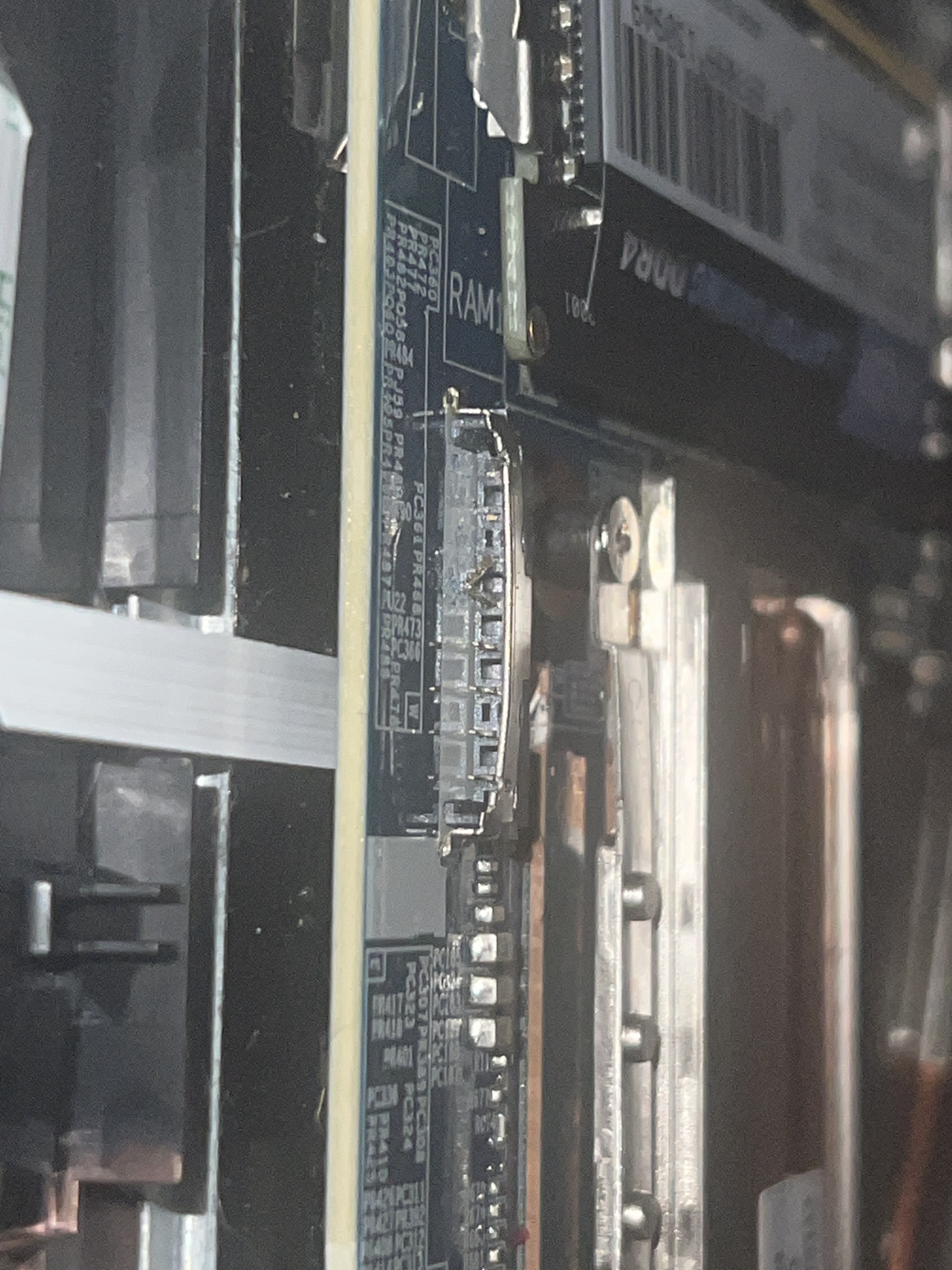

So anyways, since the connector stays snug, would it be advisable to cut a paperclip into sections and plug the connector’s holes and just fit it right in there?  Like, is that enough Amperage or would it allow too much current?

Seriously though, I’ve never seen this as a fix but it sounds feasible!!  Should I measure the battery readout or draw in windows if I do it?

That needs to be replaced, there is no ,,fixing it”.
I stuck some pins from an old MSI board into the battery connector to make the connections on one P650HS and it worked!!!
Now I have a second one charging that has two amber lights currently while powered off, but windows isn't showing the battery…. I had the battery running fine in a P650RE I believe, but hopefully it just went dead while sitting.
Does two amber lights while powered off (AC, and Battery) mean that it is charging?
I have a third battery somewhere too, but I hope its working even though its only a 180W charger for now.

Fixed the second on too!!
i should have taken pictures of the flimsy metal sticking out of the connector, all janky like, but I had other things to do.
