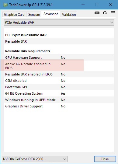

How to Verify It Worked

Method 2 — GPU-Z
Bus Interface should be stable under load with no detection drops.
