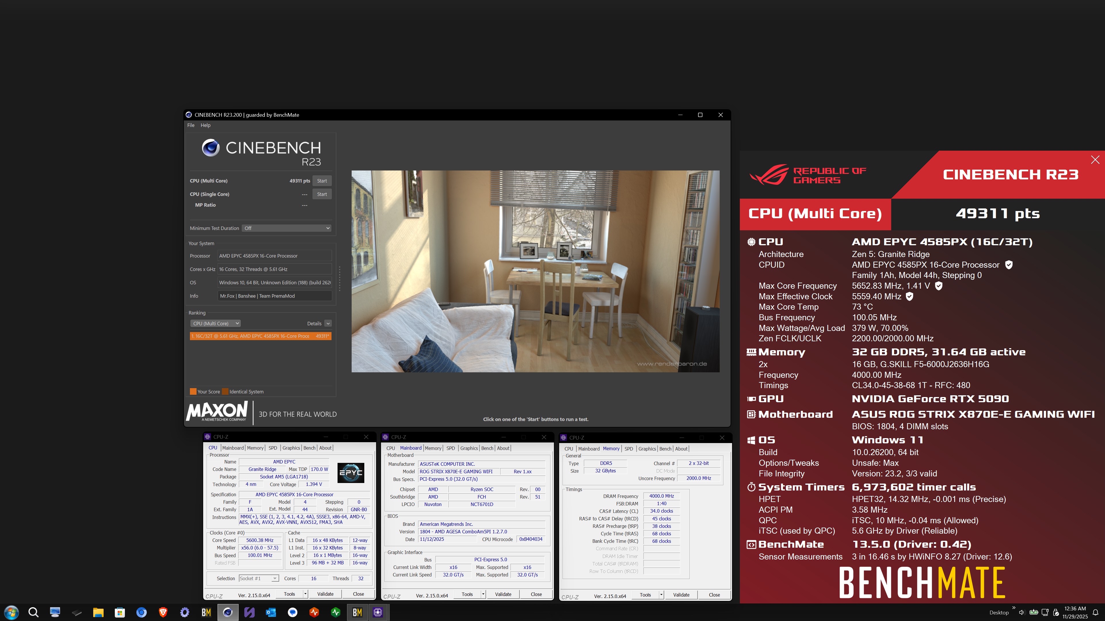

Now that the CPU is sorted, I got the RAM dialed in stable as well.

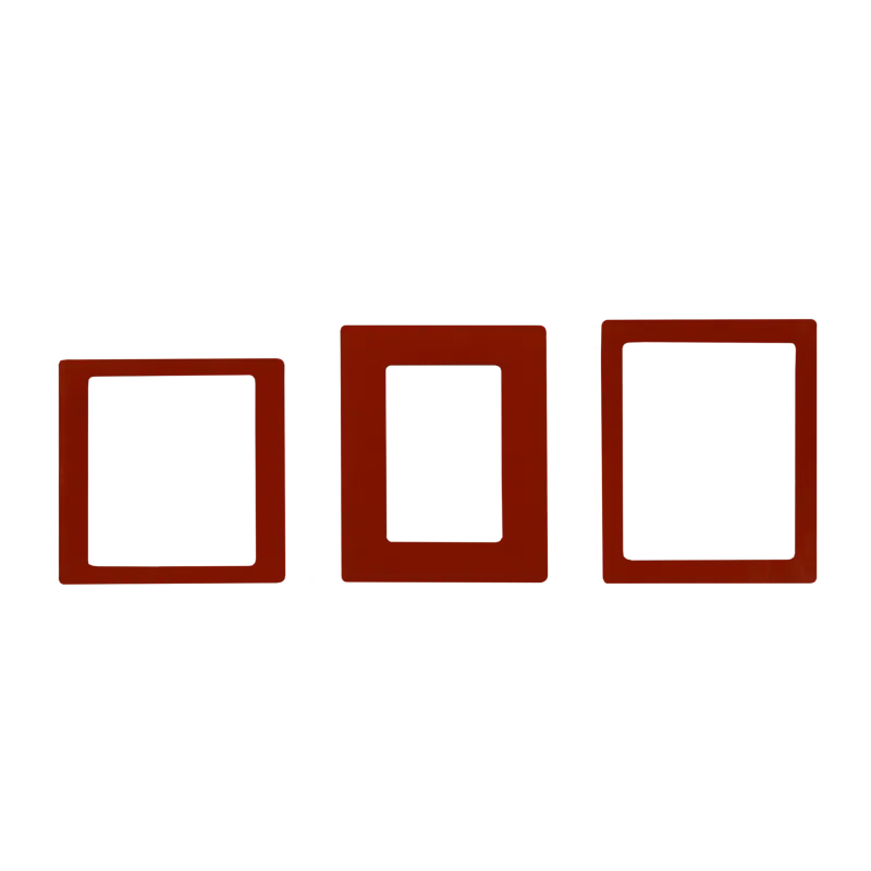

Since I have more spare time on my hands temporarily, I decided to dismantle the Thermal Grizzly Mycro direct die block and clean the jet plate fins. It wasn't too terrible, just normal accumulation from the loop during roughly a year of use. I use two filters on each PC so that helps. I've had to clean the filters a couple of times.
I ordered a set of Thermal Grizzly TG GPU Guard gaskets and will put liquid metal on the 4090 and 5090 when I can muster enough motivation to do it.
5-s-tg-gg-01-webp_800x800.webp?ts=176354
