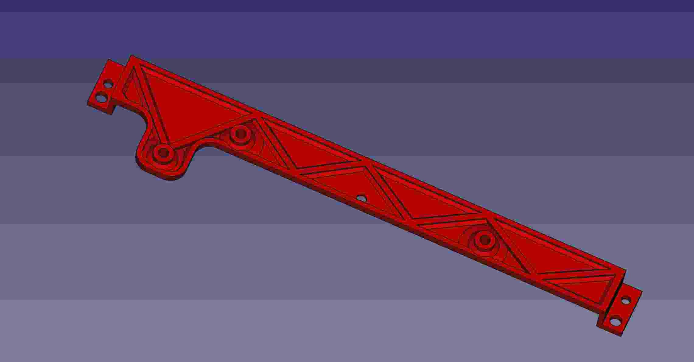

Developer79 Posted October 12, 2025 Posted October 12, 2025 Hello everyone, if anyone needs a bracket for the RTX10/20/30 in the P870DMG, I have some available! The material is steel
Developer79 Posted October 29, 2025 Posted October 29, 2025 On 2/4/2025 at 10:25 PM, JamieTheAnything said: I will be receiving a P870 with the 6700k and dual GTX 1080's and I've been wondering if anyone has been nutty enough to use dual 3080's in order to use it as a Blender rendering machine. I might go ahead and also grab a 8700k or 9700k depending on what y'all experiences with throttling in the dual GPU version of the p870. While I might sound insane I just want a portable workstation that I can do 3d/productivity work on and be on par with my current desktop setup, (5800x3d and 3090) What kind of P870xx do you have? As I said, if you want to install GTX10xx - RTX30xx in the P870DMG, I recommend using my adapter or building your own! And other MXM Cards RTX40xx/RTX50xx MXM in standard size!!! Here my last version from the adpater in stanless steel!:

Selim1905 Posted January 28 Posted January 28 On 05.12.2025 at 07:16, Developer79 said: MERHABA, İşte P870DMG için kullandığım kılıfın gerçek hali: How can I buy this
Maro97 Posted January 28 Posted January 28 4 hours ago, Selim1905 said: How can I buy this Send a personal message to @Developer79
Selim1905 Posted January 29 Posted January 29 4 hours ago, Maro97 said: Kişisel bir mesaj gönder@Developer79 Thank you 1
Developer79 Posted January 29 Posted January 29 15 hours ago, Selim1905 said: How can I buy this That's my development, and there's more! 🙂 Maro gave you tips... Greetz.. 1
