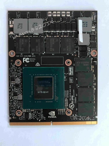

Sebastian Ramirez Posted April 8, 2025 Posted April 8, 2025 Hi everyone, I plan to buy the GTX1070 in the picture for my Alienware 18. Just some questions, thanks! 1. Will the laptop motherboard have enough power for the 1070? I plan to install it and use it forever 2. The steps are like this, correct?, -Unlock bios for SG mode -Switch to SG mode, -Install the GTX1070 -Install modded driver and then I'm done, correct? 3. Do I need an AMD100W heatsink ? 4. Do I need thermal pads as well? 5. Will the GTX1070 last after doing everything properly? Thanks for help!
sliderfra Posted April 13, 2025 Posted April 13, 2025 hi, that's the plan yes! You don't necessarily need the AMD 100W. Nvidia HS will do just fine as the gecube 1070 has "low" TDP. Thermal pads are mandatory on RAM & VRMs. Be sure that proper contact is made with heatsink as VRM heat up A LOT! If you do everything by the books and don't overclock TDP (do not use MSI 150W vbios on this card, it will burn quickly), you should be ok for a few years.
Sebastian Ramirez Posted April 15, 2025 Author Posted April 15, 2025 but by the way, if I do everything right, shouldn't the 18 and the 1070 last forever? (Keeping replacing thermal paste and pads when required)
sliderfra Posted April 16, 2025 Posted April 16, 2025 unfortunately you never know with GPU. Especially with lower quality chinese boards. MSI mxm (1060 / 1070) are much better (better power rails & many more VRMs) but if you cool the card nicely (RAM & VRM are prevailing) and don't overvolt (or increase TDP) it should last long With PASCAL cards, you can edit frequency/voltage curve with MSI Afterburner: you can reduce voltage to 0.85V and push 1800Mhz easily on Core. That way card stays super cool (<60° on full load) and lasts longer in the end.
