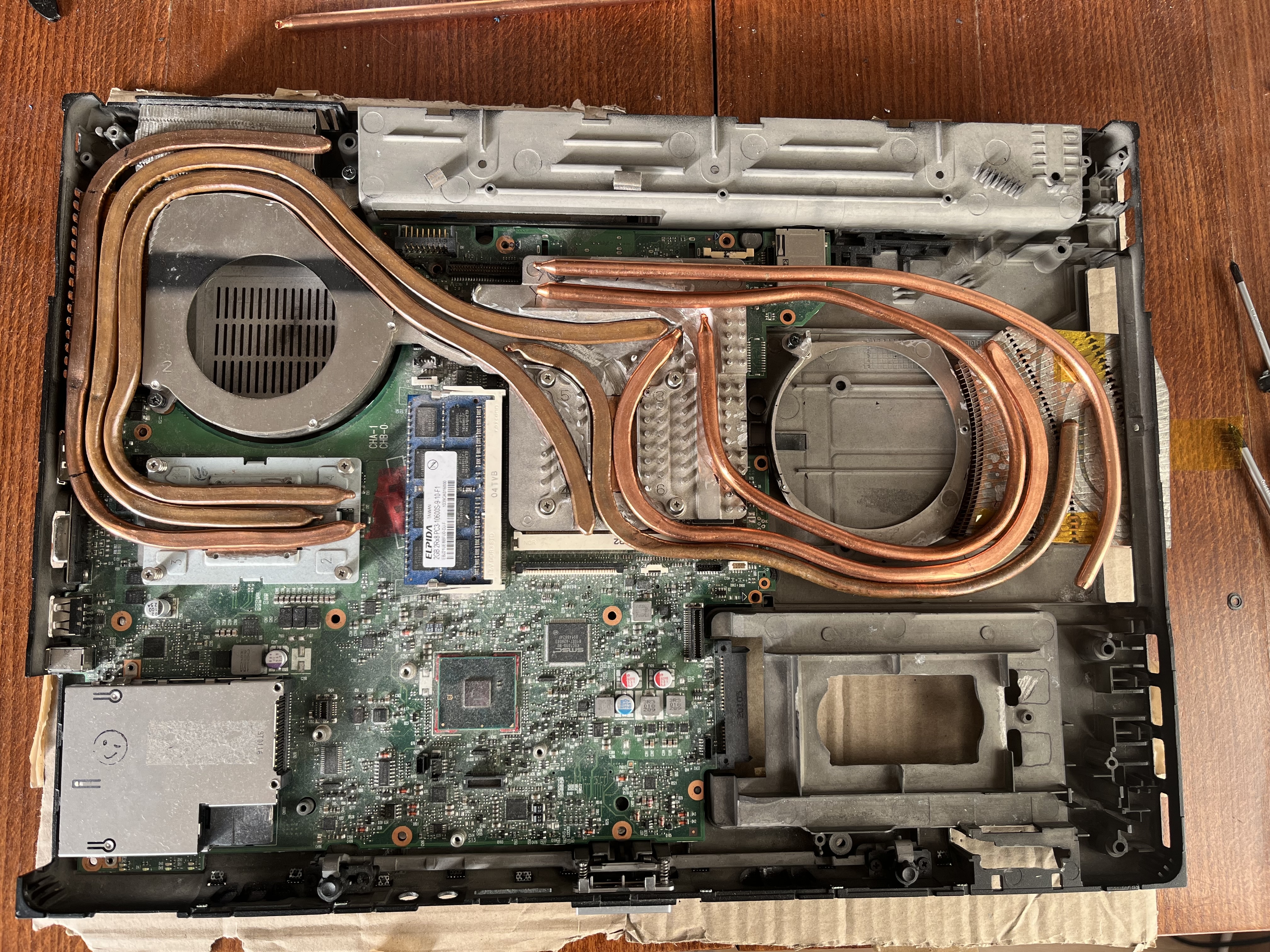

Well, it’s in desktop mode, so to say. Haven’t put it together since the 1070 was installed. Now I’m working on making it a laptop again. Here are a couple of pictures and a bonus one of how I “desoldered” the resistor.
https://imgur.com/a/bKX9tSW

Saw the pics that's some modding!
Rip to that doner motherboard, killed for a 10 cents component ☠️
Tbh, even just a wire shorting out the resistor would have been enough.
So 1070 goes in after 980m?
And do you have ideas for the cooling mod? You'll prob need to solder more heat pipes + you can add a fan in the ODD bay as you are using the sata port with a very compact msata port, smart.
Couldn’t find the same nearby and already wasted an hour trying to desolder it with heatgun or the soldering iron with no success, so I was like what the heck.
No. It was there for a few years driving the external monitor, hence the desktop setup.
Should be something like this, but still working on it.

I’ve made a cooling that, at least by initial testing, can cool the extra Watts 🙂
