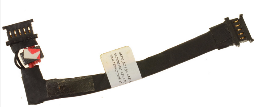

There is also a black power cable that connects from the motherboard to the GPU.  At least on the Precision 7540, the RTX 4000/5000 cable is longer than the RTX 3000 cable, but I was able to make the old cable work by gently straightening the bends.
Other than possibly the power cable, a new heatsink is the only requirement to make the RTX 5000 work.

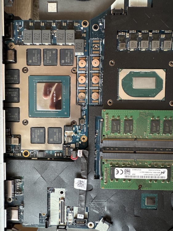

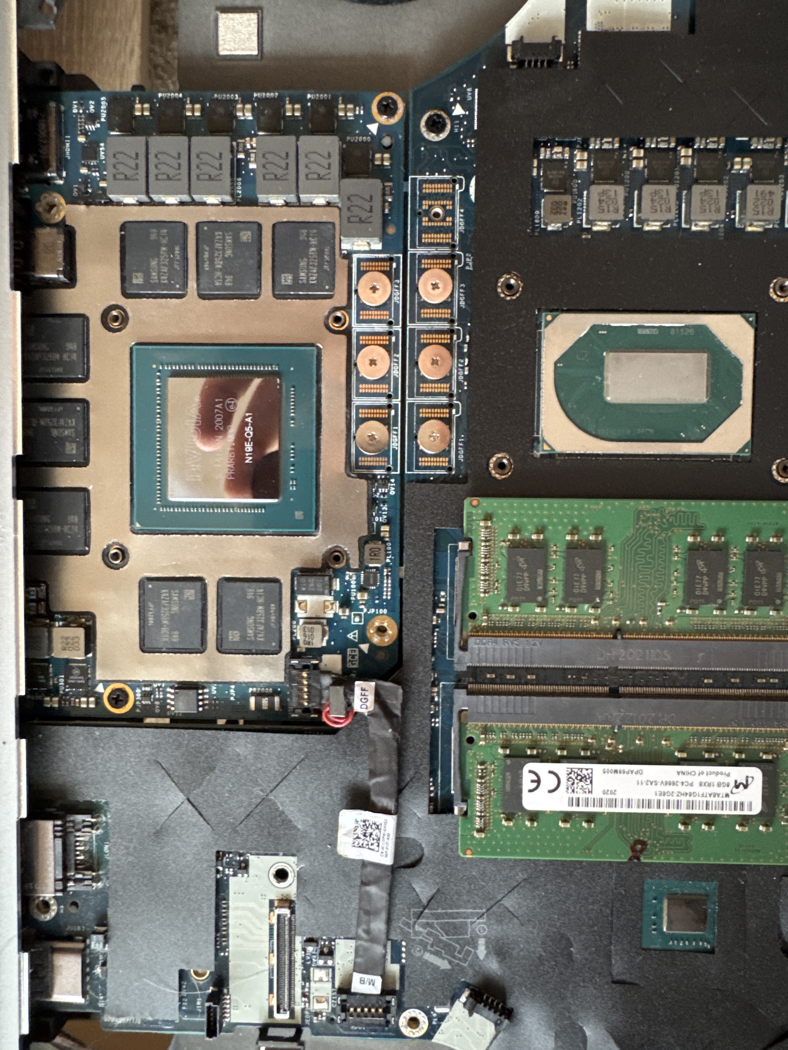

Oh wow! That was quick! Thank you for the reply.
The Heatsinkholes do align, so I hopefully should be good there. I also wouldn’t what kind of different heatsink they would put in there, since thats pretty much all the room there is😅 regarding the display cable, I do see your point now… since the Display isn’t even directly connected to the GPU… I don’t know why someone would recommend that…

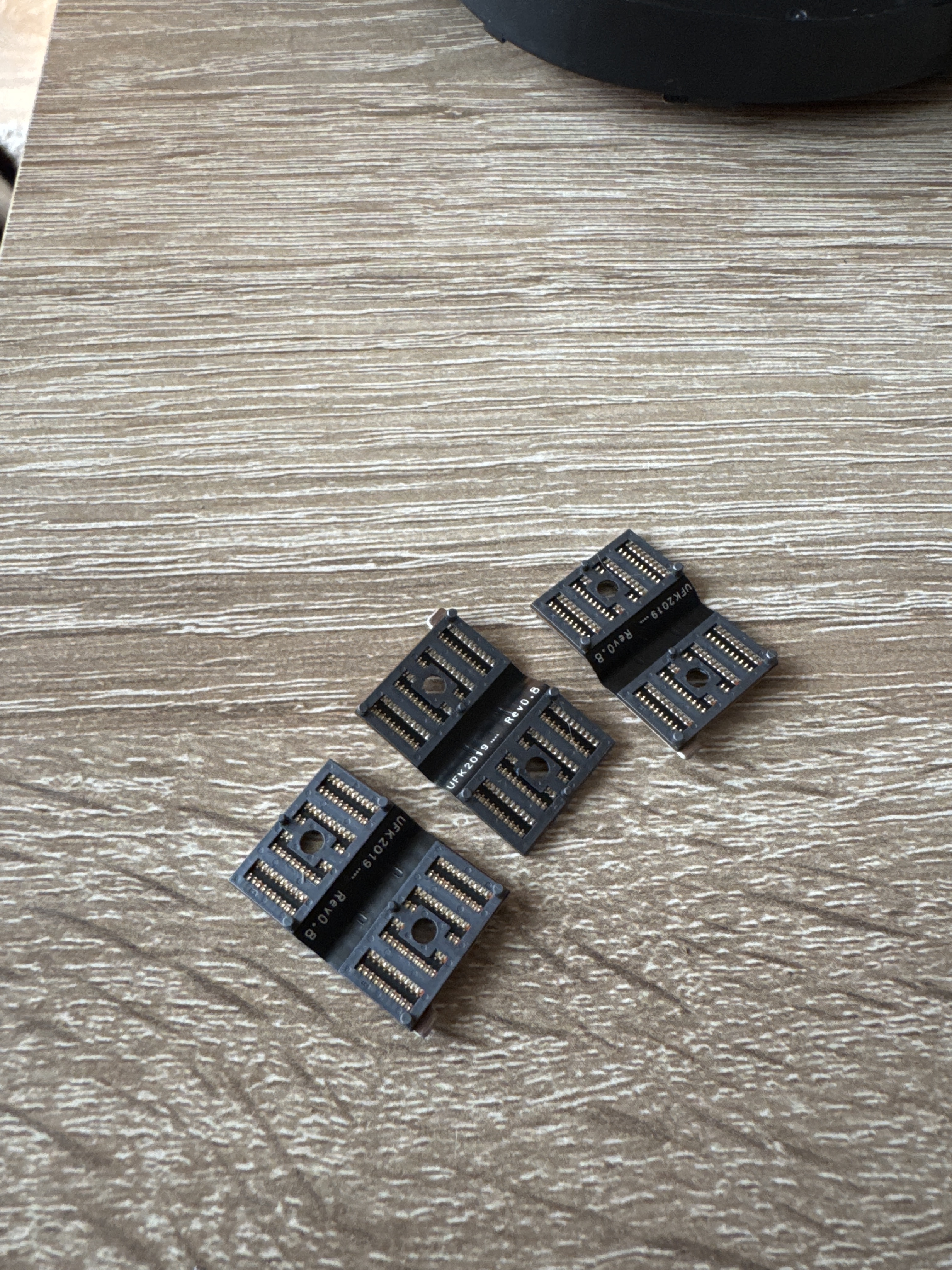

can you tell me tho if I actually need to replace 3 connectors (picture below) or if they are universal?

The powercable actually fits lengthwise, and the heatsink fits as well… do have a partnumber for the heatsink you‘re talking about?
Those three connectors are the DGFF connectors; they are universal (They carry the PCI Express connection, and I think one is dedicated to power)

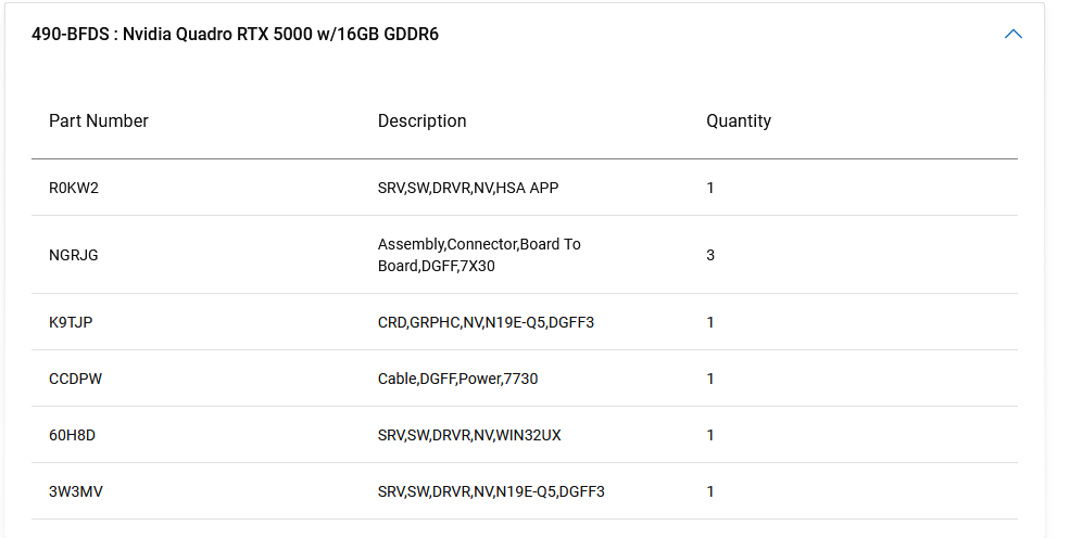

Here is the heatsink part number for my 7740 with RTX 5000:
Here are all of the other part numbers associated with the graphics card:

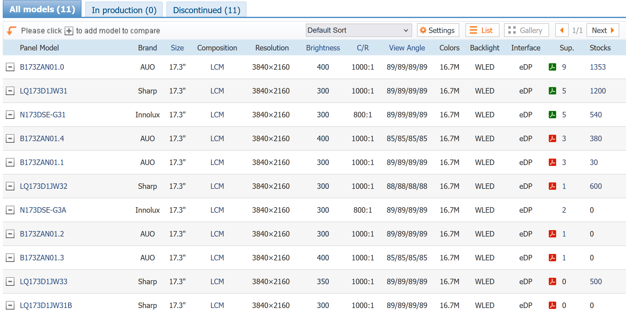

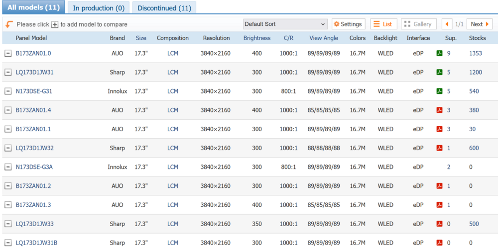

UHD Screen:  Dell Part # CK7T7.  Below is a list of compatible UHD screen models:
What website is that?🤔
Yea, that makes sense, the IR-Webcam seems considerably larger than the other one… but all that can wait😅 I‘m just glad I‘ll have it up and running tomorrow, once the pads arrive!
thank you all for the help so far!
www.panelook.com
Screen options are limited for the Precision 7740 screen mounting style (Face U/D Lock on Slug).  There are 1920x1080 144 Hz screens that also use a 40 pin connection; most of the other resolution/frequency options are TN instead of IPS
