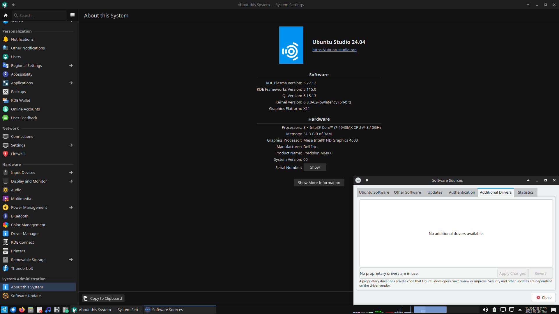

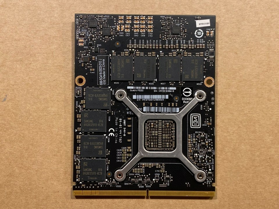

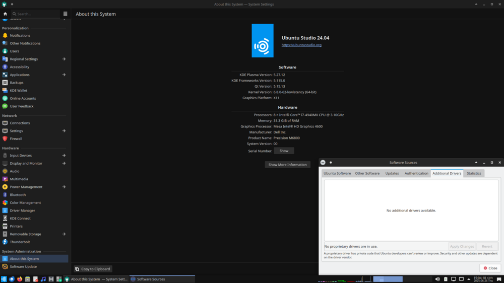

I ended up getting a Quadro P5000.  The hardware swap went well enough...though I do recommend a dremel over a scroll saw.  I thought the saw would make bigger chips that are easier to clean up, but it didn't, and it insisted on clapping against the table, so I finished with the dremel.
Anyway, I don't see the new card at all, and the DVI outputs on the dock are dead.  The VGA output on the dock still works, as do the built-in screen and USB adapter.  Any ideas?

Operating System: Ubuntu Studio 24.04
KDE Plasma Version: 5.27.12
KDE Frameworks Version: 5.115.0
Qt Version: 5.15.13
Kernel Version: 6.8.0-62-lowlatency (64-bit)
Graphics Platform: X11
Processors: 8 × Intel® Core™ i7-4940MX CPU @ 3.10GHz
Memory: 31.3 GiB of RAM
Graphics Processor: Mesa Intel® HD Graphics 4600
Manufacturer: Dell Inc.
Product Name: Precision M6800
System Version: 00

After user DynamiteZerg got P5000 working in a Precision M6800, I bought a P5000 myself for my Precision M6700. I wanted to use it with Windows which meant that it needed a vBIOS flash with the "engineering sample" vBIOS. The Precision M6700 would not boot into Linux in order for me to do that, so I bought a used Precision M6800, put the card in there, performed the flash under Linux with no problem, and then moved the card to my M6700 and sold the M6800.
From what I recall, the card was recognized by nvflash with no issue. That's the only thing that I tried to use it with under Linux.
I guess the first thing that I'd ask is if nvflash can see the card. If so, you could flash a different vBIOS on it and maybe that will have some better success.
Actually, the card should have a sticker on it somewhere which includes the vBIOS version. Can you see that? What does it say?
If you go to BIOS setup, there is a screen with system information. It should report what GPU is installed. It will say something like "unknown GPU", but it shouldn't say that there is no discrete GPU at all.
I don't think the "engineering sample" vBIOS is required to use the GPU under Linux. It's just required to get around an ACPI BSOD that occurs if you try to boot Windows. User @jeamn was able to use a GeForce 1070 under Linux which had the same ACPI BSOD issue with Windows on the Precision M6800.

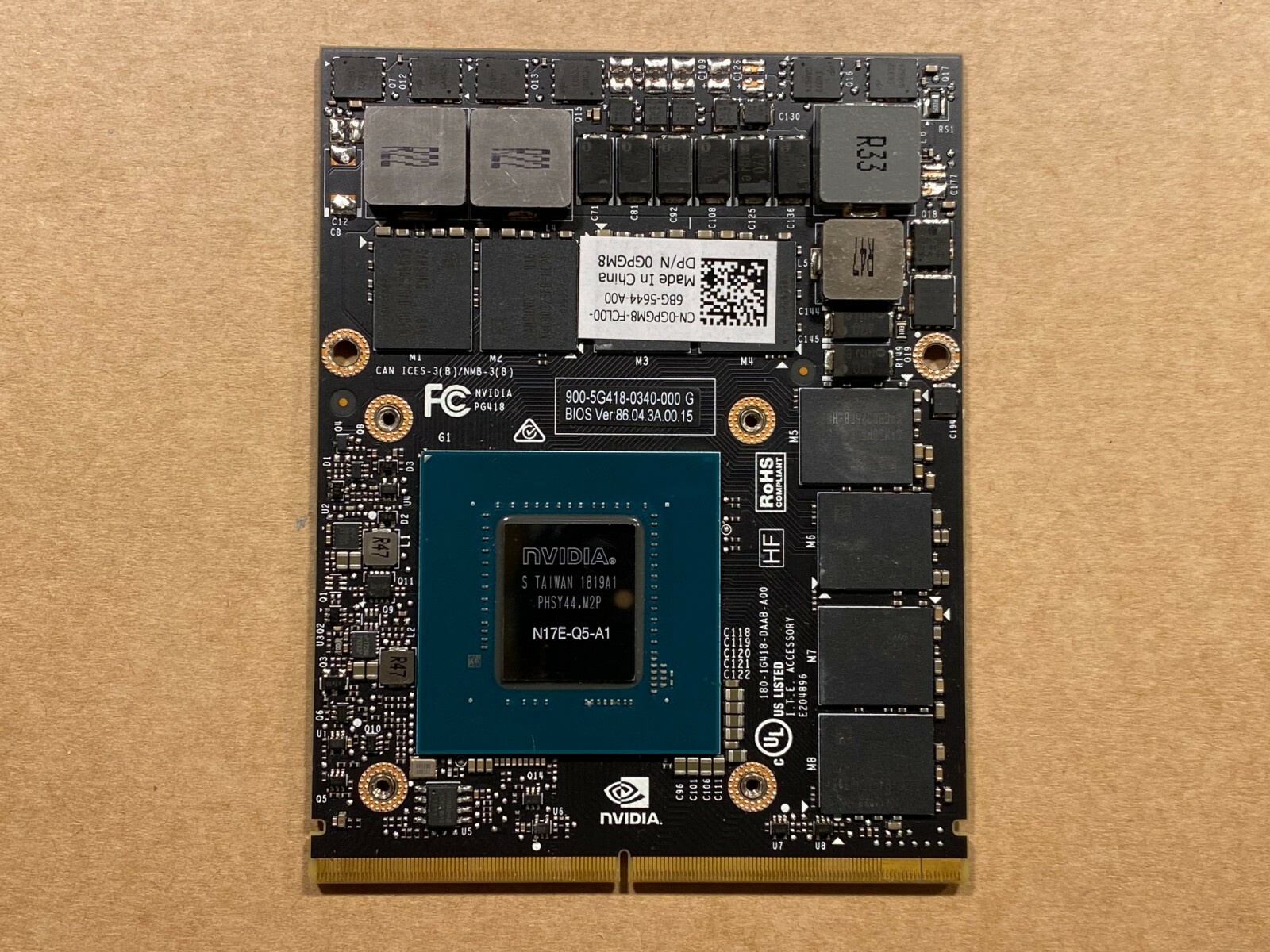

I'm not too eager to get it back out again if I don't have to, but here's some pictures from the seller's listing:
If I'm reading the right thing, it's BIOS Ver:86.04.3A.00.15
Link to comment
Share on other sites
Hmm. When I got my P5000, the vBIOS was 86.04.3A.00.25. The engineering sample vBIOS is 86.04.2E.00.0D. The M6800 was able to see the P5000 card with both of these installed. I'm attaching both of these here... but if nvflash can't see the GPU, the only way to flash them will be with a hardware flasher.
Not that I really think this is a vBIOS issue, it is really weird for the GPU to not be showing up at all. I'm wondering if it is just a bad card.
P5000-86.04.2E.00.0D.zip P5000-86.04.3A.00.25.zip

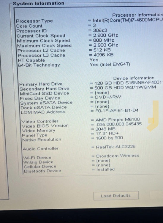

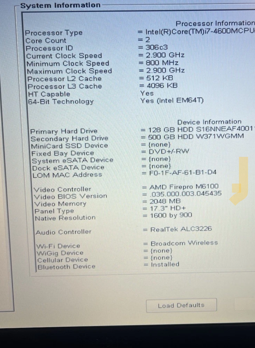

In the system BIOS, there is a section for the video controller, is it listed there?  If not, it's a bad card or it's not inserted properly.  The section should look something like this:
Link to comment
I swapped back, with pictures of that BIOS page both ways.  Neither card appears there:
P5000:
K5100:
But the DVI outputs are back, with the original K5100, and nvflash sees it:

And since it's out now, here's my own picture of the P5000:
So the seller did send me what the listing was for.  Anything else to try before I accuse him of selling me a dud card?
(I checked the white spot on the edge connector after I took the picture.  It's not there now, so it's probably a reflection.)
Link to comment
OK, I had forgotten that in order for your dGPU information to show on that BIOS information page, you need to have graphics switching turned off so that it is the "default" GPU driving the display. ...That would be a little "dangerous" to do on your P5000 if it is "not working" (...the BIOS might actually take the option to disable graphics switching away if it does not detect a compatible dGPU anyway).
If you do end up in a situation where graphics switching is disabled and you can't "see" anything due to a non-functional dGPU, you can reset the BIOS settings by unplugging the coin cell battery for a few moments. The default config has graphics switching enabled.
Anyway. Tangentially related but I spotted this note this morning. NVIDIA is dropping support for both Maxwell and Pascal at the same time. (A surprise to me since they normally just drop one generation at a time, but... on the flip side, Maxwell has already been supported for an abnormally long time.) The 580 driver series will be the last to support either. So even if you get the P5000 to work, you'll end up in a similar situation with regard to driver support before too long.
https://forums.developer.nvidia.com/t/unix-graphics-feature-deprecation-schedule/60588/13
(Sorry, I don't have any additional ideas on how to kick the GPU into working.)

Finally got back to this again.  I had some things I needed it to work for, so I wasn't going to risk breaking it by taking it apart and missing something right in front of an important job.
Anyway:
  • With the original K5100 in there, and switchable graphics disabled, the BIOS can see it just fine.
  • With the P5000, it power cycles a few times with a black screen, and by the time it shows a logo and allows the menu entry, it has automatically re-enabled switchable graphics and can't see it.
