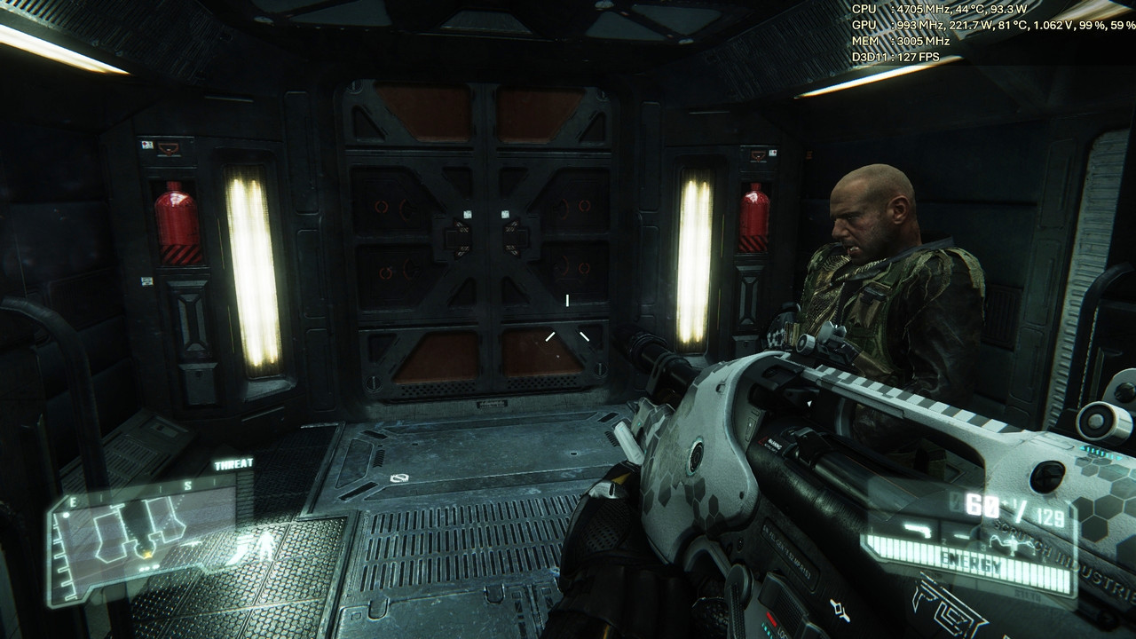

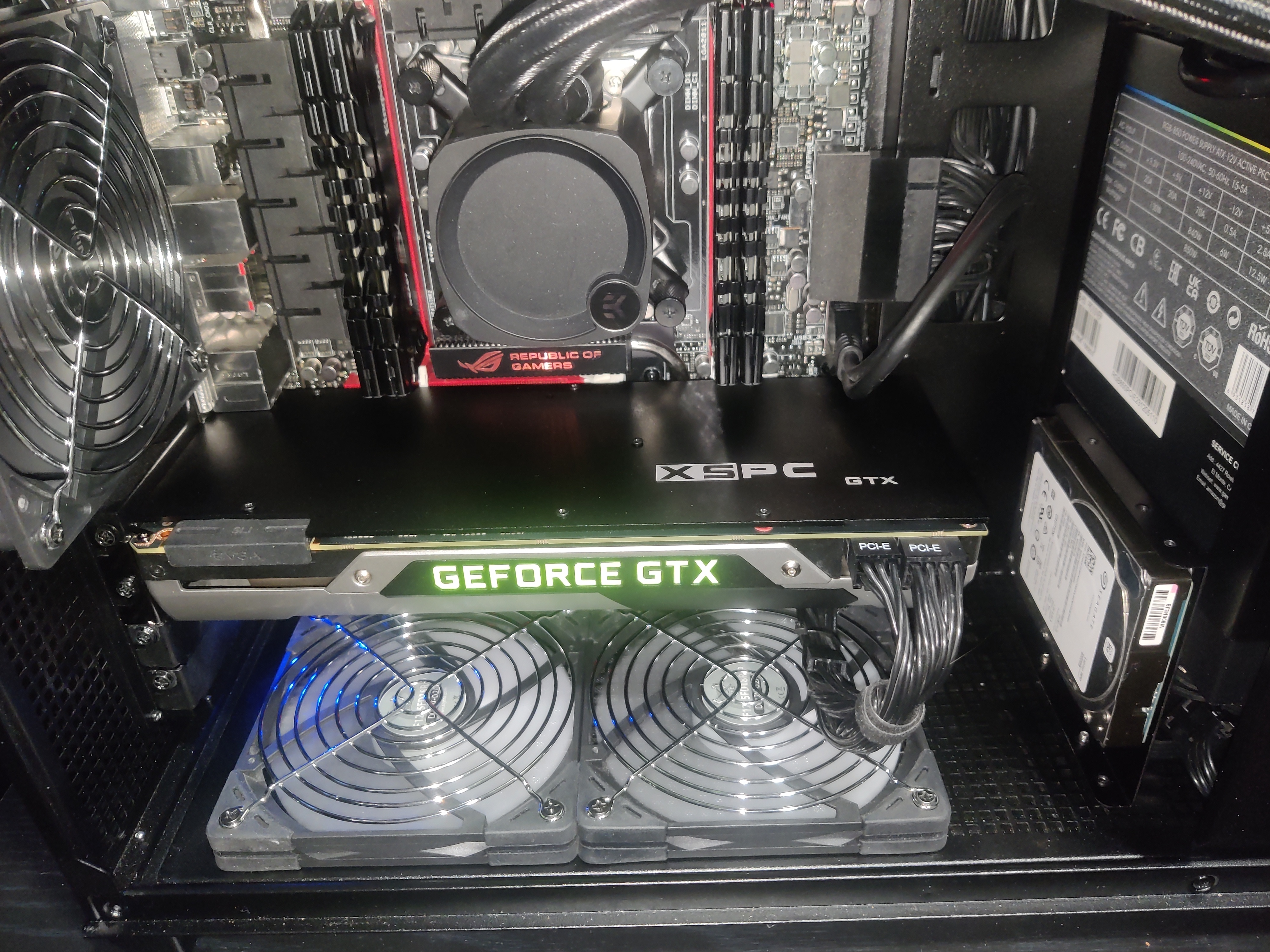

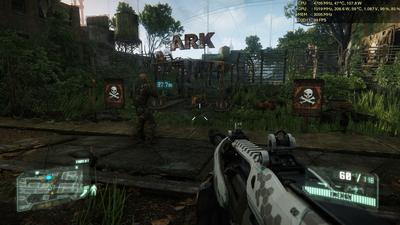

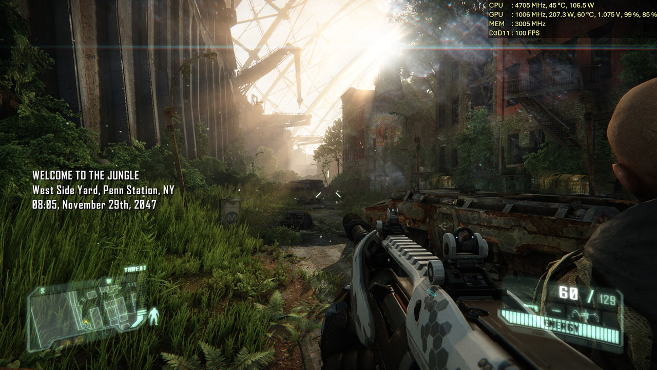

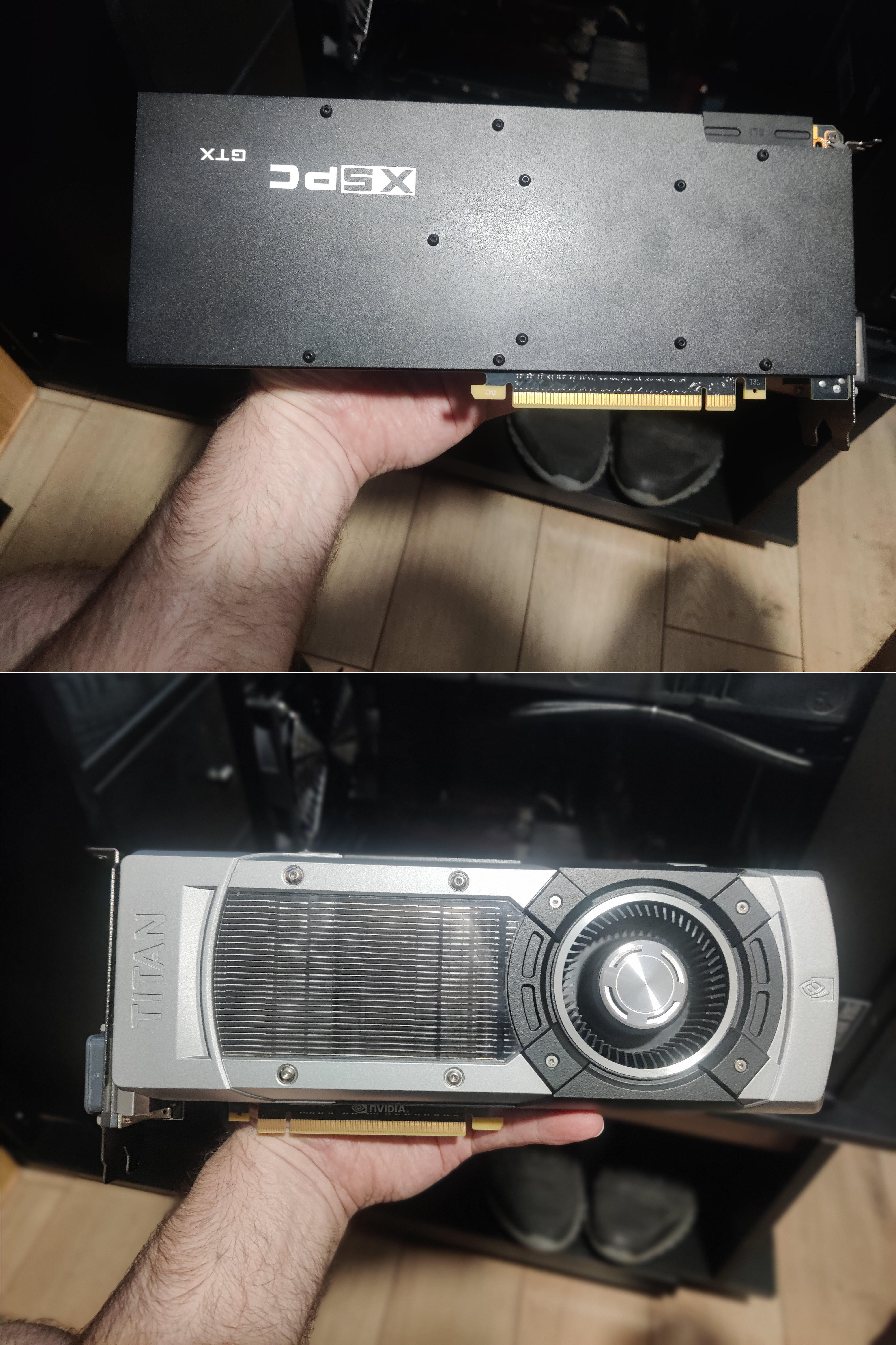

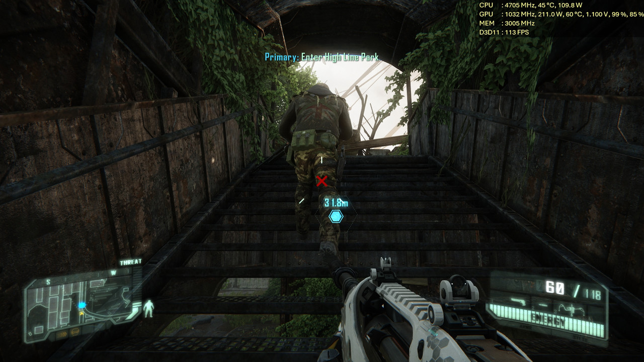

Crysis 3 Remasered - GtX Titan 1080p with medium settings...
Crysis3-Remastered-2024-07-28-19-43-23-3
Crysis3-Remastered-2024-07-28-19-48-31-6
Crysis3-Remastered-2024-07-28-19-49-17-6
Crysis3-Remastered-2024-07-28-19-50-54-7

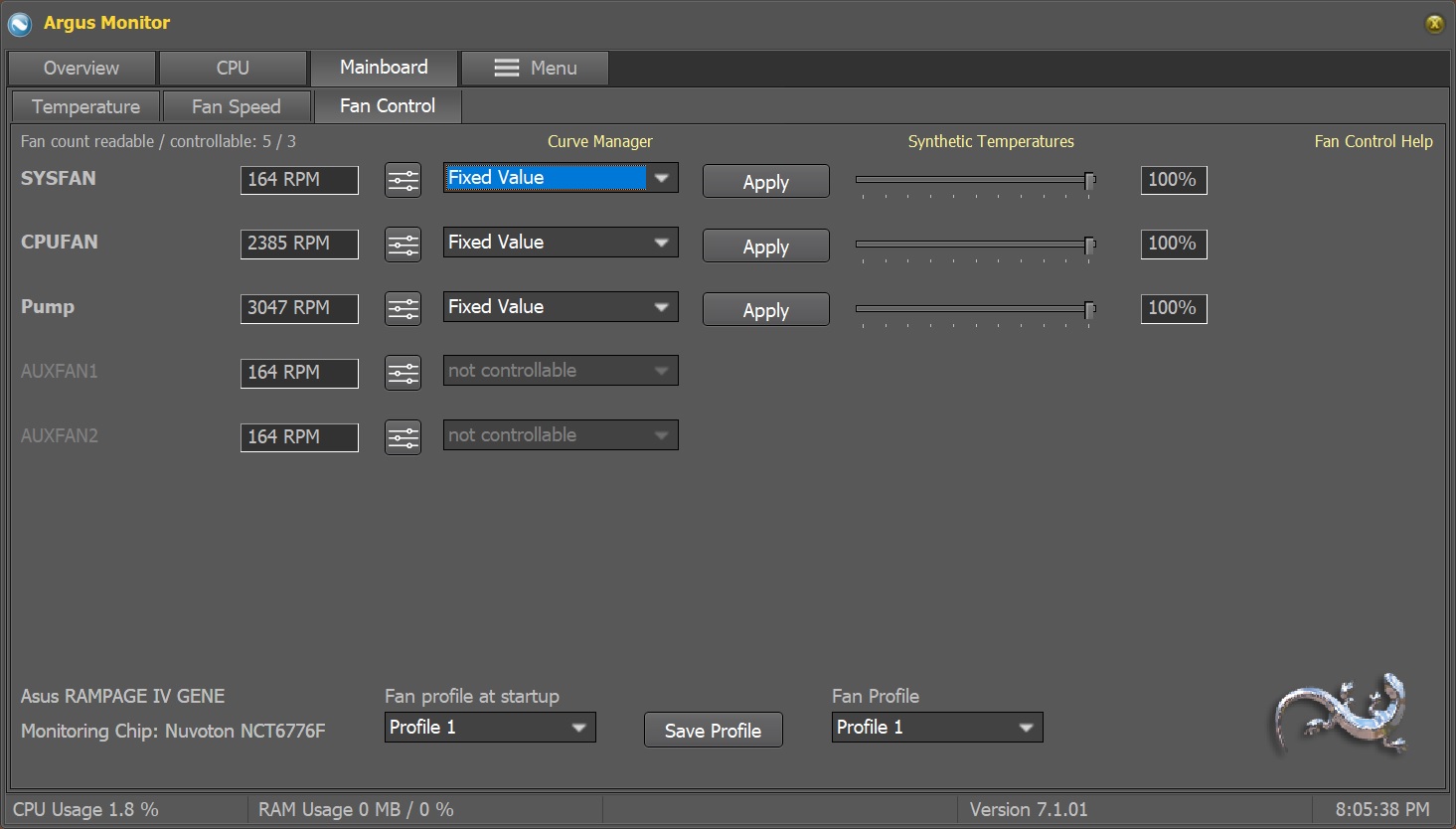

I forgot to share this. Others may find it useful.
The Rampage IV Gene BIOS fan controls are poor (very limited) compared to newer ASUS motherboards. I found this application for manually controlling the AIO pump and fans on the Gene. It works fantastic. And, it is inexpensive. You can try the free version before buying. The default configuration is annoying because it has system tray icons (like Core Temp does) showing values for monitored sensors After fussing with the settings to turn them off and configuring he option to minimize to tray I am very pleased with it. I suspect it will work for most systems, including laptops.
I turned off everything except the fan controls. I don't need the monitoring for everything because I use HWiNFO64 for that.
https://www.argusmonitor.com/
