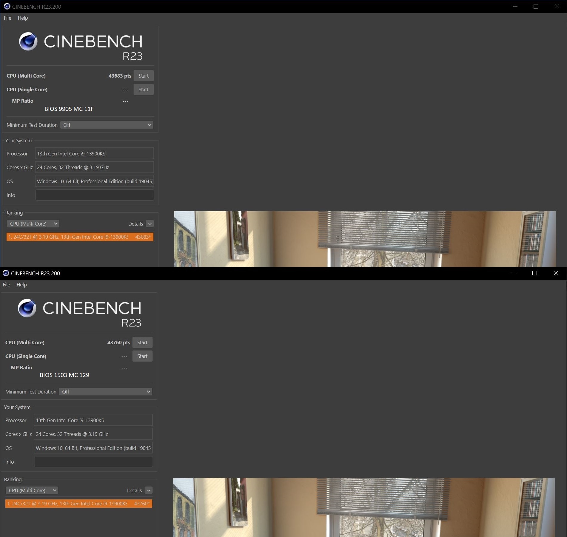

Mr. Fox Posted August 9, 2024 Author Share Posted August 9, 2024 13 hours ago, Prema said: In case anyone needs it, I've created a simple Windows microcode updater for v129. Works on all 13th & 14th gen Intel systems (Desktop and Notebook) without having to update your BIOS: https://www.reddit.com/r/eluktronics/s/wvXIQYgjoS 10 hours ago, Mr. Fox said: Nice to see you brother. Hope all is well with you. So this microcode update can flash only the microcode without the ME if you want to omit the ME update? If that's the case, then I won't update any of my BIOS on any my four desktops. I will just test the microcode on one of them first before deciding whether or not to apply it to the other three. Not need to reply. I checked it out and see it is two separate downloads. That's great. Question: Does this change MC in Windows only? I flashed it, rebooted. BIOS still doesn't show 129. It shows whatever very is set. I use 11F, but there is a menu with other versions available. 129 is not in the list. But, when Windows loads AIDA64 shows 129. Edit 7 hours ago, Mr. Fox said: Question: Does this change MC in Windows only? I flashed it, rebooted. BIOS still doesn't show 129. It shows whatever very is set. I use 11F, but there is a menu with other versions available. 129 is not in the list. But, when Windows loads AIDA64 shows 129. Answered my own question. Booting into another OS on the same system AIDA64 shows 11F, so it does appear to apply 129 to the OS only. After applying the MC update in Windows it seems nothing is visibly different. Power draw, voltage, watts, amps... all exactly the same values in a Cinebench run. 7 hours ago, Talon said: Personally don't trust TimeSpy CPU test at all on Windows 11. It's bugged AF for me. I get weird run to run variations in the CPU test. Sometimes a reboot completely fixes it. I'm convinced it's some sort of scheduling issue. That said, in normal TimeSpy CPU test I just ran with 0129, scored same as I did previously at 26.5K CPU with same power settings/tune as old microcode. So I don't trust his results personally. Micro$lop doesn't charge extra for Winduhz 11 being a sucky piece of crap. It is a free service they are happy to provide. 4 1 WRAITH // X870E Apex | 9950X | 5090 Solid OC | 32GB DDR5-8000 | GF3 1650W | Triple 360 Loop | Hailea HC-500A || O11D XL EVO (T-Rex) BANSHEE // X870E-E Strix | 9950X | 4090 Suprim | 48GB DDR5-8000 | Edge 1300W | Dual 360 Loop || O11D XL EVO (Rhinoceros) MEH!! // Precision 7720 | BGA CPU Filth | MXM Quadro P5000 16GB | 32GB DDR4 | 4K IPS Display | $500 Turdbook (Sea Turtle) Mr. Fox YouTube Channel | Mr. Fox @ HWBOT The average response time for a 911 call is 10 minutes. The response time of a .357 is 1400 feet per second. Link to comment Share on other sites More sharing options...
tps3443 Posted August 9, 2024 Share Posted August 9, 2024 1 hour ago, Talon said: Personally don't trust TimeSpy CPU test at all on Windows 11. It's bugged AF for me. I get weird run to run variations in the CPU test. Sometimes a reboot completely fixes it. I'm convinced it's some sort of scheduling issue. That said, in normal TimeSpy CPU test I just ran with 0129, scored same as I did previously at 26.5K CPU with same power settings/tune as old microcode. So I don't trust his results personally. Yeah, and using Windows balanced power mode has shown higher numbers for me in this TS cpu test. 🤷♂️ One more thing, Timespy physics score is very sensitive to stability as well. If your CPU isn’t getting fed enough juice, or is not completely stable, I have seen it score lower. I remember spending an entire day running just TS cpu test and trying different thing. Just another one of those weird things with Win11 I guess. 2 13900KF Link to comment Share on other sites More sharing options...
Mr. Fox Posted August 9, 2024 Author Share Posted August 9, 2024 14 hours ago, Mr. Fox said: Cinebench scores are the same? 14 hours ago, Talon said: Honestly identical to my 11F microcode BIOS in CB23 with same power/current/undervolt. But of course 11F comes with the voltage issues. Same and confirmed. All the same settings as before. No change in performance, voltage or thermals. Can't tell any difference at all. Now I question if there actually is any. Seems there is nothing whatsoever, but may be because of how I manually overclock almost everything and remove all limits. I will check to see if it affects the SA bug now on the CPU that has it. MSI has not released this for the Z790i Edge WiFi motherboard yet. So, I can't check for an SA bug fix using the Edge mobo until they do. 3 WRAITH // X870E Apex | 9950X | 5090 Solid OC | 32GB DDR5-8000 | GF3 1650W | Triple 360 Loop | Hailea HC-500A || O11D XL EVO (T-Rex) BANSHEE // X870E-E Strix | 9950X | 4090 Suprim | 48GB DDR5-8000 | Edge 1300W | Dual 360 Loop || O11D XL EVO (Rhinoceros) MEH!! // Precision 7720 | BGA CPU Filth | MXM Quadro P5000 16GB | 32GB DDR4 | 4K IPS Display | $500 Turdbook (Sea Turtle) Mr. Fox YouTube Channel | Mr. Fox @ HWBOT The average response time for a 911 call is 10 minutes. The response time of a .357 is 1400 feet per second. Link to comment Share on other sites More sharing options...
