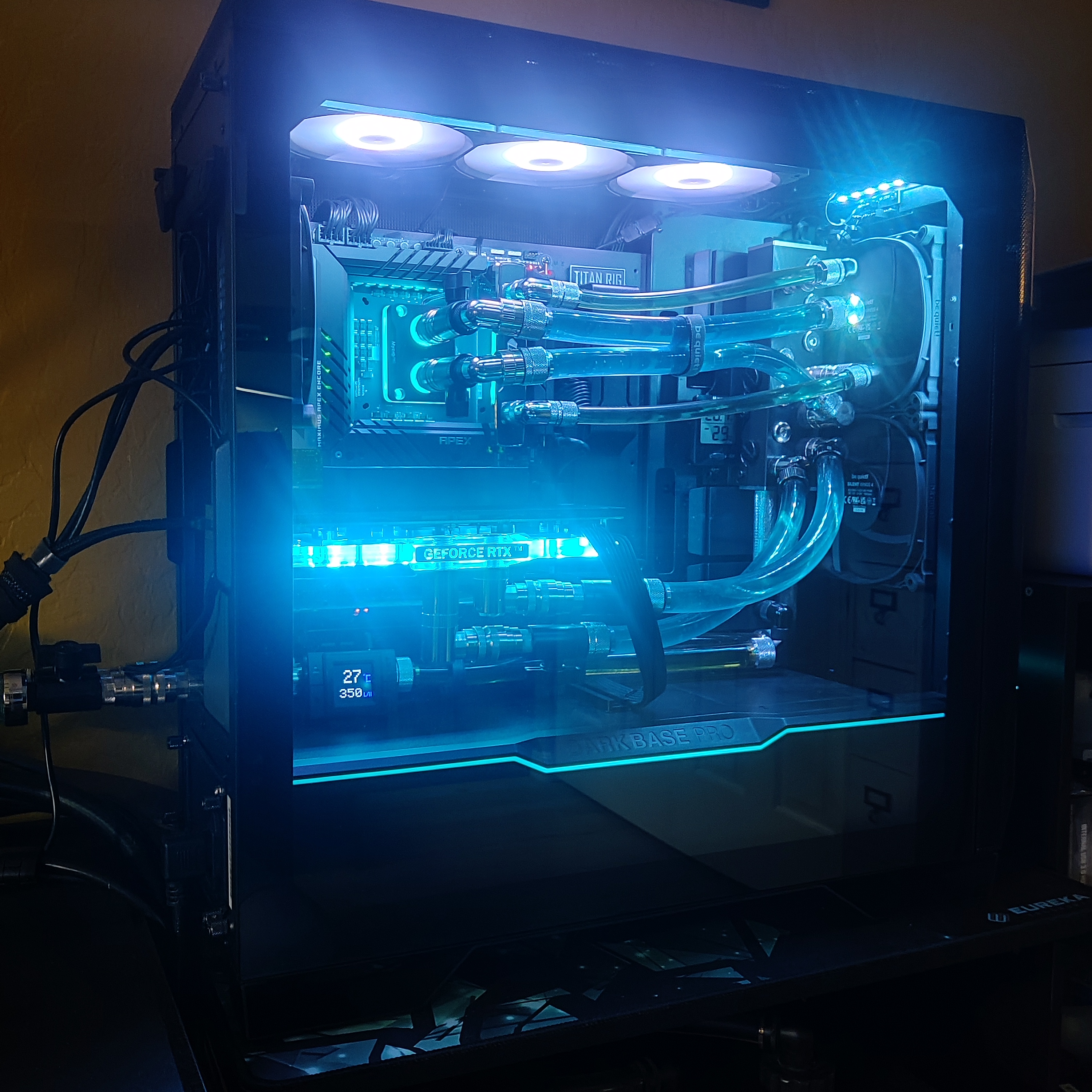

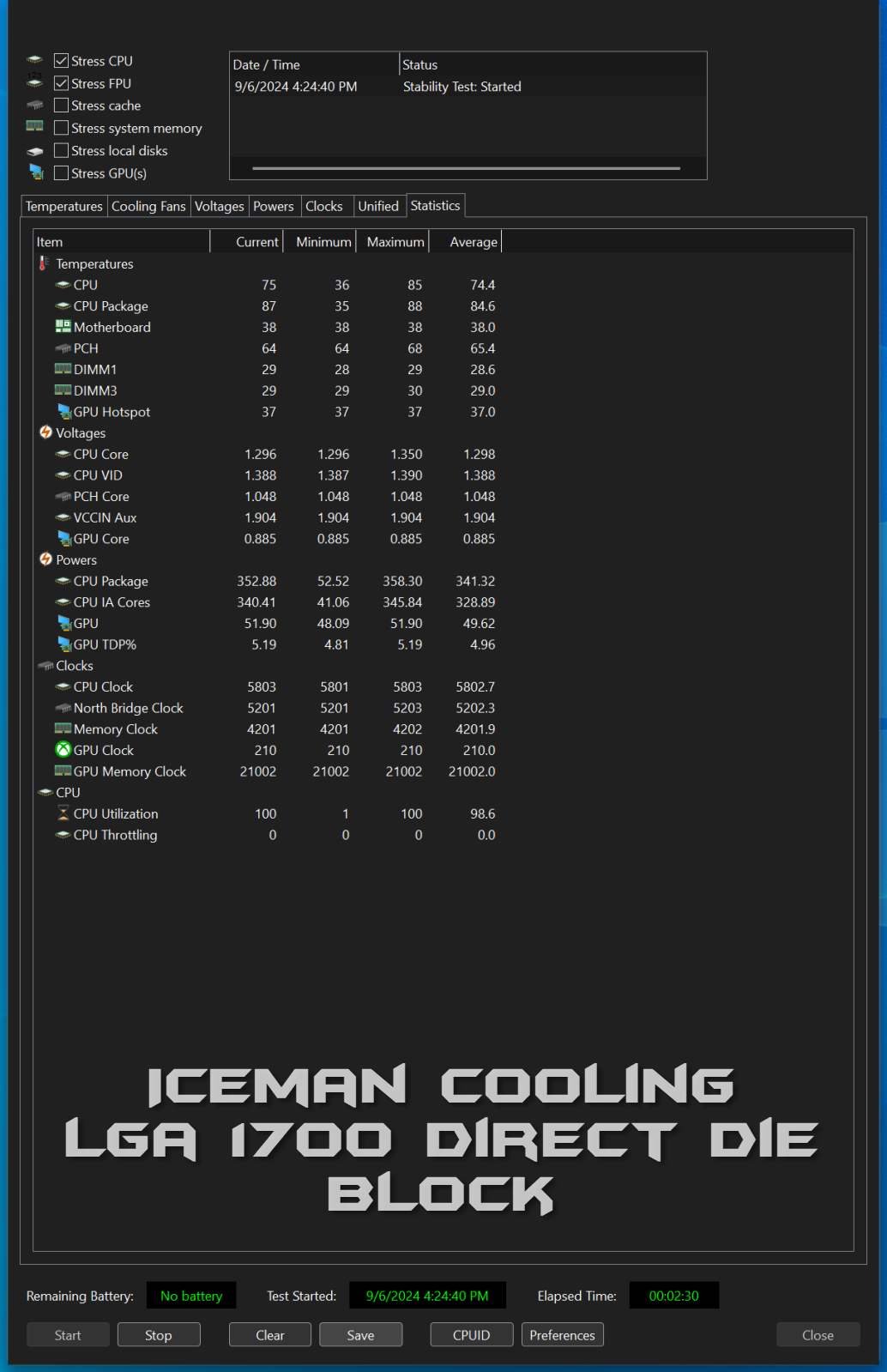

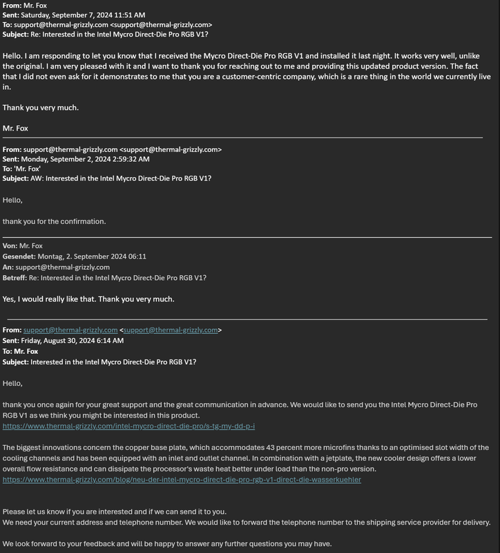

I have to put in a plug for Thermal Grizzly. I purchased the Mycro LGA-1700 Direct Die block and it performed poorly compared to the IceMan Cooling block. I emailed them and asked for an RMA, provided the before/after temperature comparisons. They did not do an RMA, just apologized and issued a refund.
Fast forward a few months, they contacted me, totally out of the blue, and offered to send me the updated product. I didn't ask for it. I replied and accepted and they sent it. Works great. Essentially the same thermal performance as the IceMan block. I like the design of the cold plate better. It has a rim around the die to contact the PCB, which adds support and spreads out the compression of the PCB into the socket instead of the die being the only point of contact. And, it makes a dam to keep the liquid metal confined to the die area.
These results are without the chiller, in my hot (79°F) office.
More extended stress test...
Whoa, that is very good on TG's part! Is this the same block De8auer has been posting about on the OCN forums and getting it updated and working properly and basically laying the groundwork for Socket 1851 ?

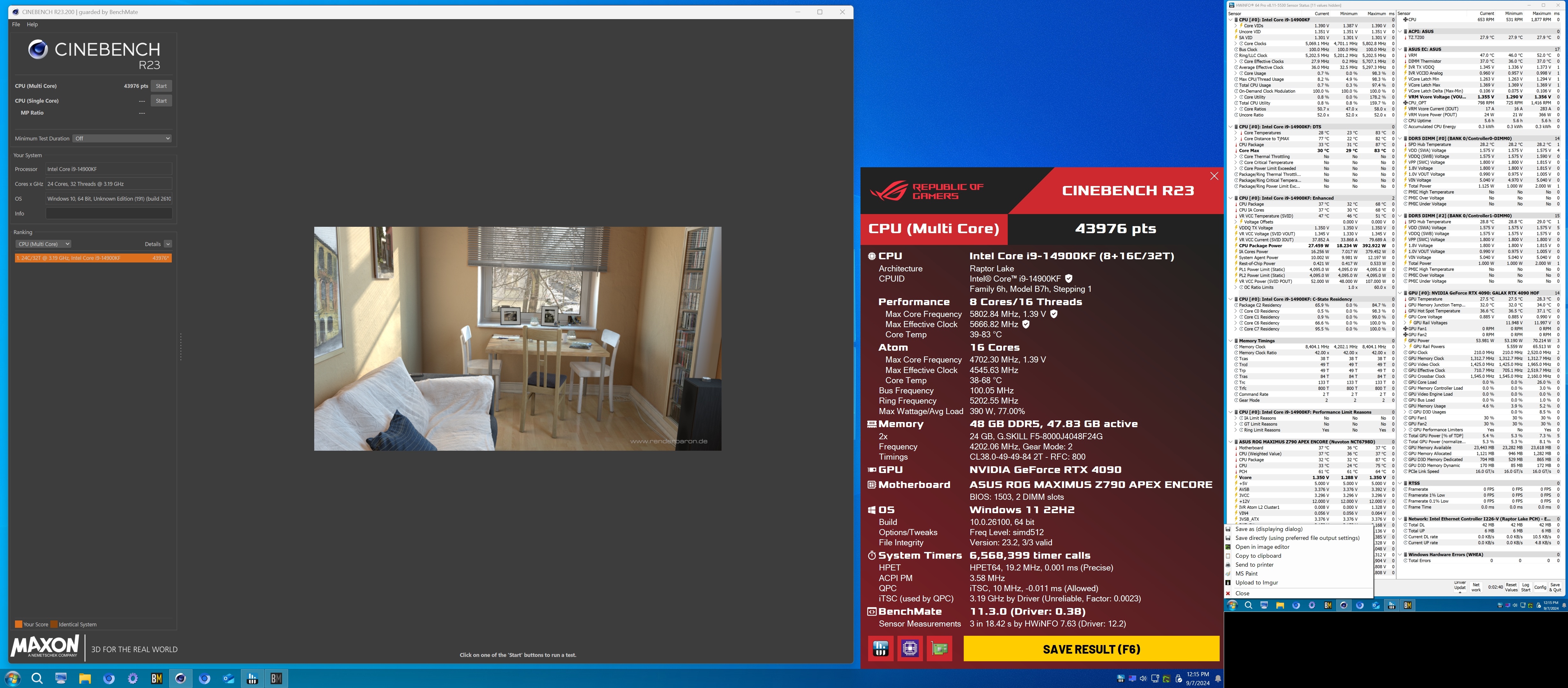

I wanted to do a comparison of Auto voltage fixed core 5.9Ghz and also the Auto voltage 5.9-6.2Ghz, just if anyone is curious what it looks like.
Run #1) 5.9Ghz locked on (8 Cores) Auto voltage DDR5 8600c36.
5.9Ghz Vcore MAX: 1.305V.
5.9Ghz VID MAX: 1.304v.
Load Vcore: 1.217V.
Package temp: 70C.
Idle Power min 16.3 watts
Package power Max R23 single core: 84 Watts.
Package power Max multi-core: 314 Watts.
R23 ST Score: 2,277.
R23 MT Score: 43,377.
Run # 2) 5.9Ghz (8 Cores) 6.2Ghz on (2 Cores) Auto voltage DDR5 8600c36.
6.2Ghz Vcore MAX: 1.403v
6.2Ghz VID MAX: 1.405v.
Load Vcore: 1.217V.
Package temp: 70C.
Idle Power min 15.8 watts
Package power Max R23 single core @6.2Ghz: 90 Watts.
Package power Max multi-core: 313 Watts.
R23 ST Score: 2,395
R23 MT Score: 43,389
It is important to note, that my best two cores only reach a max voltage of 1.387-1.396V. Since this is the case, I can lock my voltage to this ceiling and during low loads my voltage will never surpass this on any cores, because only the best cores #4 and core #5 are hitting 6.2Ghz. In the above scenarios the voltage is just auto/default.  So, it will kind of go where it wants to on all of the cores, even if only two of them are hitting 6.2Ghz. Fortunately, either setup is full auto, and both run really efficient regardless. We have the same nice low load voltage, only a slightly higher vcore for during 2 core loads when the chips hits 6.2Ghz. One just allows a +300Mhz advantage on two cores. I did not mean to highlight this font like this, it copied the font of the IMG url's I posted. Also, the average voltage seems comparable between the two in my time investigating this.
This isn't quite that low on load voltage, but very close (1.225V, so less than 0.010V difference)... This is with the P-cores set to "auto" and E-cores set to 47x all core. Similar Cinebench score as well, but with lower P-clock and higher E-clock.
I have not seen that on OC.net forum so I am not sure. I will have to look.
Yeah, de8auer has been pretty active lately when the temps were coming back on one of his blocks. I wasn't sure if it was the one you re-tested or another. 🙂
Your ring bus is a lot higher too (4.5 vs 5.2) @Mr. Fox I think @tps3443 was doing a pure "5.9 stock" run (5.9/4.5/auto (4.5) run and absolutely pure auto run w/ 6.2 boost.
