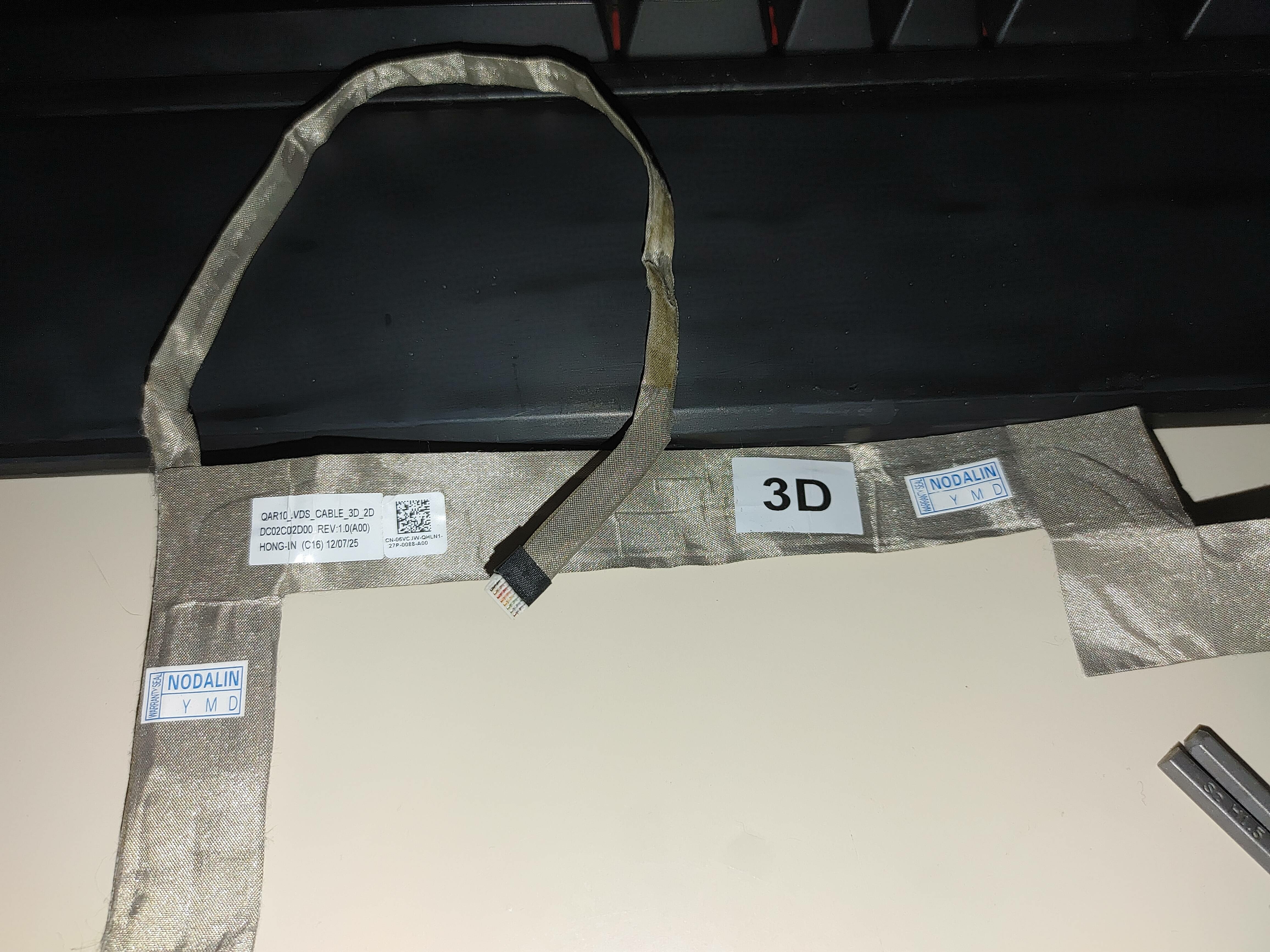

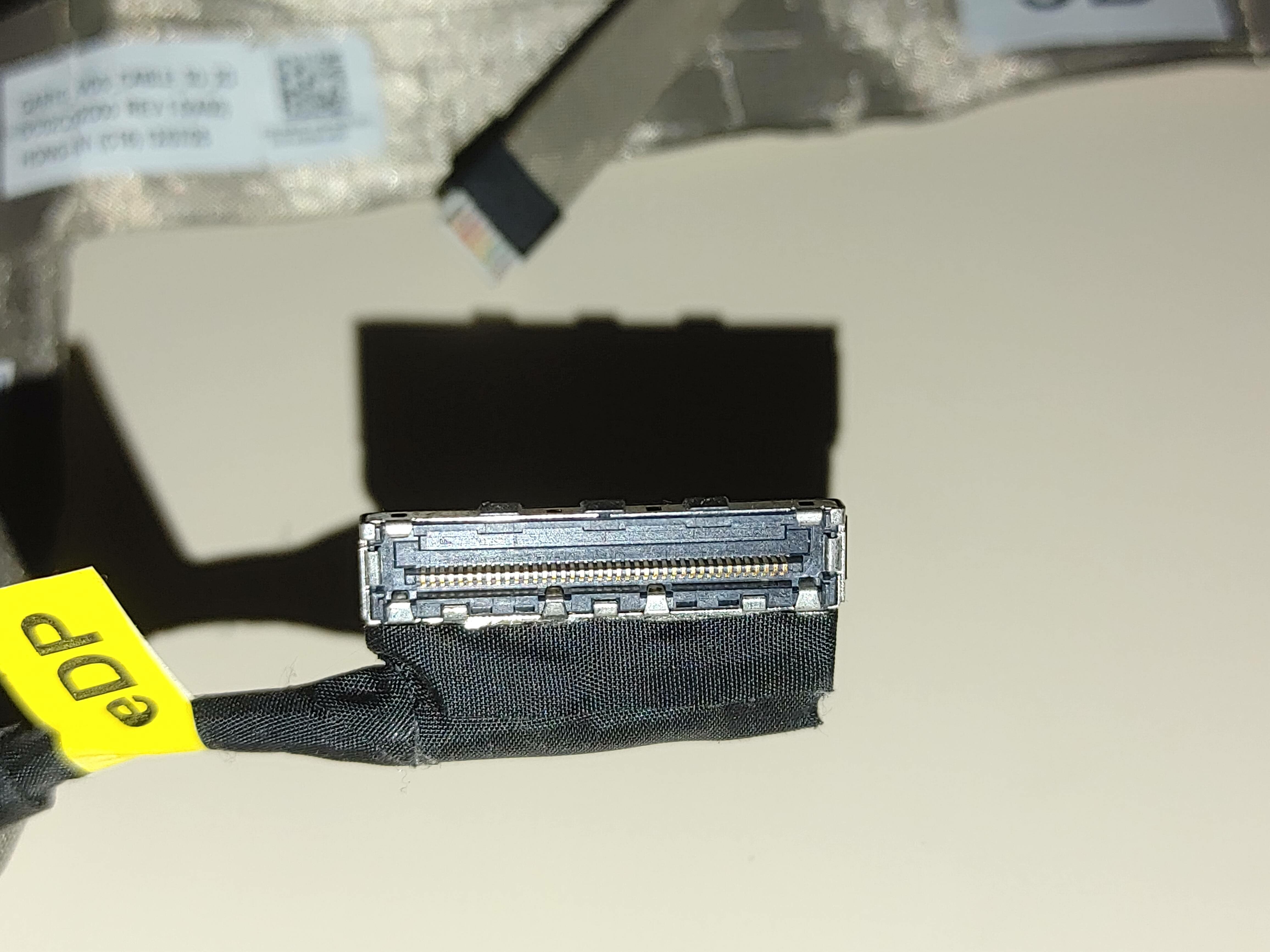

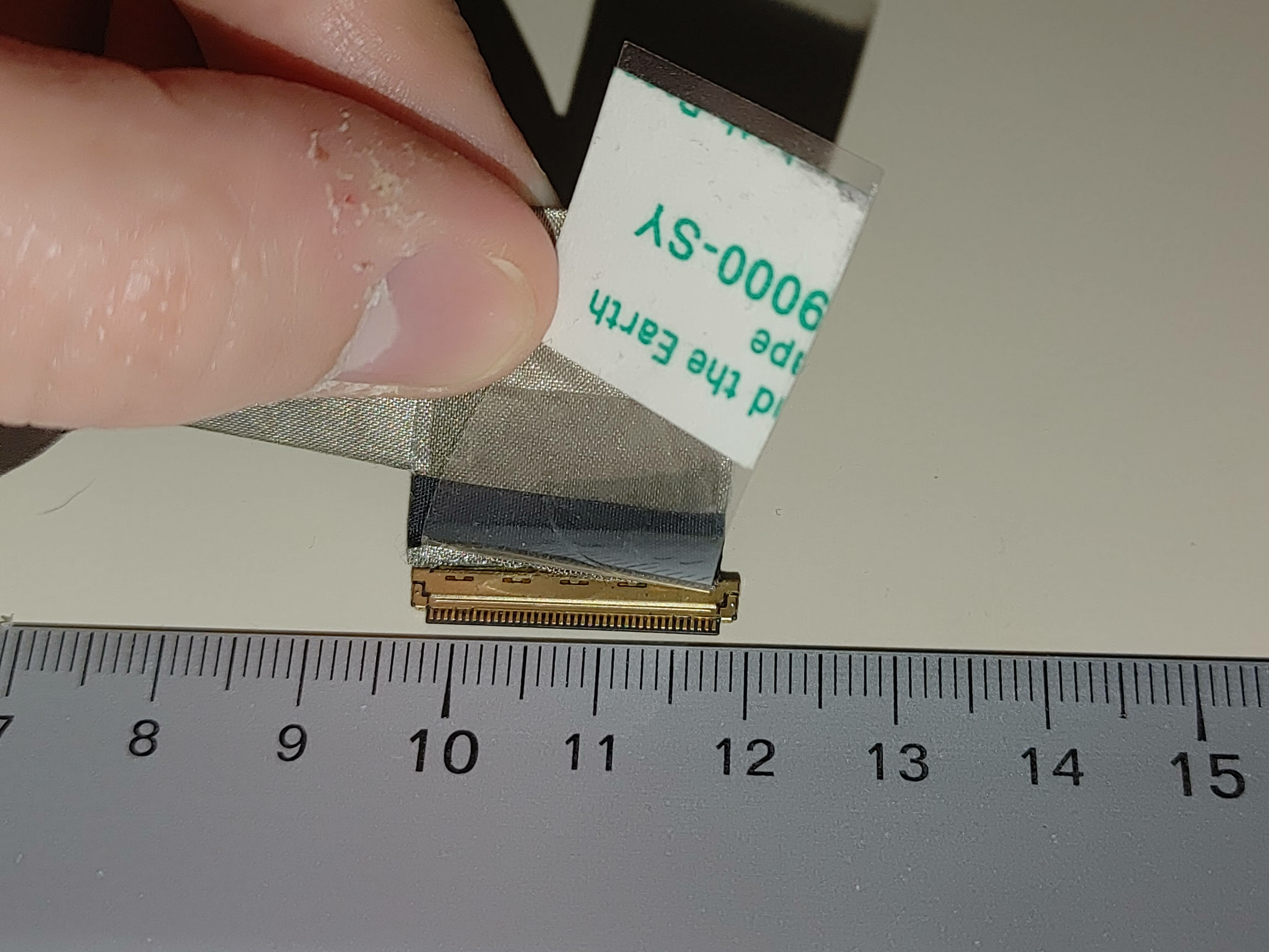

TheQuentincc Posted May 27, 2025 Posted May 27, 2025 For the record, this is how the 3D cable looks like Desktop / I7 14700KF @5.4/4.5GHz 1.25v delidded / MSI Z690 Edge Wifi DDR4 / 32GB DDR4 B-die @4200c16 / RTX 3080 Ti MSI Trio Plus / Triple 27" 4k120 + 2*4k60 XPS 9500 / I7 10750H @3.2GHz all-core / 32GB DDR4 2400MHz / GTX 1650Ti 4GB @50W / 15.6" UHD / NVME / 86Wh Precision 7550 / I9 10885H @4.6GHz all-core / 32GB DDR4 2933MHz / Quadro RTX3000 6GB @80W / 15.6" FHD IPS 500nits / NVME / 95Wh I was once running an overclocked I7 3920XM @4.2GHz all-core (nvram edit) in a Dell Precision M6700 with 32GB 2133MHz DDR3L, a Quadro P4000 and a 4k eDP display (using 3d cable)

JadeRover Posted December 26, 2025 Posted December 26, 2025 10 hours ago, SuperMG said: Hello, is the eDP cable for the M6700 is the 0YXDPN 30pin? What screen do you recommend? I have Quadro P5200 with VBIOS chip that will get removed from the Alienware M18X R2 I'm selling. I could test the RTX 3000 or RTX 4070 MXM but it's already installed as PEG eDP in my Precision 7720. That's actually a 40 pin edp cable that is only for the RGB lcd (the connector isn't a standard iPEX that plugs into a 4K lcd for example). I made a post about the difference in the cables, see here : You want the "3D" cable that is standard 40 pin 4 lane edp that was made originally for the 120hz 1080p screen option. Keep in mind that using an eDP lcd will force the MXM card to output directly to the internal LCD, located on DP_D of the MXM connector. There is no mux for the iGPU. That means that if you are testng vbioses or cards that don't have eDP/DP on DP_D you'll get a black screen, external HDMI and even VGA should work all the time. EDIT : that's assuming you wan't to upgrade the lcd to a modern 40 pin eDP IPS lcd (1080p >60hz or resolution >1080p). Upgrading to 4K has been done by a few members of the forum, look up @TheQuentincc Precision M6700 : i7-3740QM | P3000 6gb engineering vbios | 20gb DDR3 1600Mhz | FHD ips dreamcolor | delta fans Zbook 17 g3 : i7-6820HQ -75mv | M3000m 4gb | 16gb DDR4 2400Mhz | FHD ips Precision 7720 : i7-6820HQ -80mv & 102.7mhz BCLK| Zotac GTX1060 6gb, 100w OC vbios | 16gb DDR4 2666Mhz | (crappy) FHD ips -> 1440p165hz upgraded Zbook 17 g5 : i7-8850H, -140mv | P5200 16gb | 32gb DDR4 | FHD IPS
SuperMG Posted December 26, 2025 Posted December 26, 2025 2 hours ago, JadeRover said: That's actually a 40 pin edp cable that is only for the RGB lcd (the connector isn't a standard iPEX that plugs into a 4K lcd for example). I made a post about the difference in the cables, see here : You want the "3D" cable that is standard 40 pin 4 lane edp that was made originally for the 120hz 1080p screen option. Keep in mind that using an eDP lcd will force the MXM card to output directly to the internal LCD, located on DP_D of the MXM connector. There is no mux for the iGPU. That means that if you are testng vbioses or cards that don't have eDP/DP on DP_D you'll get a black screen, external HDMI and even VGA should work all the time. EDIT : that's assuming you wan't to upgrade the lcd to a modern 40 pin eDP IPS lcd (1080p >60hz or resolution >1080p). Upgrading to 4K has been done by a few members of the forum, look up @TheQuentincc Thanks. Yes every of my MXM cards are DP_D, it's the standard to have eDP for DP_D (except for HP ZBook G1/G2?) So I need the 06VCJW cable then? For any eDP screens (1080p to 4K)?
JadeRover Posted December 26, 2025 Posted December 26, 2025 4 hours ago, SuperMG said: Thanks. Yes every of my MXM cards are DP_D, it's the standard to have eDP for DP_D (except for HP ZBook G1/G2?) So I need the 06VCJW cable then? For any eDP screens (1080p to 4K)? Correct, DP_D is the standard (zbook 17/15 g3 has it on DP_C as well). Yes, you want the 6VCJW one Look at pictures when buying, it's the only one with a white "3D" sticker on it. All the other cables won't work. Precision M6700 : i7-3740QM | P3000 6gb engineering vbios | 20gb DDR3 1600Mhz | FHD ips dreamcolor | delta fans Zbook 17 g3 : i7-6820HQ -75mv | M3000m 4gb | 16gb DDR4 2400Mhz | FHD ips Precision 7720 : i7-6820HQ -80mv & 102.7mhz BCLK| Zotac GTX1060 6gb, 100w OC vbios | 16gb DDR4 2666Mhz | (crappy) FHD ips -> 1440p165hz upgraded Zbook 17 g5 : i7-8850H, -140mv | P5200 16gb | 32gb DDR4 | FHD IPS
