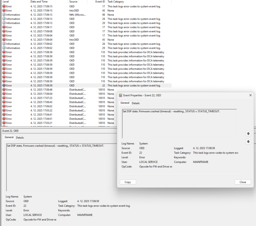

Yesterday I was watching some movies during the night time, powered down the machine at around 11PM. Apparently, the machine powered on itself sometime after the shutdown, perhaps due to Updates.. Today morning I have powered it on to 0% battery status. Each day with this machine is wonderful.
Already speaking with Dell about the possible solutions to all of my problems.

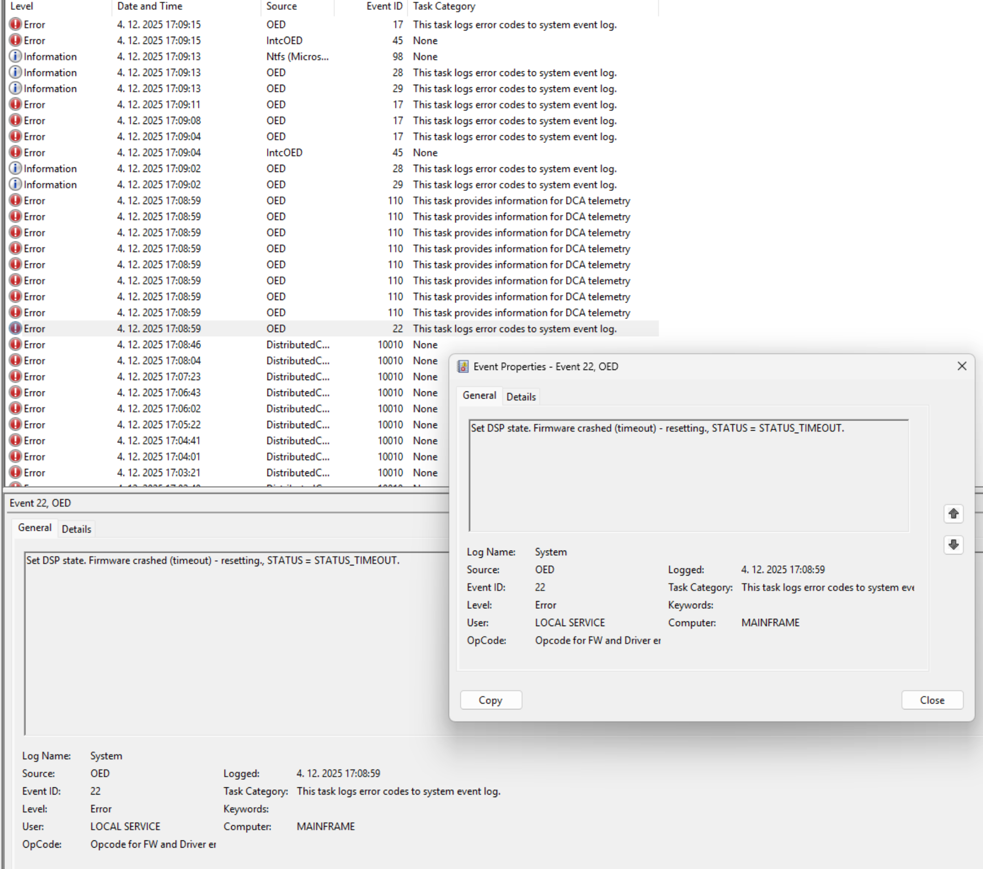

...but today the audio device spontaneously failed and the system had to be restarted for it to work again.
Pro Max Plus 18 surely is full of surprises.

Is that the Dell installed Windows or did you do a clean install from a standard Windows install image?
Could be that Dell preinstalled cares about clean Event Viewers - maybe not 😉
Could be that a clean Windows install by yourself and Windows Update for "standard" drivers and only then install missing Dell drivers might keep Event Viewer less red.
I stopped caring because some finger print, smart card and Office errors are always there which could be influenced by company policies and a non native Windows virus scanner. As long as my PMP18 works I stopped caring about Application and System event log errors - I tried before and just wasted time.
Just my two cents 😉
Dell Pro Max Plus 18 * Ultra 7 265HX * 64GB CSoDIMM * 4TB, 2TB, 2560x1600, iGPU
previous; Dell Precision 7680 * i7 13850hx * 64GB SO-DIMM * 4TB, 2TB, 1920x1200
previous: Dell Precision 7740 * i7 9750h * 48GB * 512GB, 2TB, 4TB * RTX 3000 * 1920x1080
I have nuked the original Dell Windows quite early - it was behaving even worse than a clean install. The total system power was spiking very high even during the idle usage, and the battery life was just poor, plus there were other issues. The clean install solved some of them.
I would also like to stop caring, if the device would at least work normally. Most of the time it does, but I just cannot tolerate an unreliable device for this kind of money. It has to be 100% stable.

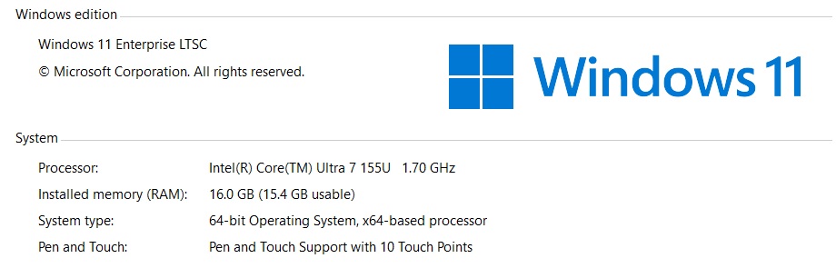

Honestly, I have no experiences with running daily LTSC edition of Windows, except on vending machines, terminals etc.
My installation has been optimized & stripped of unnecessary crap afterwards (WinUtil + Group Policies + StartAllBack), of course it cannot be compared to a LTSC, but I am satisfied with the thing as it is. TBH, the only serious bug that I have encountered with the recent 25H2 so far, is the certain update switching drive letters between C and D and corrupting the bootloader in the process. Observed on multiple computers during the last month.
I understand the benefits of LTSC, but I am fine with normal Pro version. Once the hardware runs properly, the software I can live with. For example, the desktop machine in my signature has the same OS with exactly same mods / adjustments, and its running like a dream.

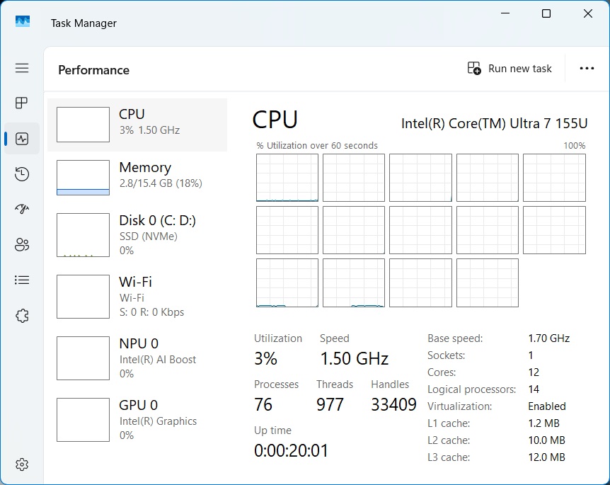

how many processes are running in the background when idle after reboot?
(my guess is you are still at least x2 if not x3 higher from the count my task manager shows below; idle after reboot.)

@Easa The WHEA 17 error also populated my Windows event log, as I anticipated. All at the Nvidia device, VID-10DE
