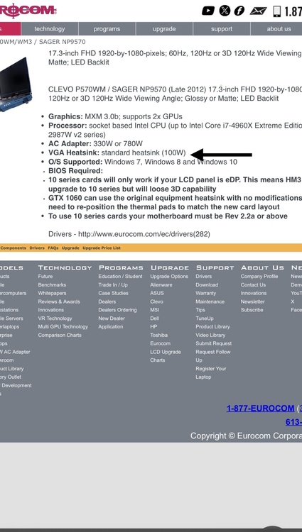

Maro97 Posted May 22, 2025 Share Posted May 22, 2025 Eurocom says the laptop heatsink support 100w heatsink not 200w you need a modded heatsink Link to comment Share on other sites More sharing options...
Maro97 Posted May 22, 2025 Share Posted May 22, 2025 Link to comment Share on other sites More sharing options...
SuperMG Posted May 22, 2025 Author Share Posted May 22, 2025 14 minutes ago, Maro97 said: Eurocom says the laptop heatsink support 100w heatsink not 200w you need a modded heatsink I got an email from them, they told me 200W... Still, I limit the power but I still get thermal throttling. The heatsink can handle my P5200 110W very well Link to comment Share on other sites More sharing options...
Maro97 Posted May 22, 2025 Share Posted May 22, 2025 10 watts is a very small increase for a heatsink designed to handle 100 watts. Link to comment Share on other sites More sharing options...
