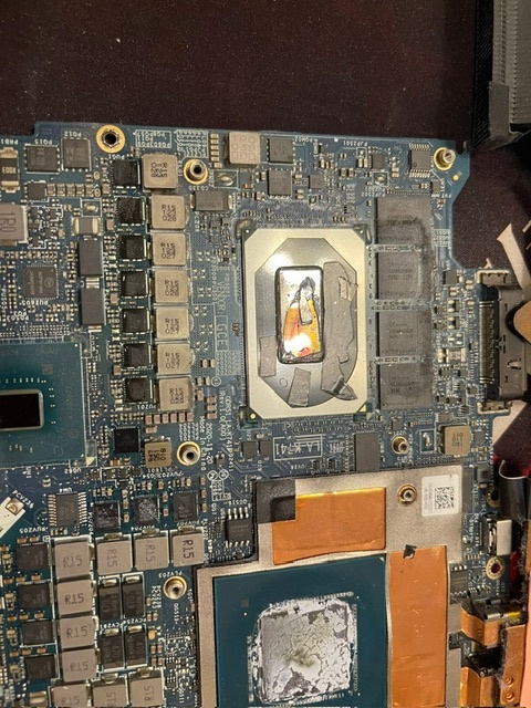

Maro97 Posted May 22, 2025 Share Posted May 22, 2025 100w heatsink with 150w gpu Link to comment Share on other sites More sharing options...
SuperMG Posted May 22, 2025 Author Share Posted May 22, 2025 1 minute ago, Maro97 said: 100w heatsink with 150w gpu I can lower to 110W using MSI Afterburner but... It also decreases the thermal limit. From 83C to 75C. Yes it thermal throttles at 75C at 110W... Funny Link to comment Share on other sites More sharing options...
Maro97 Posted May 22, 2025 Share Posted May 22, 2025 And don’t forget this In the process of insulating the capacitors around the GPU chip https://a.co/d/0SE7XoO Link to comment Share on other sites More sharing options...
Maro97 Posted May 22, 2025 Share Posted May 22, 2025 I know you have a good experience i read many of your post on AW fourm but i must remind you Link to comment Share on other sites More sharing options...
SuperMG Posted May 22, 2025 Author Share Posted May 22, 2025 21 minutes ago, Maro97 said: And don’t forget this In the process of insulating the capacitors around the GPU chip https://a.co/d/0SE7XoO That's how I did it Link to comment Share on other sites More sharing options...
Maro97 Posted May 22, 2025 Share Posted May 22, 2025 Heat dissipation from the heatsink will be weak with PTM and these thermal pads, as the gap between the GPU core and the heatsink will be relatively large. Use liquid metal along with properly sized thermal pads, because the GPU’s power is high compared to the heatsink’s performance Link to comment Share on other sites More sharing options...
Maro97 Posted May 22, 2025 Share Posted May 22, 2025 Could you please send me a photo of heatsink sides ? Link to comment Share on other sites More sharing options...
SuperMG Posted May 22, 2025 Author Share Posted May 22, 2025 4 minutes ago, Maro97 said: Heat dissipation from the heatsink will be weak with PTM and these thermal pads, as the gap between the GPU core and the heatsink will be relatively large. Use liquid metal along with properly sized thermal pads, because the GPU’s power is high compared to the heatsink’s performance I don't understand the video because I can't watch it right now. I don't understand what gap do you mean? Between the GPU die and the copper heatsink? Link to comment Share on other sites More sharing options...
Maro97 Posted May 22, 2025 Share Posted May 22, 2025 and in your case don’t advice to use a cooper shim on the gpu core Link to comment Share on other sites More sharing options...
SuperMG Posted May 22, 2025 Author Share Posted May 22, 2025 5 minutes ago, Maro97 said: and in your case don’t advice to use a cooper shim on the gpu core Eurocom told me to use a copper shim lol Link to comment Share on other sites More sharing options...
Maro97 Posted May 22, 2025 Share Posted May 22, 2025 1 minute ago, SuperMG3 said: I don't understand the video because I can't watch it right now. I don't understand what gap do you mean? Between the GPU die and the copper heatsink? I know because you don’t do it before Watch the video and you’ll understand — I used to do the same as you, estimating the size of the thermal pads on GPU cards in all my laptops just by eye, without any actual measurements using a millimeter gauge. But when I applied the method shown in this video on one of the laptops I own, I realized that you must calculate the thickness of the thermal pads for each component they will cover before placing the heatsink on the GPU die. Link to comment Share on other sites More sharing options...
SuperMG Posted May 22, 2025 Author Share Posted May 22, 2025 3 minutes ago, Maro97 said: I know because you don’t do it before Watch the video and you’ll understand — I used to do the same as you, estimating the size of the thermal pads on GPU cards in all my laptops just by eye, without any actual measurements using a millimeter gauge. But when I applied the method shown in this video on one of the laptops I own, I realized that you must calculate the thickness of the thermal pads for each component they will cover before placing the heatsink on the GPU die. And why mine has big gaps? If they all touch? Link to comment Share on other sites More sharing options...
Maro97 Posted May 22, 2025 Share Posted May 22, 2025 3 minutes ago, SuperMG3 said: Eurocom told me to use a copper shim lol Do you know which thickness you need …absolutely not cuz if you use a wrong thickness you be crack the gpu chipset like this photo Link to comment Share on other sites More sharing options...
Maro97 Posted May 22, 2025 Share Posted May 22, 2025 3 minutes ago, SuperMG3 said: And why mine has big gaps? If they all touch? Maybe not big gaps It’s not a huge difference — it might even be small — but use liquid metal to reduce the temperature. It will lower it by at least 10 degrees compared to what it is now. Link to comment Share on other sites More sharing options...

SuperMG Posted May 22, 2025 Author Share Posted May 22, 2025 (edited) I still haven't tried the 4070 (115W) on the Clevo P570WM but on my Dell Precision M6700 the temps were so high and the memory temps reached over 115C Do you guys think I should add a 4th heatpipe? I have 3 heat pipes. 2 for GPU and one for top VRAM/VRM Edited May 22, 2025 by SuperMG3 Link to comment Share on other sites More sharing options...
SuperMG Posted May 23, 2025 Author Share Posted May 23, 2025 14 hours ago, SuperMG3 said: I still haven't tried the 4070 (115W) on the Clevo P570WM but on my Dell Precision M6700 the temps were so high and the memory temps reached over 115C Do you guys think I should add a 4th heatpipe? I have 3 heat pipes. 2 for GPU and one for top VRAM/VRM I can't send a picture because of the limit but I have a place to add a 3rd heat pipe on the copper plate of the GPU die. I also have some margin to glue the heat pipe on the heatsink. I bought 3 18cm heatpipes because it's an enough length. I bought some thermal glue that works between -60C to 250C. I did see a video on how to bend a heat pipe with bare hands, but don't you guys have something safer and can be done for free? Link to comment Share on other sites More sharing options...
