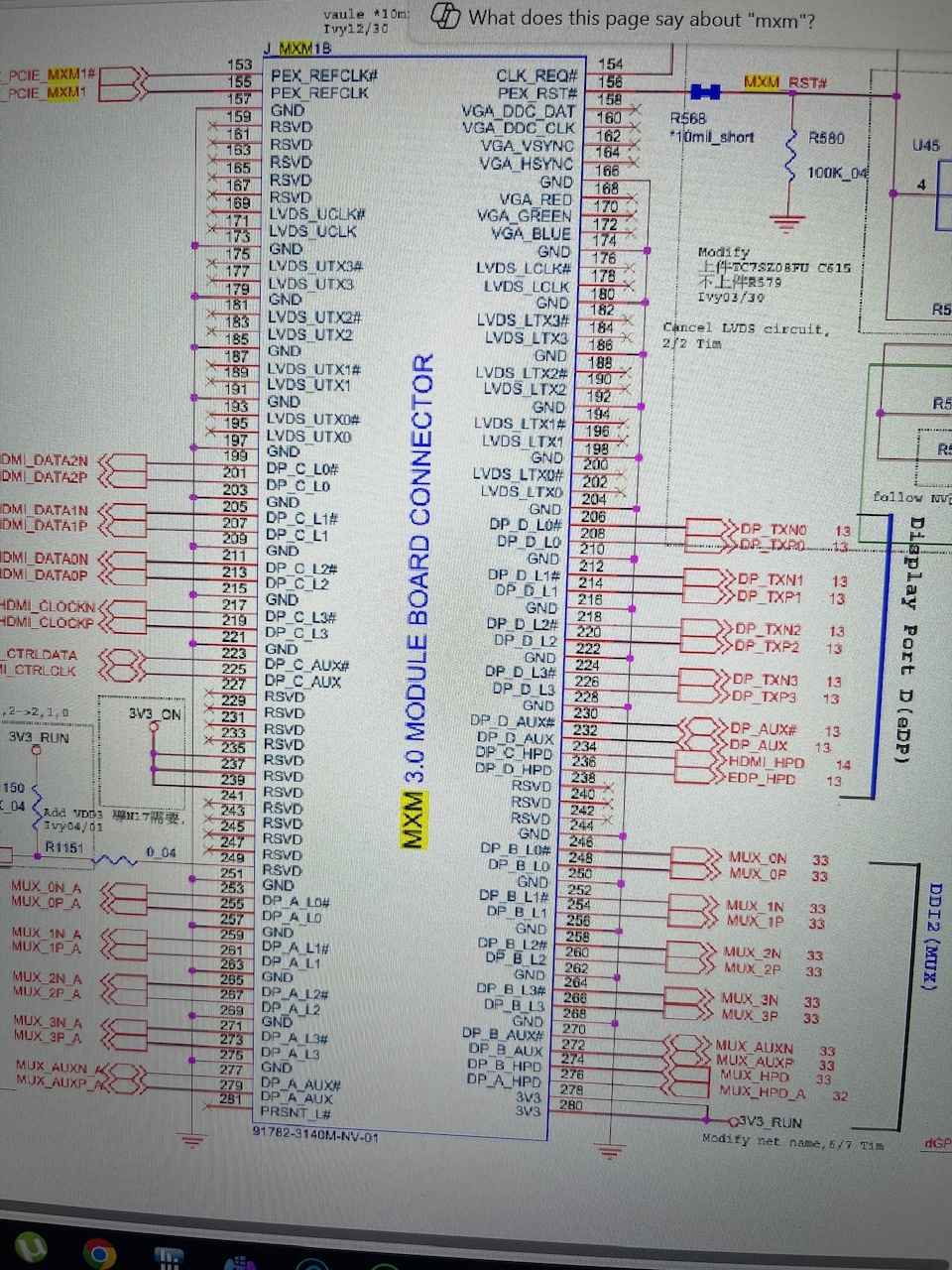

Maro97 Posted August 13 Author Share Posted August 13 9 hours ago, SuperMG3 said: Show your mxm connector schematics Link to comment Share on other sites More sharing options...
SuperMG Posted August 13 Share Posted August 13 35 minutes ago, Maro97 said: Yes you have the right pins for DP_D. Does your laptop use the standard MXM format? Or does it use external power? Did you try using a standard MXM card like a GTX 1070 to see if it works on eDP? Although our MXM connectors aren't the same because I don't even have the mention of MUX for DP_B and DP_A. But they seem to be on the same lanes. And although, my Quadro RTX 3000 works on eDP and also displays thru DP, HDMI easily. Link to comment Share on other sites More sharing options...
Maro97 Posted August 13 Author Share Posted August 13 46 minutes ago, SuperMG3 said: Yes you have the right pins for DP_D. Does your laptop use the standard MXM format? Or does it use external power? Did you try using a standard MXM card like a GTX 1070 to see if it works on eDP? Although our MXM connectors aren't the same because I don't even have the mention of MUX for DP_B and DP_A. But they seem to be on the same lanes. And although, my Quadro RTX 3000 works on eDP and also displays thru DP, HDMI easily. Link to comment Share on other sites More sharing options...

SuperMG Posted August 16 Share Posted August 16 On 8/13/2025 at 9:51 PM, Maro97 said: We have the same thing on pin 240 and 242. We both have RSVD. On ZRT's RTX 4050/4060 MXM I see 3V3 on both pins. I have no idea what these pins are for? Are they for the DP_D? For the JTAG signals? Who knows... Link to comment Share on other sites More sharing options...
Maro97 Posted August 16 Author Share Posted August 16 Thanks 🙏 @SuperMG for your updates I will waiting your opinion for upgrading my p870 to ZRT 4090 . “As for whether it is compatible or not Link to comment Share on other sites More sharing options...
SuperMG Posted August 19 Share Posted August 19 On 8/16/2025 at 10:54 PM, Maro97 said: Thanks 🙏 @SuperMG for your updates I will waiting your opinion for upgrading my p870 to ZRT 4090 . “As for whether it is compatible or not Hello, do you have a schematics for your eDP connector? Just to compare with mine. Since you have the same MXM connector pins 23, 25, 27 as me Link to comment Share on other sites More sharing options...
