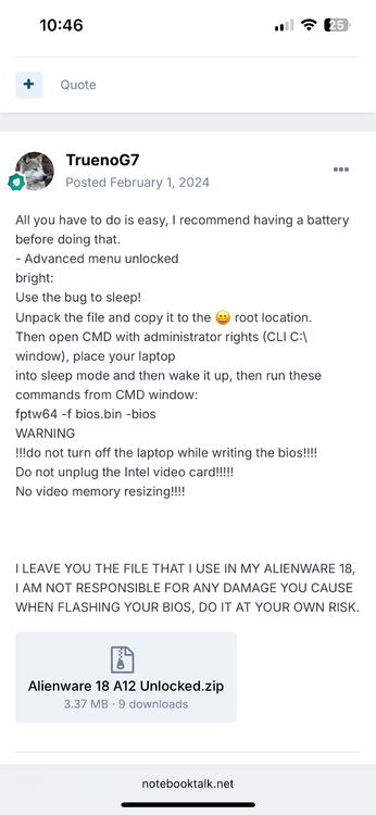

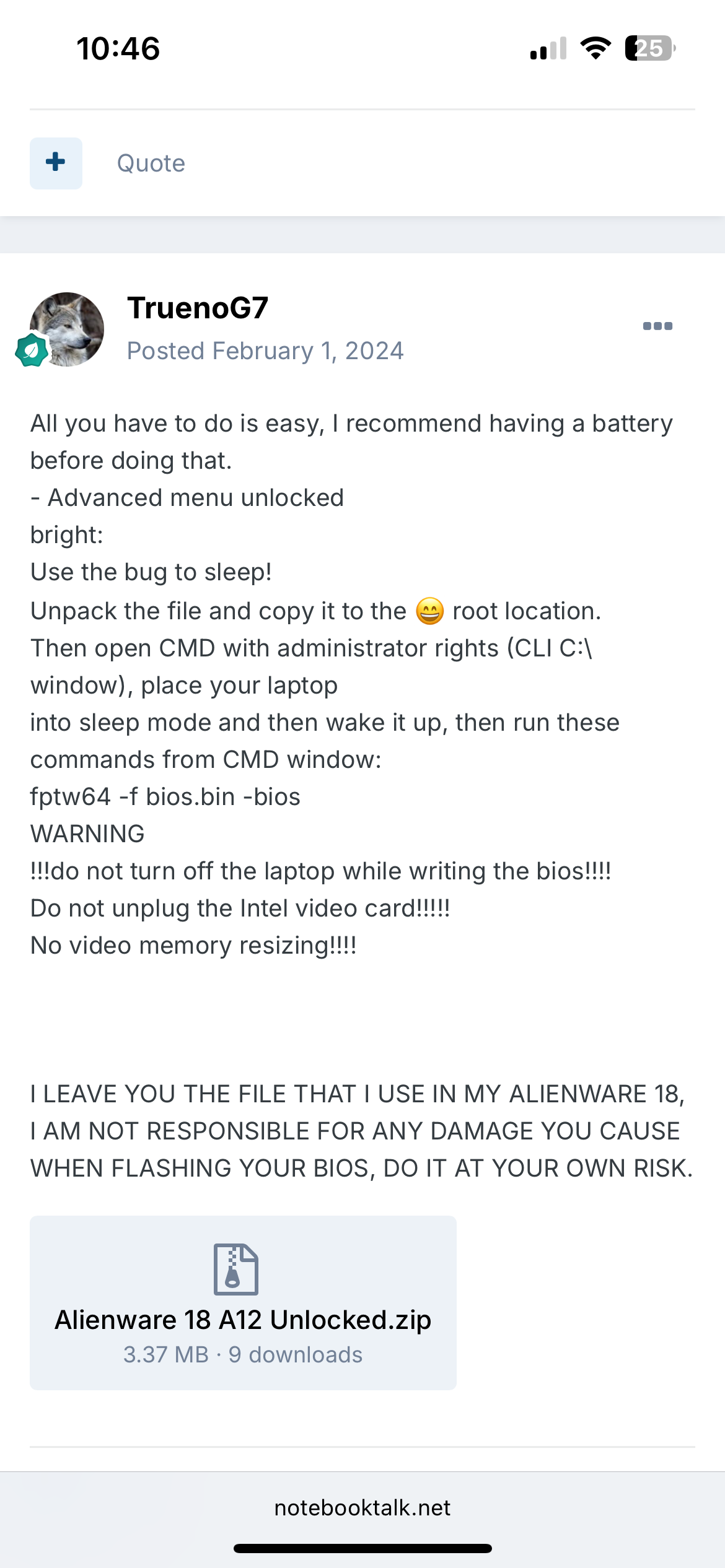

nicholas1020 Posted September 8, 2025 Author Posted September 8, 2025 I suppose I probably could utilize TruenoG7 method posted in the pic using the bios that ssj92 had posted on a thread for unlocked bios.
SuperMG Posted September 8, 2025 Posted September 8, 2025 5 hours ago, nicholas1020 said: I suppose I probably could utilize TruenoG7 method posted in the pic using the bios that ssj92 had posted on a thread for unlocked bios. Yes

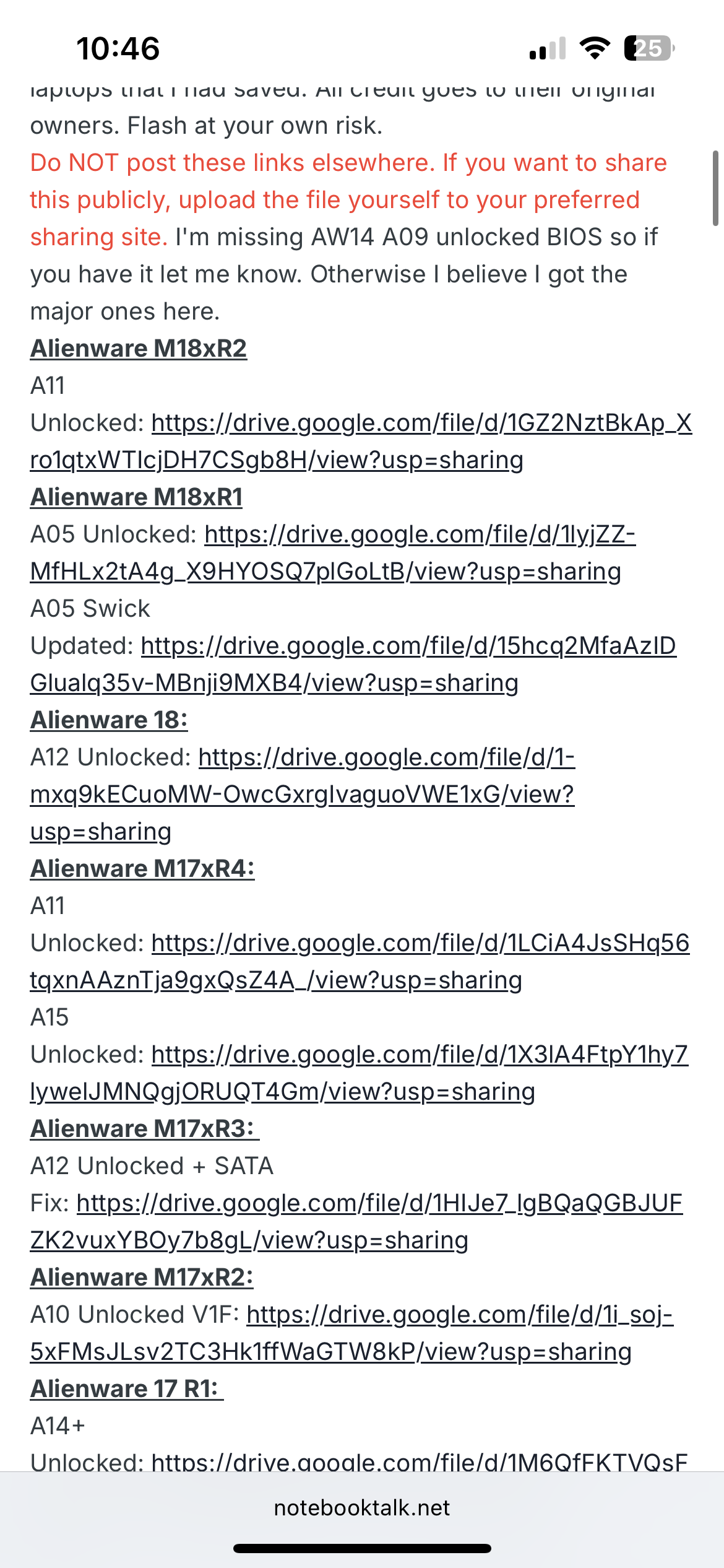

nicholas1020 Posted September 14, 2025 Author Posted September 14, 2025 Need an unlocked bios for the Alienware m18x r2 I still have an unlocked bios for the Alienware 18 just need one for m18x r2.
Jerryzago Posted September 14, 2025 Posted September 14, 2025 First of all, grab the A11 BIOS from this post I think M18x R2 doesn't like the sleep method for the BIOS flashing. Also you are on a later version (A14) so it will possibly cause boot issues. I will describe the process with the correct steps. It is a long way, but it will surely be error free. For good measure if your GPU is a newer than an 880m, it should be removed from the system. 1) Blind flash and BIOS downgrade to A03 Download the original Alienware unmodded A03 bios from Dell at Drivers and Downloads | Dell [united States] The file is named "M18R2A03WIN" Extract the contents of M18R2A03WIN to a new folder named "Alienware recovery" anywhere on your useable computer. In there you should have a bunch of files. (9 in total) Look for the one called QBR10EC.fd Rename this file to M18R2.hdr Place the file M18R2.hdr on a formatted fat32 usb stick on its own. Thats it. Blind created Recovery process: To do the recovery process you need to remove your m18x r2 battery. Unplug the back power cord as well Plug the usb stick with the file M18R2.hdr in the M18X's e-sata port Now hold down the END key (located above the numbers key pad) at the same time while your holding the END key plug in the power cord only, you will hear the fans turn on full bolt. Release the end key and wait After a few seconds once the file is read from the USB stick you will hear 20 or 30 beeps (sounds like a garbage truck reversing) After the beeps stop the m18x will shut down and reboot itself. ( 1 or 2 times depending) Once reboot all will be back to normal A03 bios. Connect the battery back if you wish after successful boot If you successfully boot, enter BIOS and check version 2) Upgrade to official A11 Just download the official A11 and flash it through windows. 3) Download the unlocked A11 from the post above and flash it with the instructions provided. Use a flash drive to create a boot disk into dos Unzip ALL files into the root of the flash drive (flash.bat, r2final.bin, fpt.exe, flash.bat, prr2.exe, fparts.txt,m18r2.hdr, m18r2.hdr.bin, readmefirst.txt) BOOT INTO DOS – Note, that when you set the bios to legacy in order to boot into dos, you MAY have to reinstall OS! (Just be prepared to reinstall no matter what) Once you boot into dos, run the file flash.bat It will unlock your bios (THANKS TO SVL7’s BIOS UNLOCKING TOOL – ALL CREDIT TO HIM FOR THIS TOOL!) Let it flash… Reboot your pc, and enjoy the MASSIVE updates! Alienware M18x R2 / i7 3720qm -> i7 3940XM / Dual 7970m -> 980m SLI -> HP Quadro RTX 3000 Alienware 17 R1 / 4710MQ -> 4930mx / 880M GTX -> PNY Quadro RTX 3000 HP 8570w / i7 3820qm / Quadro K2000M HP DV6500 / i7 T7200 -> i7 T9500 / 2GB RAM -> 4GB RAM / Atlas OS
