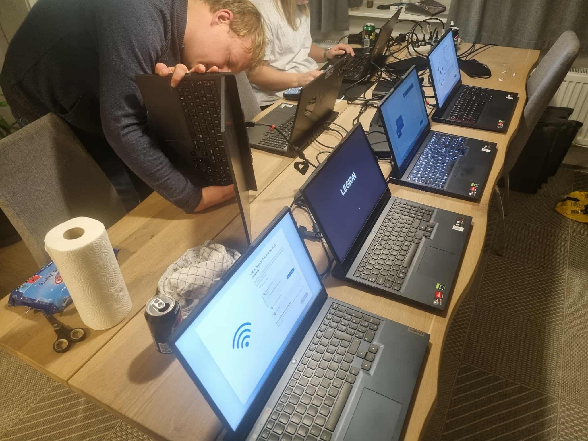

CaptainsWorkspace Posted November 8 Author Share Posted November 8 @Daedalus Happy it succeed for you! Have also damaged some of the clips and couldnt find any spares on Mouser or Ebay so used a doner laptop. Butw asnt so lucky with the M2200, got the EEPROM programmer and turned out there was no VBIOS on the chip. After installing new VBIOS did the fans spin at full, but still got no image. But ran out of time and returned the MXM cards within the 1 month return policy. Have instead bought 9pcs of "Lenovo Legion 5" (Ryzen 7 and RTX 3070) to use as spare/guest LAN systems instead, still setting them up. (only 7 of them on the picture, as 2 still where stock in postage) Might have to sell the 8 old Elitebooks and the spare i7 3840QM's we never got to install. Happy for the help and tips, would have loved to use the Elitebooks but ran out of time as we have a upcoming LAN in December where we will have sneak premiere of a playable PoppyPlaytime prequel where better systems are required for the multiplayer testing. Link to comment Share on other sites More sharing options...
