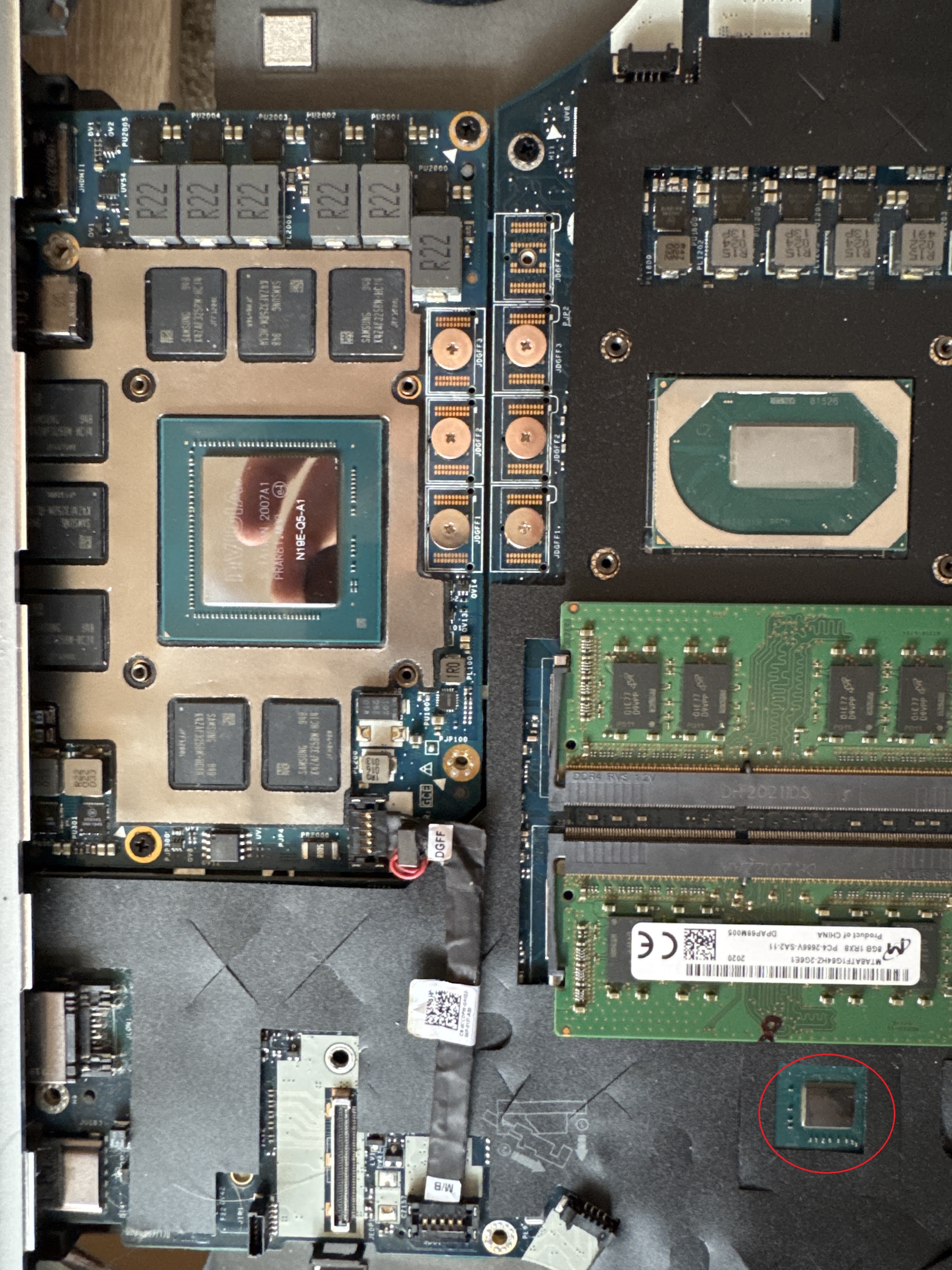

Chalybion Posted January 7 Posted January 7 Your CPU is the 8750H, right? With PTM and a working undervolt, it should run in the low 80s at max load. I haven't used thermal putty before, but I would be really really cautious about applying too much, causing poor contact between the CPU and heatsink. These laptops are also really sensitive to ventilation. Set on a flat surface, the CPU temperatures will be higher. With the back elevated or on a ventilated surface, the CPU temperatures should hit low 80s max The circled component is the Platform Controller Hub (PCH) Precision 7520 / Xeon E3-1535m v6 / 32 gb DDR4 2666 MHz CL15 / GTX 1650 Mobile / LP156QHG-SP(V1) Precision 7540 / i9-9980HK / 32 gb DDR4 2666 MHz CL15 / RTX 4000 / LP156QHG-SP(V1) / Delta Fans

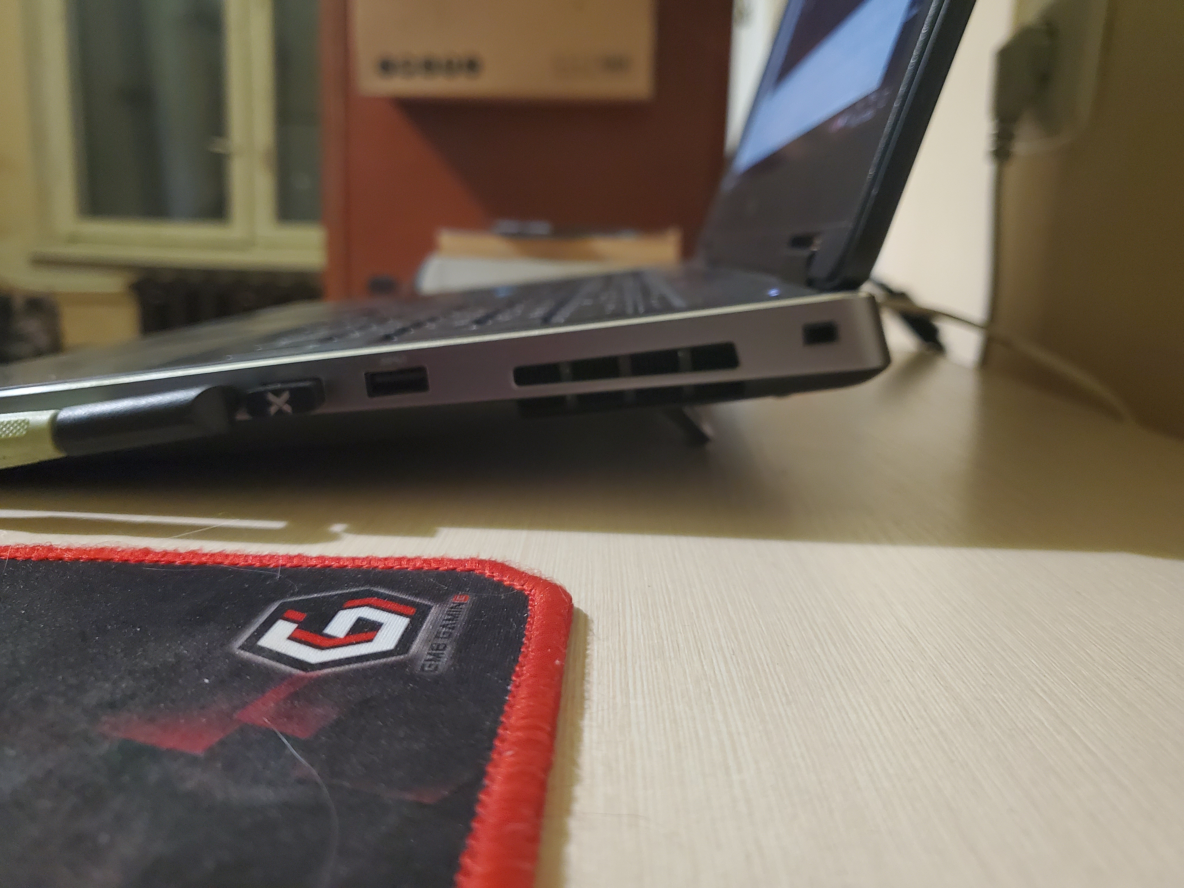

Nrml Man Posted January 8 Posted January 8 On 1/7/2026 at 5:39 AM, Chalybion said: 8750H Thanks for answer.Yes,it is.I did change turbo-boost plan from default agressive to efficient agressive.Termal putty sells in needles so i make 2 sausages and it's total volume is not big on smd and vrm.Seems to be all these can reduce total heating as it was earlier.I put my notebook on these legs so it breathes good.

Chalybion Posted January 8 Posted January 8 Those fold out legs are a neat solution. Are they durable? I remember that the CPU VRMs use 0.5mm thermal pads, so even a tiny bit of extra thickness could cause contact issues for the CPU Notebookcheck has a good review of the ZBook: https://www.notebookcheck.net/HP-ZBook-Fury-15-G7-Workstation-Review-Vapor-Chamber-for-Maximum-Performance.512628.0.html The build quality looks solid. Compared with my Precision with similar specs (undervolted 8-core Xeon, RTX 5000 Max-Q), the HP scores 10% lower in Cinebench R20, and 15% lower on 3DMark graphics. Precision 7520 / Xeon E3-1535m v6 / 32 gb DDR4 2666 MHz CL15 / GTX 1650 Mobile / LP156QHG-SP(V1) Precision 7540 / i9-9980HK / 32 gb DDR4 2666 MHz CL15 / RTX 4000 / LP156QHG-SP(V1) / Delta Fans
