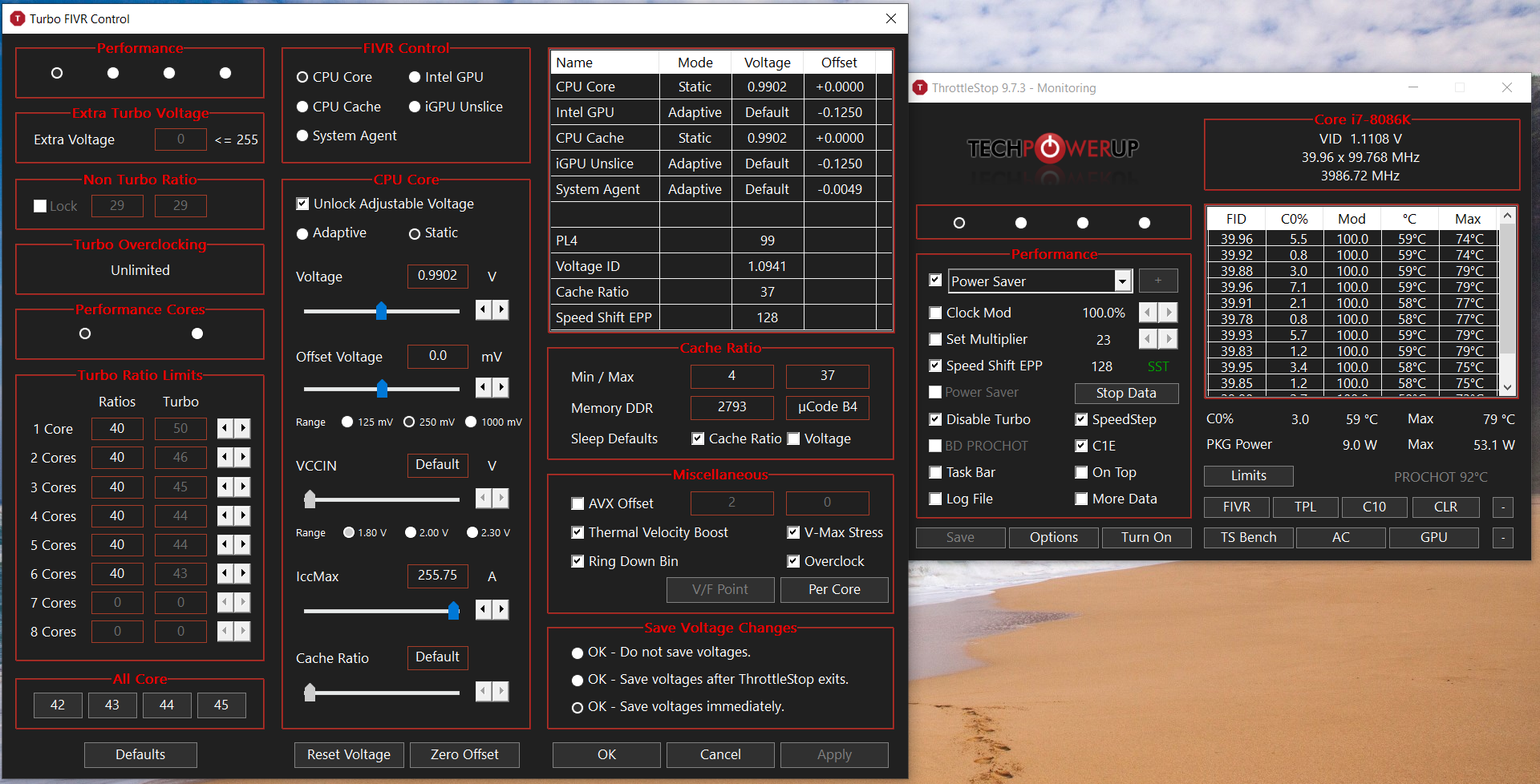

I decided today to just make an account instead of just browsing topics day after day trying to see if anyone else has my issue, I have been trying to undervolt my Clevo P750TM1-G, well the Sager variant of it. I can set my voltage as low as I want in throttlestop but it will always be about 0.1-0.3v higher, and fluctuates a lot. I really want to find a way to stabilize my voltage so I can undervolt my i7-8086k as much as humanly possible, cause the cooling in the stock configuration isnt great and I dont exactly got the money to just buy upgraded cooling right now. I have even tried setting the voltages in the EFI, which is stock and that didnt fix the voltage issues either. I made a short recording of how much it fluctuates at idle, and it can get even worse sometimes. Are my VRMs screwed up?

Bro nevermind i managed to bios mod my own bios and now i have the power of the sun 5ghz stable at 1.25mv all cores, man im so happy i worked 8 hours into that

I just edited the already existing eurocom bios, implemented the ME from the dsanke one, kept the special features this bios had factory from eurocom, and edited some things, but cranked all power and voltage regulators limits up, agressive LLC and shyt, but tbh it just unlocked the true potential of the chip i will investigate more as stated before i could already put -100mv on the cpu beforehand(also i havent slept so im zombie af)
