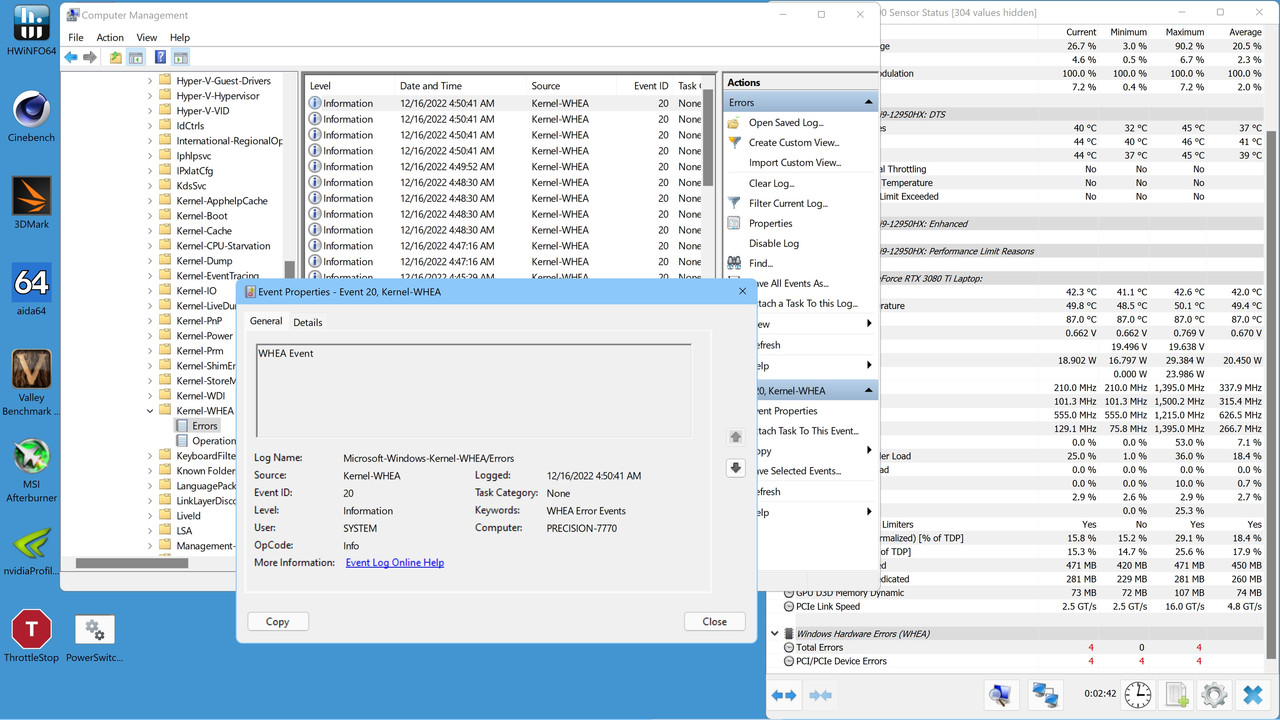

noticed some weird hardware error issues recently,
not sure if they were there the whole time or started recently,
i tried to eliminate variables to try and narrow this down but i have no lead atm,
it is not caused by the under or overvolting, its not a driver compatibility issues (went back to original OEM image),
seems to be related to the dgpu but no additional info can be found even system logs are very vague,
it wont happen during CB23 run nor when running Valley bench,
but if i open Afterburner or 3DMARK just to the main interface not even running tests yet it will trigger these hardware errors instantly,
can someone please help validate if this is just on my system?
BIOS update 1.8.0.
https://www.dell.com/support/home/en-us/drivers/driversdetails?driverid=JG0V9
- Firmware updates to address security vulnerabilities including (Common Vulnerabilities and Exposures - CVE) such as CVE-2022-3365 and CVE-2022-30339.
I am also seeing WHEA events.  They seem to come in "bursts".  The most recent I have is a batch of 15 which occurred within 20 seconds of each other, about two days ago.  They don't occur often.  I see a few bursts on December 13 and 14, but then I have a break all of the way back to December 2.  (My system is powered on 24/7.)
I haven't noticed any actual problems timed with these events, so I'm just going to ignore it.
