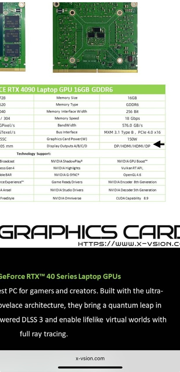

SuperMG Posted August 29, 2025 Posted August 29, 2025 2 hours ago, Maro97 said: V.good news So rtx 4090 from x-vision will work Depends. This one has like 2 HDMI and 2 DP out. The vbios indeed has eDP support but for which port? on D or E?
Maro97 Posted August 29, 2025 Posted August 29, 2025 4 minutes ago, SuperMG said: Depends. This one has like 2 HDMI and 2 DP out. The vbios indeed has eDP support but for which port? on D or E?
SuperMG Posted August 29, 2025 Posted August 29, 2025 2 minutes ago, Maro97 said: But that's not eDP! It's regular DP on the VBIOS! Although eDP and DP are sharing the same exact 11 signals (without counting the GND) Can a regular DP out with the 23,25,27 pins display on the eDP display? @Developer79
SuperMG Posted August 29, 2025 Posted August 29, 2025 (edited) 5 hours ago, Maro97 said: I looked at ZRT side, the eDP is on port D and the HDMI on port E. I don't understand X-VSION specs. There's no way you have eDP on port E!! The vbios clearly has eDP because it shows it on the Nvidia control panel. (I have Quadro RTX 3000 + 4090 as slave) @Maro97if you know how to solder, you can go ahead and do the mods. If you want more explanation on the mod, please send me a private message. Thank you. Edit: the 4080 and 4090 aren't even working with my external HDMI and DP out.... But the RTX 4070 and 3060 worked with DP and HDMI out, strange... Edited August 29, 2025 by SuperMG

SuperMG Posted September 1, 2025 Posted September 1, 2025 @Developer79 @sliderfra Hello. I received the datasheet for the RTX 3060/3070/3080 MXM cards from X-VSION. They all have DP out for DP_D. They also all lack the pin 23, 25 and 27! But, are you sure that a DP signal would be compatible for an eDP display? Like, if we enable the backlight pins 23, 25, 27 by modding the MXM port? @sliderfrasince you have an RTX 3060 MXM, do you have a compatible eDP laptop? (Beside Alienware), like a clevo or a HP? So you can test if your 3060 can display on the master slot, "if the DP could display on the screen if the backlight pins are enabled".
Developer79 Posted September 1, 2025 Posted September 1, 2025 8 minutes ago, SuperMG said: @Developer79 @sliderfra Hello. I received the datasheet for the RTX 3060/3070/3080 MXM cards from X-VSION. They all have DP out for DP_D. They also all lack the pin 23, 25 and 27! But, are you sure that a DP signal would be compatible for an eDP display? Like, if we enable the backlight pins 23, 25, 27 by modding the MXM port? @sliderfrasince you have an RTX 3060 MXM, do you have a compatible eDP laptop? (Beside Alienware), like a clevo or a HP? So you can test if your 3060 can display on the master slot, "if the DP could display on the screen if the backlight pins are enabled". The P870TM model is compatible! I have demonstrated this.
SuperMG Posted September 1, 2025 Posted September 1, 2025 5 minutes ago, Developer79 said: The P870TM model is compatible! I have demonstrated this. So even, if the vbios states it's DP on DP_D. If I enable the backlight pins, using the mod, the DP signal would be projected on the eDP screen? Despite the vbios not having eDP set for DP_D?

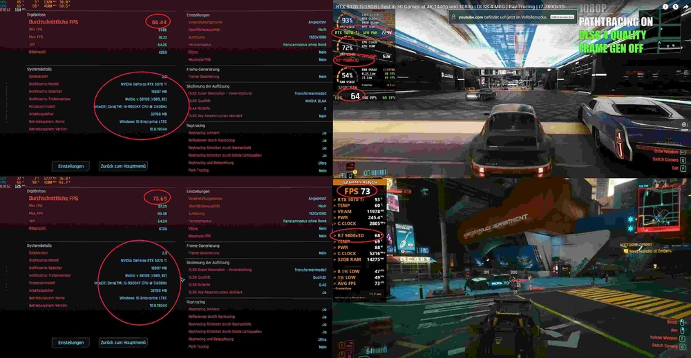

Developer79 Posted September 1, 2025 Posted September 1, 2025 here is antoher test with Cyberpunk 2077: CPU 9900KF / RTX5070Ti Interested AMD R7 8700X3d nad R79800x3d! 1
Maro97 Posted September 1, 2025 Posted September 1, 2025 looks Everything works great with internal LCD ? right ?

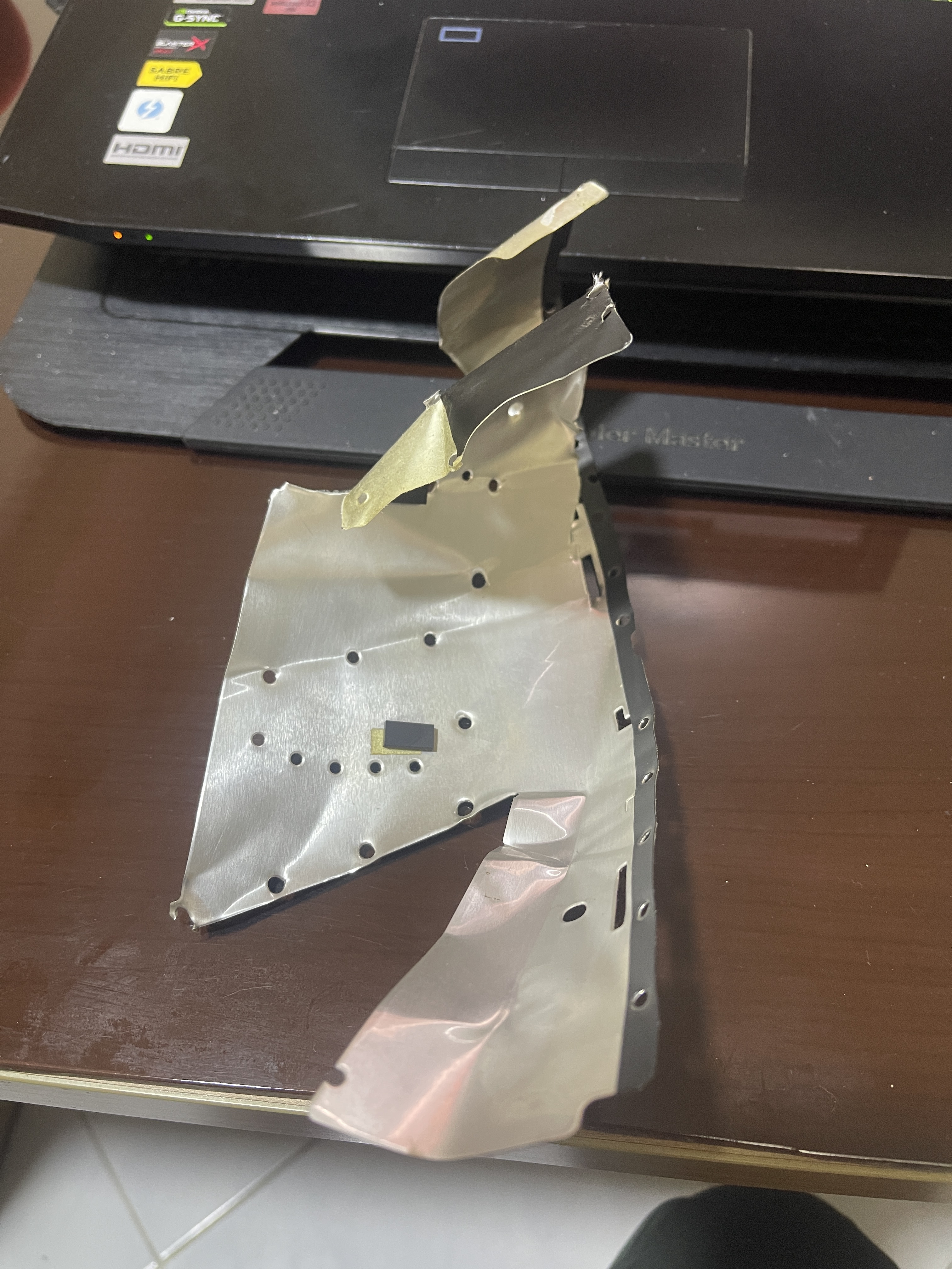

Maro97 Posted September 2, 2025 Posted September 2, 2025 This shit mounted on the inside of the back cover reduced the temperature by 5°C — I recommend removing it. 1

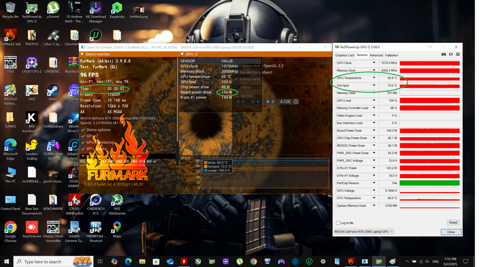

Maro97 Posted September 2, 2025 Posted September 2, 2025 3 hours ago, Maro97 said: This shit mounted on the inside of the back cover reduced the temperature by 5°C — I recommend removing it. The room temperature is 24°C. Developer79 heatsink worth to buy 👍 1
Maro97 Posted September 2, 2025 Posted September 2, 2025 1 hour ago, Maro97 said: The room temperature is 24°C. Developer79 heatsink worth to buy 👍 i'm using ... thermal grizzly kryonaut not Extreme 1

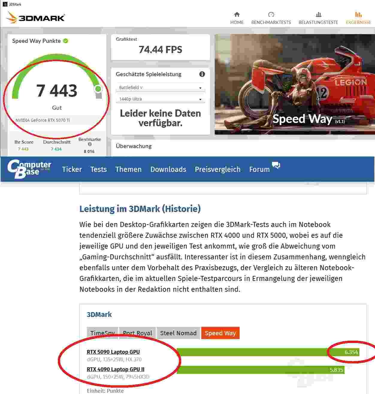

Developer79 Posted September 6, 2025 Posted September 6, 2025 Here's another test with 3DMark so you can see how powerful an RTX5070Ti is in the P870xx! The latest tests all show that the latest generation of CPUs for laptops and desktops doesn't play a huge role in gaming! Whether it's Intel or AMD!!! That's my experience. I also reduced the power consumption of the graphics card a little 250W! 2

Developer79 Posted September 7, 2025 Posted September 7, 2025 14 hours ago, Developer79 said: Here's another test with 3DMark so you can see how powerful an RTX5070Ti is in the P870xx! The latest tests all show that the latest generation of CPUs for laptops and desktops doesn't play a huge role in gaming! Whether it's Intel or AMD!!! That's my experience. I also reduced the power consumption of the graphics card a little 250W! You can also work with the original power of 300W, but I wanted to test lower power and similar performance.
