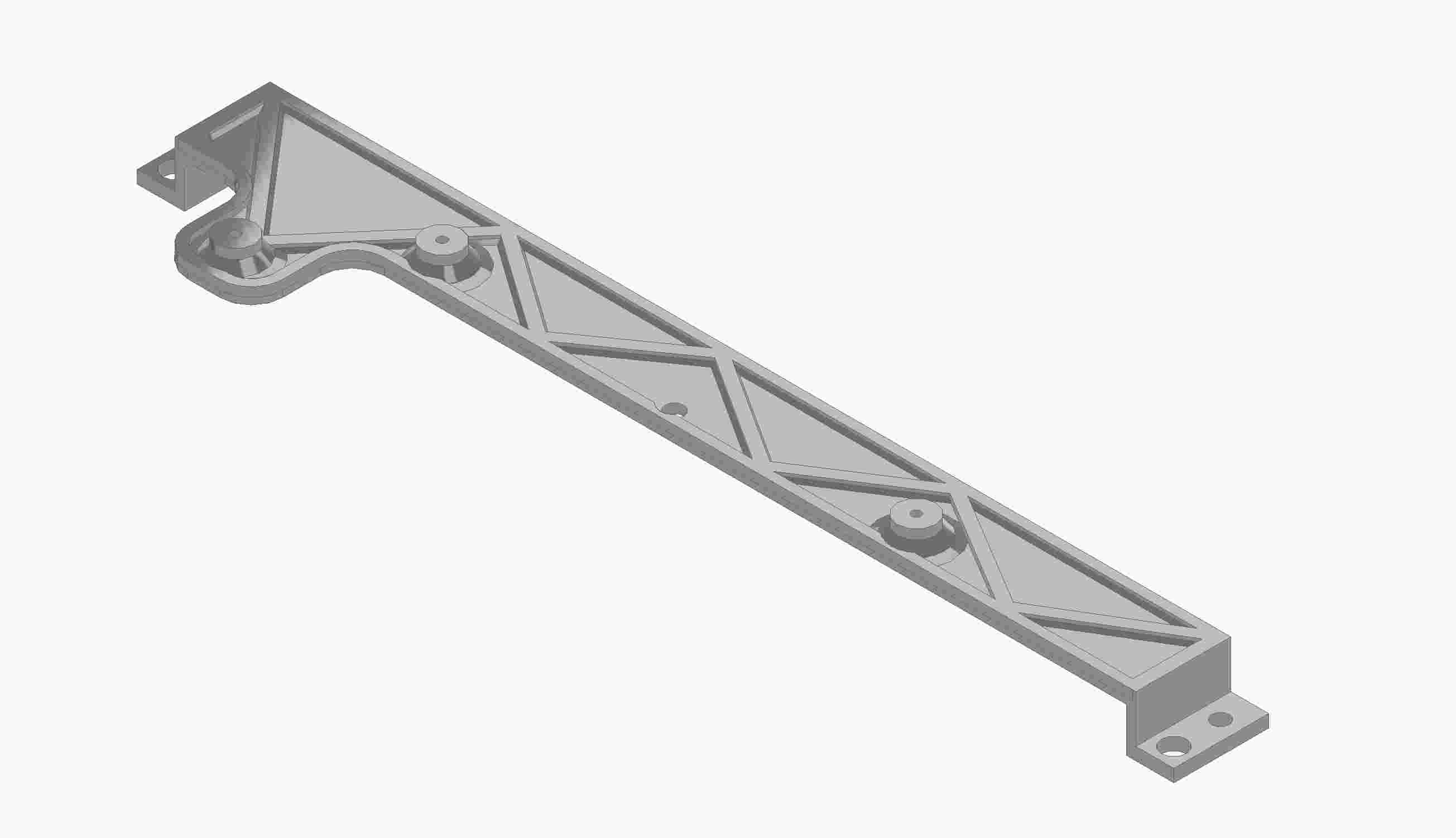

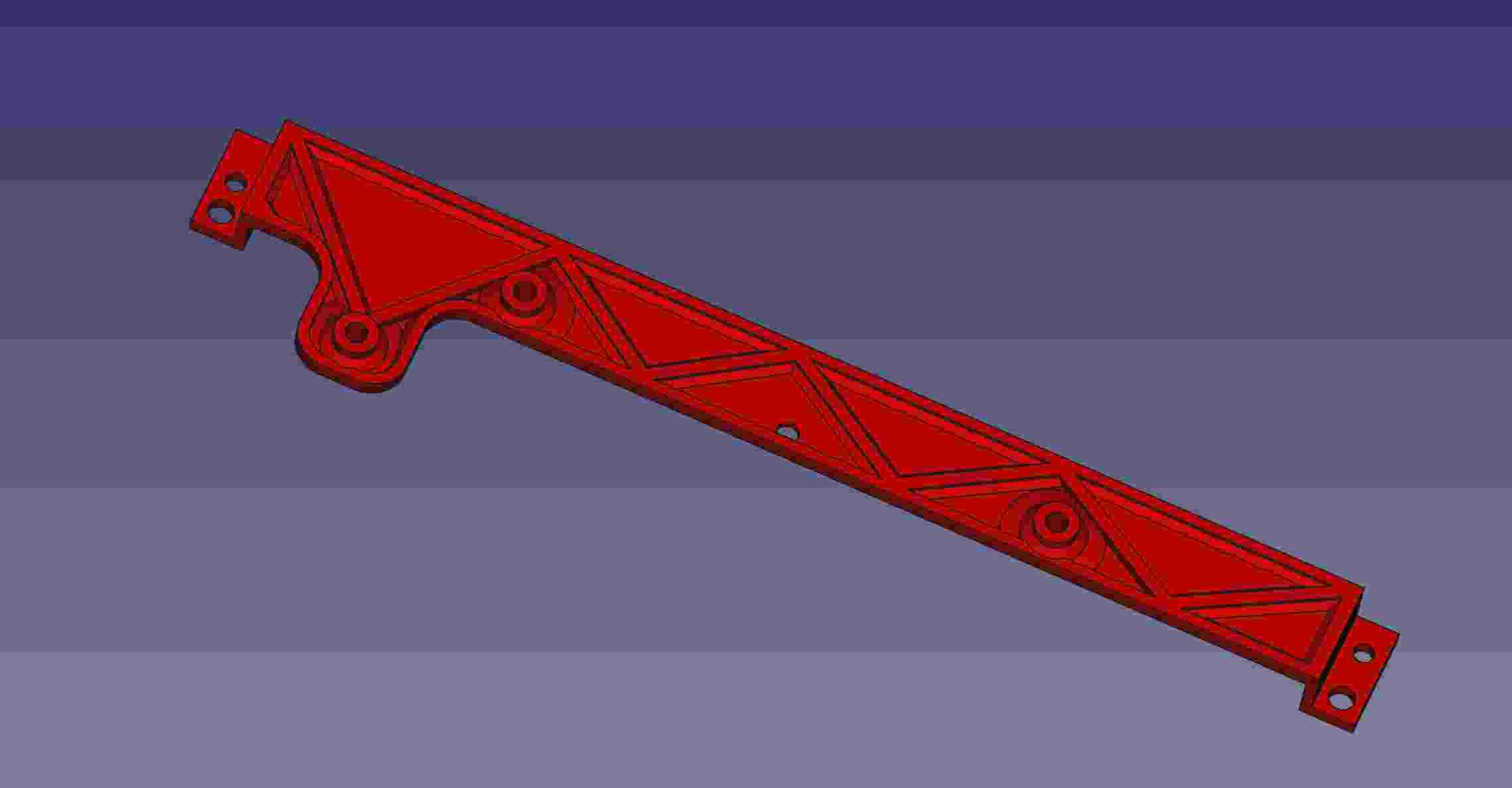

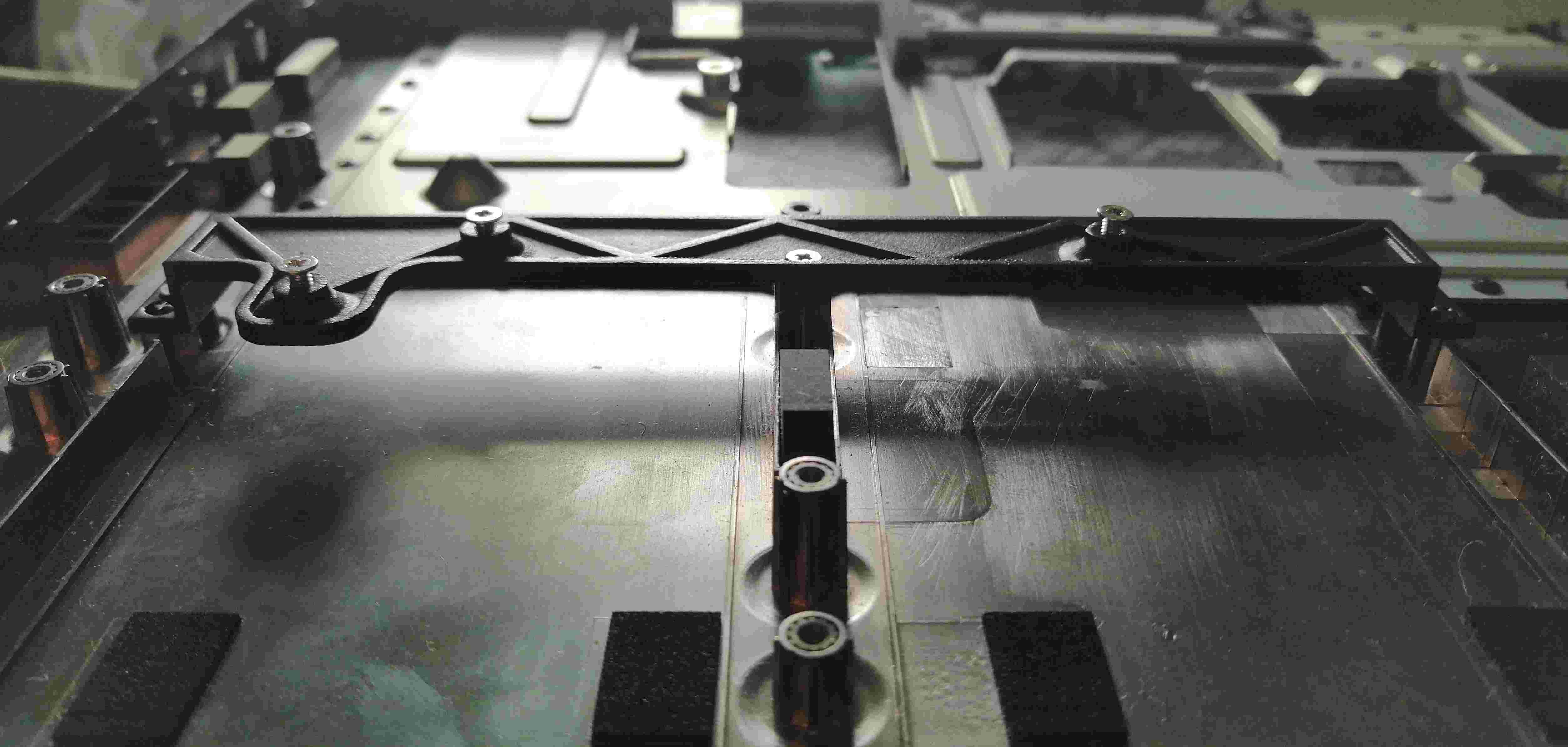

Developer79 Posted October 12 Share Posted October 12 Hello everyone, If anyone needs a holder for the RTX10/20/30 in the P870DMG, I have some made of steel! This allows you to install Clevo's MXM cards from the GTX10xx / RTX20xx / RTX20xx Super / RTX30xx series in the P870DMG! 1 Link to comment Share on other sites More sharing options...
Developer79 Posted October 28 Share Posted October 28 Hello, I have slightly modified my new P870DMG graphics card holder(stainless steel). This allows the GTX10xx/RTX20xx/RTX20xxSuper/RTX30xx MXM series from Clevo to fit better. The standard MXM cards from other manufacturers will also fit into the P870DMG. That means the RTX40xx/RTX50xx series! With the latter, it may take a little more effort to get them to run properly in the P870DMG! 1 1 Link to comment Share on other sites More sharing options...
