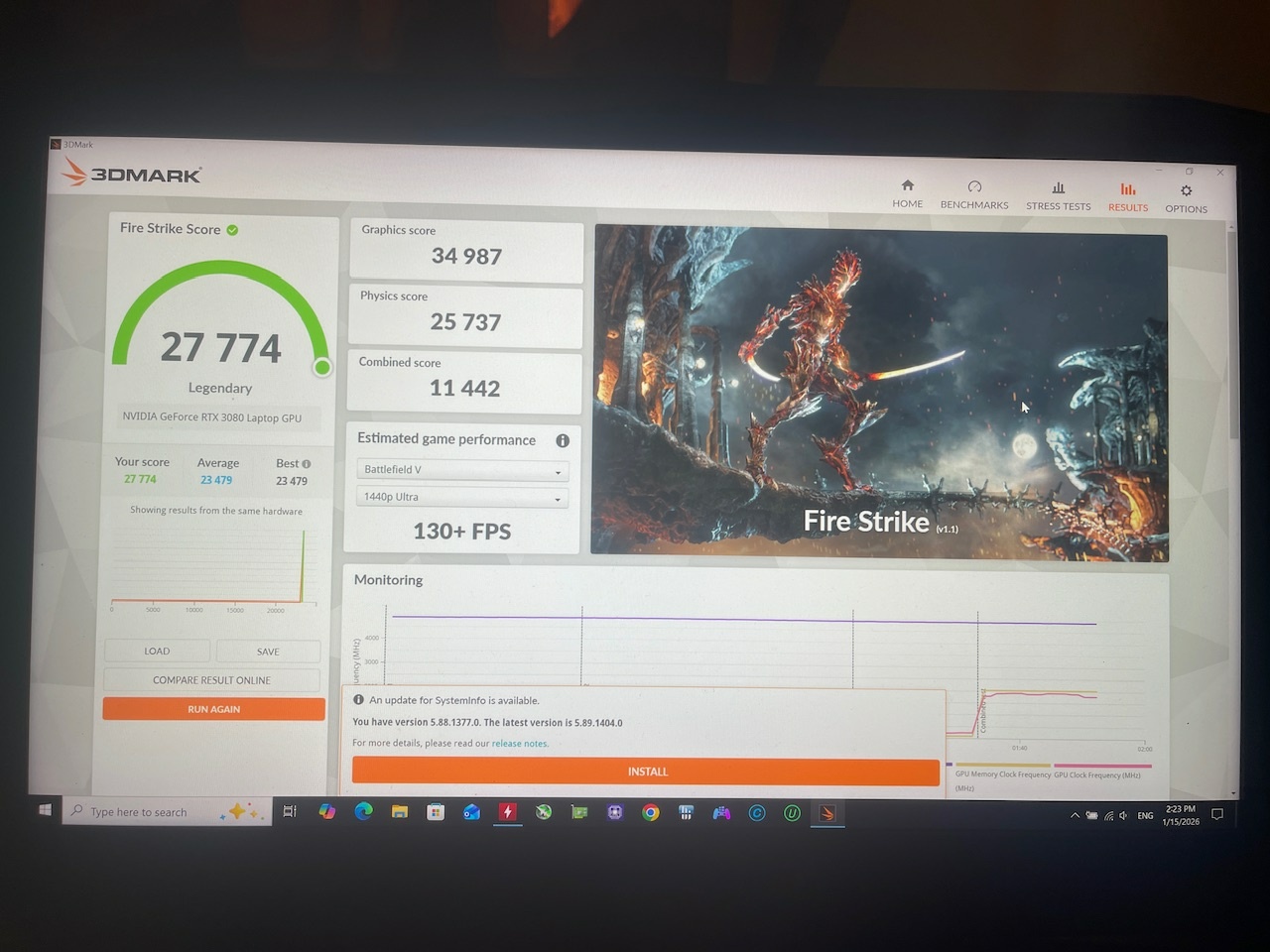

Maro97 Posted January 9 Posted January 9 Here it is the latest FS result with 9900kf 4.7hz all cores UV -110 & rtx 3080 OC 120/1150
