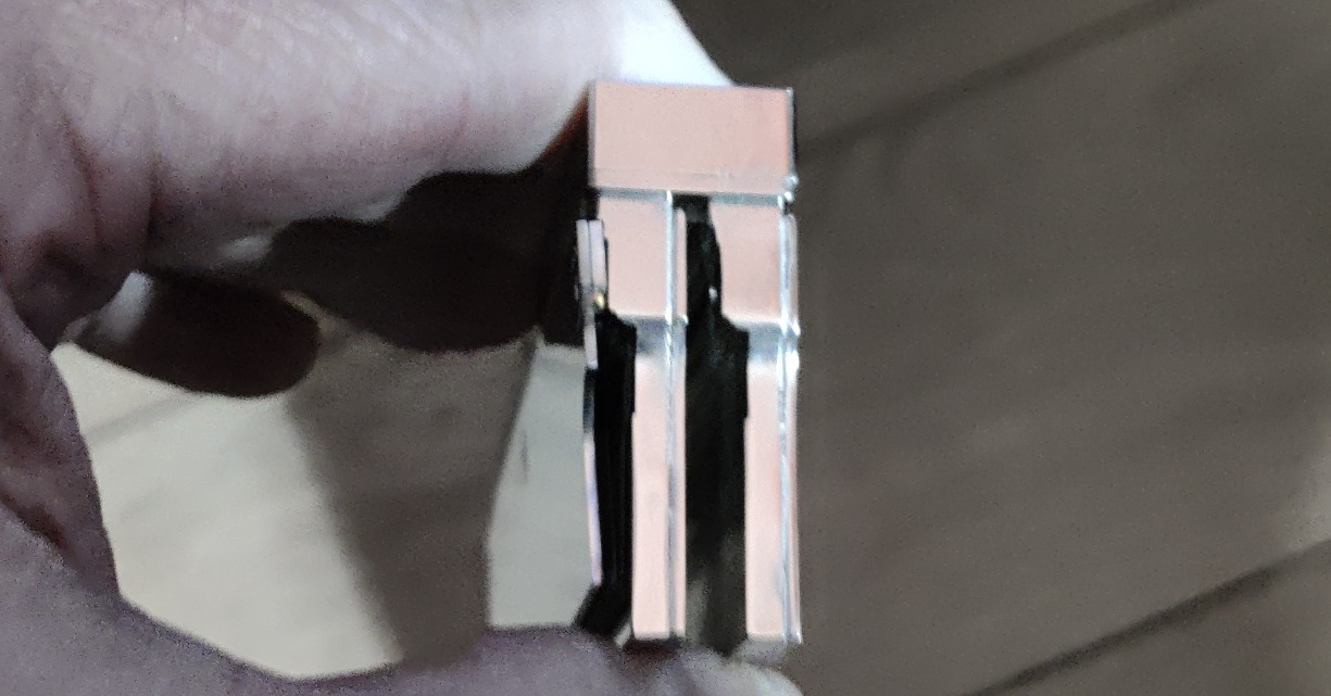

@tps3443my memory kit arrived. It is made different than what was evident in photos. Too bad they did not include any kind of documentation. Do you know if Supercool has a video showing the way they recommend assembling, or did you just determine that by examining the parts? (It looks pretty simple based on what I am seeing.) This assembly is incredibly heavy. If you ever dropped your case or set it down extra hard I could see it damaging the memory slots like a GPU floppy around in the PCIe slot.
It looks like these actually stack with no air space between the modules if I am interpreting what I am looking at. It seems to make a sandwich with no backplate for the first module, just a foam pad between the back of the PCB and the cold plate for the second module. Am I interpreting that correctly? So, did you assemble it without the Allen screws tight before installing in the slots, then once the modules were inserted into the motherboard, then tightening down the back plate Allen screws to smush the sandwich together? Then, last step tighting the Allen bolts on top? There probably would not be enough space between the modules for a back plate for each RAM stick because the cold plate in the middle takes up most of the space.

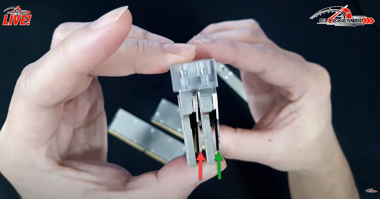

Hey, your pic is correct! And here is a video that will help @Mr. Fox
Yes the foam pad goes against the back of the blank side memory PCB. I would not peel off of the sticky tape either, if you do you won’t be able to slide the modules forward backward to line up with the dimms when you go to insert it as 1 whole piece.
Your pic is the proper layout though. You can take everything apart to assemble, it’s very easy to reassemble too.
You really only have to unscrew the waterblock top screws on one module, and the 3 screws for each of their back plates and you will have access to everything.
Put 0.5mm pad on each IC, and 1.0MM pad on the PMIC, then line the inner memory stick up with the memory waterblockblock (same amount sticking out on each side), or as best as you can, then tighten the 3 screws on the inner stick backplate. Then mount your outer stick and line it up with the already mounted memory stick exactly. Then tighten that ones back plate on too.
My temps were identical Dimm1/Dimm2 on air cooling without watercooling hooked up. Once I added water cooling I got a deviation between their temps by about 3.5C. Not sure why. Still, they run stupid cold lol.

@tps3443that didn't answer a question I had upon initial inspection, and I cannot understand what they are saying. Maybe @Clamibotcan translate. He clearly has an older design in the video, but it raises the same question I had as soon as I unboxed it. His video shows a backplate on each module. The kit I received DOES NOT include a backplate for both modules, only one for the outside stick with the bare side of the PCB.
My kit does not have the piece where the red arrow is pointing. Only has the backplae where the green arrow is pointing. Is that how yours is made also, or did they accidentally omit a part out of my kit? The photos on the Supercool web site are not helpful at all because they are incomplete and do not accurately depict what the kit should look like.
This is how mine arrived. Notice the difference? Is something missing, or that is the new design?
Uh oh! Looks like you are missing a back plate, and (3) screws. That’s a screw up on Supercools behalf there @Mr. Fox. That really sucks too. I would post a comment on the YouTube video, and send him a message as well.
On your first pic I missed that completely..
Are you missing the (3) screws on the inside as well that hold the back plate on?
Missing backplate, screws and o-rings. Lovely. 😑 Wonder how long it will take to resolve?
I wish mine was black. Sucks that they waited to release it and everyone that doesn't like white got what they got. Now I feel like I got screwed by ASUS again. They excel at that. I hate ASUS. They suck.
It looks like you have all (4) O-Rings in the top block in the picture. Unless I am missing something here. Someone I know said to message him on Facebook directly. He also responds quickly in the YouTube comments too.
There are no o-rings. What are you seeing that looks like o-rings? There is a slot where o-rings should be, but they are empty. I emailed their Gmail address and used the "Contact Us" from the store page.
If I do not get a reply by the time I get off work I will message them on Facebook. I try to avoid logging into Facebook as much as I can.
Edit: I see the o-rings are translucent now. After turning on the lights in my office to get a better look they are there, but hard to see. They look like an empty o-ring groove without bright lighting. I saw your previous photos showing black o-rings. I posted a comment on the YouTube video.

@tps3443Supercool responded and apologized for the oversight. Said he would ship the missing parts right away.
