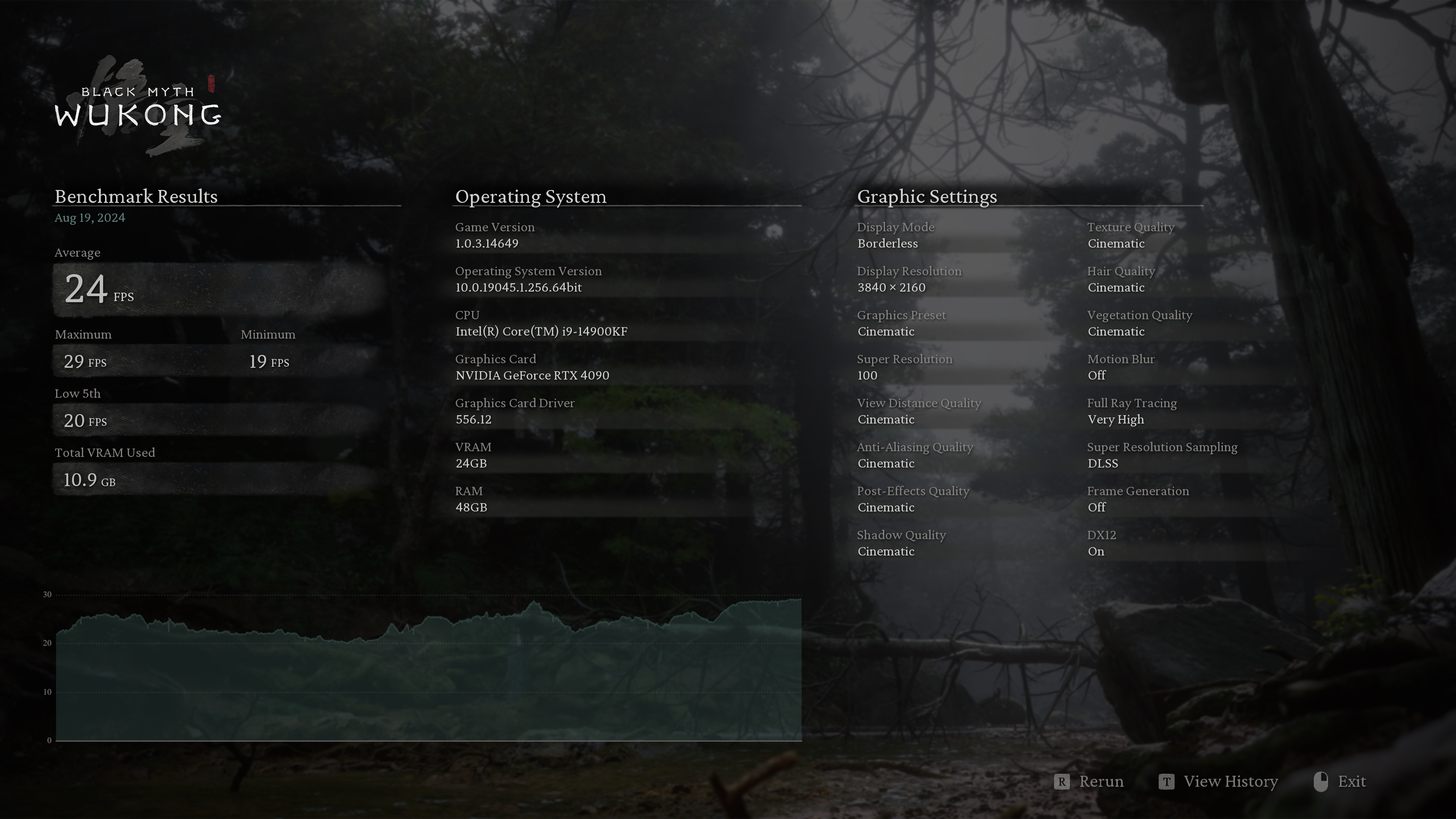

For comparison:
14900KF @ 59x-P, 48x-E, 52x Cache
Memory @ 8400 CL38
4090 Stock
Display @ 4K 144Hz
DLSS, RT On-Very High, Frame Generation On
00-Black-Myth-Wukong-Benchmark-DLSS-RT-V
DLSS, RT On-Very High, Frame Generation Off
01-Black-Myth-Wukong-Benchmark-DLSS-RT-V
DLSS, RT OFF, Frame Generation On
02-Black-Myth-Wukong-Benchmark-DLSS-RT-O
DLSS, RT OFF, Frame Generation OFF
03-Black-Myth-Wukong-Benchmark-DLSS-RT-O
FSR, RT On-Very High, Frame Generation On
04-Black-Myth-Wukong-Benchmark-FSR-RT-VH
TSR, RT On-Very High, Frame Generation On
05-Black-Myth-Wukong-Benchmark-TSR-RT-VH
XeSS, RT On-Very High, Frame Generation On
06-Black-Myth-Wukong-Benchmark-Xe-SS-RT-
DLSS SR 100%, DLSS, RT On-Very High, Frame Generation On
07-Black-Myth-Wukong-Benchmark-SR100-DLS
DLSS SR 100%, RT On-Very High, Frame Generation OFF
Max everything out and set Super Resolution to 66 to see how it stacks up to @tps3443 and my scores at the same settings.

Consistent here also..buttery smooth 4fps maxed..I prefer this cinematic experience. Goes to show what alot of advances in tech and obscene amounts of time can accomplish..all kidding aside it is actually a very consistent and accurate benchmark with great visuals. Not much difference from timespys accuracy.
The nice thing about 4 FPS is if you blink while watching you only miss one or two frames.
