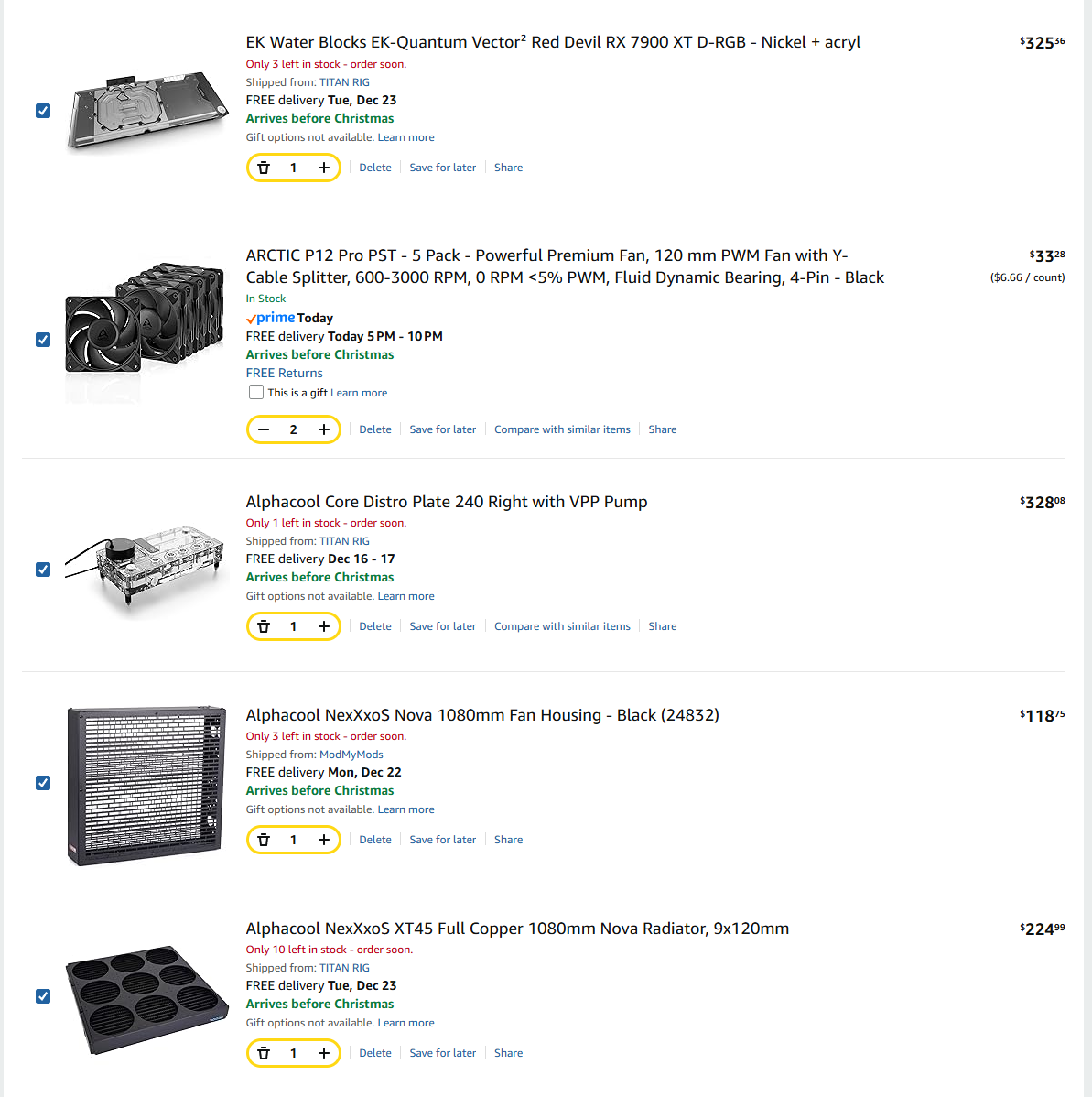

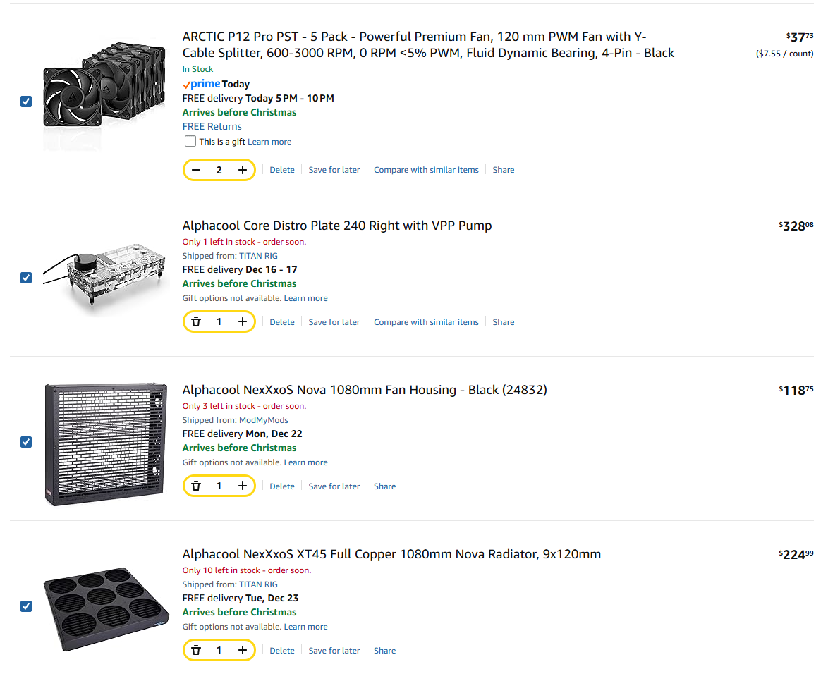

This is what I am looking at for the moment.
Looks like I wont be able to get in to me quite some time though...
Nice! That's going to really be awesome. You're much safer going that route than ordering it from a vendor outside of the US because of how incompetent the shippers are (or dishonest creeps) when it comes to grossly overcalculating tariffs. So many horror stories of victims being charged 2 or 3 times more than the actual tariff. There will be a special place in hell for the folks that do that. I believe it is intentional. but it could just be incompetence. You know they are not giving the "extra" money collected to the government, they are just padding their wallets with the excess collected "by accident" from consumers victims. :classic_angry:
This is pretty dang impressive.

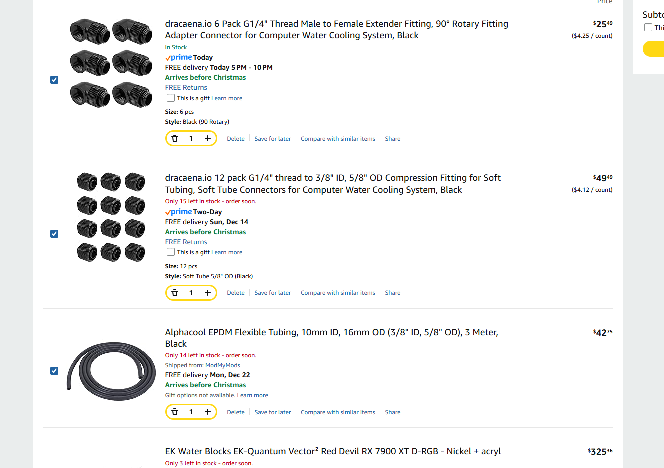

I always get confused on the tubing, I know I want flexible tubing.
What fittings and tubes should I go with?

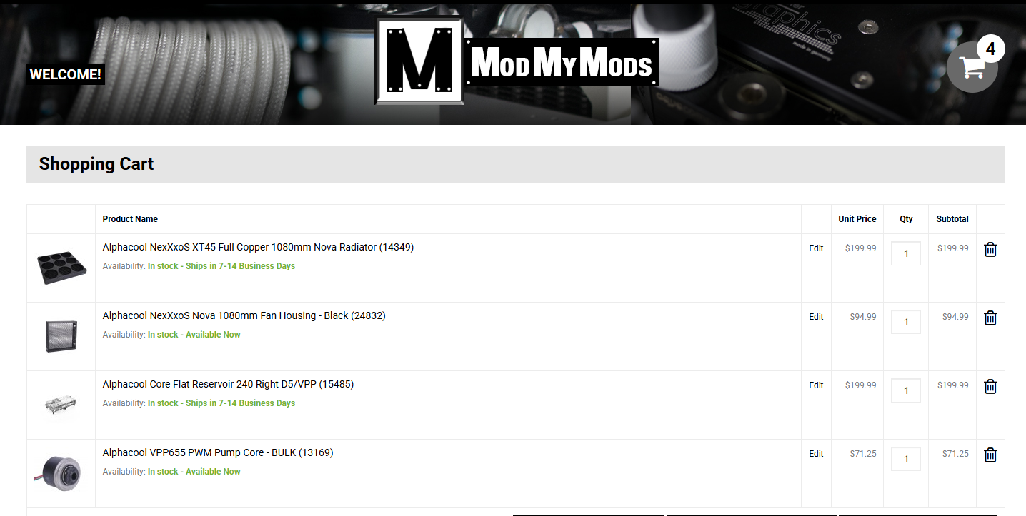

I found most of the same things on Amazon so it should arrive while I am on vacation. I'll see if I can find what I need on Amazon so its just one big order.
Sold my second tower tonight so most of this is bankrolled by that :) I did buy 2x 2697A v4's for my last tower (currently on 2650 V4's and also just got my Xeon Gold 6248's for the server I am building to replace the Dell's that I got fed up with.
Sold my second tower tonight so most of this is bankrolled by that 🙂 I did buy 2x 2697A v4's for my last tower (currently on 2650 V4's and also just got my Xeon Gold 6248's for the server I am building to replace the Dell's that I got fed up with.
I recommend ordering this for your radiator. You can attached a second D5 pump/res to the side of it. I had one and it was awesome. Alphacool NexXxoS Nova 1080mm Fan Housing - Black (24832)
You can get good compression fittings on Amazon. I have bought tons of them there. Paying extra for big-name compression fittings is silly. I would recommend using tubing that is 3/8" (10mm) ID, 5/8" (16mm) OD. For years I used 1/2" (13mm) ID, 3/4" (19mm) OD but in the last year or two moved down in size and see no drawbacks in terms of cooling or flow rate. The fittings and tubing are much easier to source and usually cheaper for the slightly smaller size. Clear tubing looks fantastic when it is new and that is what I used for years. After a year or so it starts to get cloudy. It is cheap to replace.
However, I recently started using the black EPDM tubing and like it. It looks nice and you don't have to worry about it getting cloudy. I never purchased it before because it was almost never in stock and when it was available it always twice to three times the cost of clear PVC tubing for the same length. I recently discovered that it is much easier to source in the 10/16 size and almost never available in 13/19 size. That is ultimately why I decided to go with 10/16 size tubing in EPDM.
Fair warning... EPDM tubing can be very difficult to source at times, and it is usually double the cost of clear PVC. When you can find it at a fair price and in stock, buy twice as much as you need so you don't have to try to find more later. As you can see, it is much cheaper to buy the 3 meter package than 3 x 1 meter.
Alphacool EPDM Tubing, 10/16mm, 1 Meter, Black
Alphacool EPDM Tubing, 10/16mm, 3 Meter, Black
Black Compression Fittings
Silver Compression Fittings
Don't forget an inline filter (on the pump output side) and male/female fittings you may need for your loop, along with any 90° rotary fittings you may need. I use these filters and they are awesome. You can take them apart to clean the filter screens. You can screw a compression fitting into each end of the filter.
Here are some miscellaneous fittings you may or may not need, depending on how you build things.
  • Male-to-female extenders (available in wide variety of lengths) example
  • Male-to-male extenders (available in wide variety of lengths) example
  • Female-to-female extenders (available in wide variety of lengths) example
The only exception I make on fittings is the EK Torque rotary fittings are the best. They do not leak and many of the cheap ones do not hold up. They cost more but you can use them for years without any leakage issue. The reason being is the rotary surfaces are huge and do not get loose. They are worth the extra money because of quality and long-term durability.
EKWB EK-Torque 90 Degree Angled Rotary Fitting, Nickel, 2-pack (They are available in 90° and 45° versions.) These sell out often. Buy extras if you can, like the EPDM tubing. If you need more later you might find them unavailable or grossly overpriced.
For years I have used automotive antifreeze in my systems. It lubricates and does not allow organic growth. If you used distilled water, buy some Mayhems Hades Plus and Mayhems Inhibitor. The cost is about the same if you purchase inexpensive antifreeze from Walmart. I prefer the blue Asian type. The normal green type is OK if you prefer green over blue. The yellow/gold antifreeze does not look good to me in a loop. It looks like urine, LOL. My advice is, do not waste money on premixed bottles of coolant. They work fine, but cost way too much and provide no tangible benefit. Since you are using a distro plate with the pump, I recommend going with the distilled water and both Mayhems additives so it does not stain the acrylic distro block. You can clean it up, but who wants to disassemble a distro block for that if you can avoid having to.
You can buy this in a pack that includes one bottle of each. It seems expensive, but it is not. You use about 9 drops of each in a one gallon jug of distilled water. There is enough for about 4 or 5 gallons. Mayhems - Water Cooling PC Coolant Additive - Hades Plus and Inhibitor Plus - Complete System Protection, 15 ml (This is actually cheaper than antifreeze because distilled water is around $1.00 per gallon at Walmart and 5 gallons of the cheapest antifreeze will cost more than distilled water plus the Mayhems additives.)
Last comment... buy silver/nickel fittings versus black. You will thank me. Ask me how I know. The black fittings scratch easier and also slowly deteriorate internally and add flecks of black crap to your loop. Black fittings looks great, but the aesthetic is not a good trade-off for the benefits of the silver fittings. You don't want your filters or waterblock jet plates collecting the black particles from the fittings.

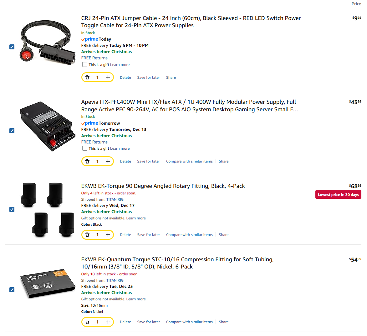

59 minutes ago, Mr. Fox said:
I recommend ordering this for your radiator. You can attach a second D5 pump/res to the side of it. I had one and it was awesome. Alphacool NexXxoS Nova 1080mm Fan Housing - Black (24832)
@Reciever - another tip. Buy yourself a cheap black window screen kit from Home Depot, Lowes or Amazon. You can get a kit with black fiberglass screen and black frame, 90° corner adapters, spline and roller tool. Cut the frame to fit the outer dimension of the radiator housing. Use adhesive magnet strips (from Amazon) on the radiator-facing side of the screen frame to attach it to your radiator as a dust filter. You would be amazed about how much cleaner the radiators and fans will be using the screen as a filter, and it looks perfect... like a factory-made filter. When it gets dirty, you clean it in a matter of seconds with a Swiffer duster or vacuum cleaner.
I recommend buying flat magnetic strips. The rolled magnetic strips try to curl and do not stick to the aluminum screen frame nearly as well. Use Gorilla or 3M heavy-duty rubber mounting tape if the sticky stuff on the magnetic strips doesn't hold over time. (It usually ends up coming loose, but the rubber mounting tape is nearly impossible to remove once the magnets are stuck in place if you clean the aluminum frame thoroughly with alcohol.)
Does this more or less cover all the bases? Thanks again @Mr. Fox!
Yes, you should be good to go. If you can afford it, buy the EKWB 90° rotary fittings, as they are more durable.
I edited my posts above several times so you may have been shopping between edits. I mentioned the disadvantage of black fittings and suggested a filter (with a link).
Edit - @Reciever you may already know this, but on the chance you do not, your flat reservoir cannot be used with the D5 pump facing the ceiling. It has to be used either vertically or with the pump facing the floor or it will hold air and burn out the pump.
Absolutely lol. Those cheaper 90's will leak. I have seen some brand-new one's leak if any sideways pressure is applied due to weight of a hose or something, and the swivel gets STIFF. The last time I had one leak, I found a small puddle on the back of my 5090FE when it was on air cooling. The scary thing is, I am still using some of them in my build in random places lol. (Those have not shown any signs if
leaking and my loop fortunately holds air, but if I could go back I probably would not have used the cheaper 90’s)

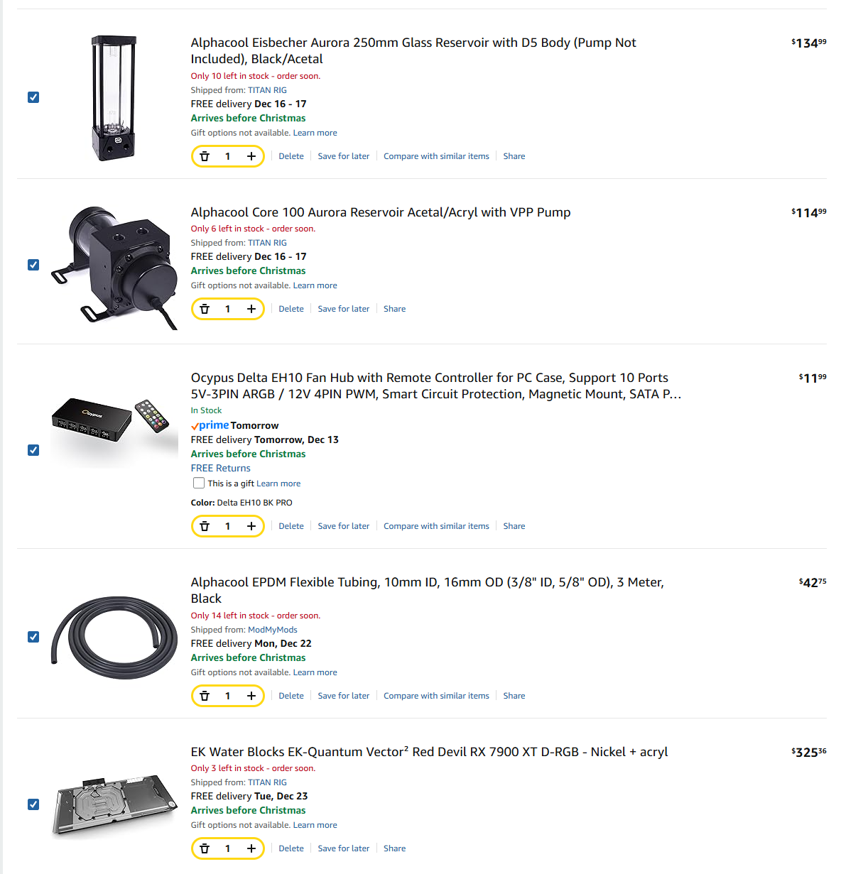

@Reciever Maybe add another pump D5 with the basic top only in the near future in case one fails. The extra pressure and flow allow you to not depend on running 1 single pump at 100% for good performance. Those big rads like flow. Then you can run more pumps and lower speeds or on a PWM profile. Mine are setup where all (4) pumps fall to 20% speed when the CPU is below 50c. If CPU goes over 50c, it means my GPU is pushing some frames, or I am running a load lol.
With 1 pump, you can run it on the auto/lower PWM RPM, let the water temp reach equilibrium under a full system load, then unplug the pumps PWM, the pump will shoot up to max RPM or max flow rate. You will then see the temps drop on all of your components. This alone tells us more flow will be beneficial. My system still does this with (4) pumps all running at a lower speed on auto with PWM plugged in. Then if I crank them to 100%, I will see everything fall in temps.
That's a nice kit you have assembled in the cart though!
I agree with the suggestion of adding a second pump. You can mount it to the side of the 1080 housing.
Either of these are excellent options for that. I own both. The second option includes a pump and you can mount it on the side with fittings, beteen the top and bottom radiator ports. The larger option needs to be mounted to the side of the housing that does not have fittings.
Alphacool Eisbecher Aurora 250mm Glass Reservoir with D5 Body (Pump Not Included), Black/Acetal
Alphacool Core 100 Aurora reservoir Acetal/Acryl with VPP Pump (I recommend this option and mounting in between the top and bottom radiator ports. That's where I mounted mine.)
You can power the external pumps and fans with an ITX PSU. Just use a jumper on the 24-pin motherboard cable.
This is what I used and it was good.  Apevia ITX-PFC400W Mini ITX/Flex ATX / 1U 400W Fully Modular Power Supply, Full Range Active PFC 90-264V, AC for POS AIO System Desktop Gaming Server Small Form Factor (Flex ITX) Computer PSU
You can attach it to the blank side of the radiator housing if you use the Core 100 on the side between the top and bottom fittings. Alternatively, you can use one of these to runs the fans and pumps, but will need to solder a molex connector to the end. I have one on my chiller to run the two pumps and it works great.
@Reciever - you need a way to distribute power the fans that is not too messy and is electrically sound. I recommend that you get one of these for your 9 radiator fans and you can control speed using the remote. I have several of these and they work fantastic (pun intended). You can use SATA power from the PSU mentioned above. I do not use motherboard fan headers or RGB headers. (Using motherboard RGB headers sucks because you need software garbage to control the lights and motherboard fan headers required farting around with software or BIOS settings. This device solves both of those really crappy problems.)
Edit - @Reciever you may already know this, but on the chance you do not, your flat reservoir cannot be use with the D5 pump facing the ceiling. It has to be vertical or with the pump facing the floor or it will hold air and burn out the pump.
 So as long as I keep the radiator standing up-right, should be fine?
Also, running 2 pumps?
Should I just get 2 Core 100's, Eisbecher res and remove the distro plate?
Current list as-is, is that enough fittings?
The distro plates are nice if you are using a case. If you are not, then just skip it and do a couple of Core 100 unit that include the pump and save your money. Pumps can be horizontal or pump down (toward floor) but never pump toward the ceiling. They can be anywhere in the loop but work best on the radiator output side, or one (or more) on the cold output (high pressure side) and one on the retun side. Generally speaking, you do not want all of the pumps between the PC and radiator on the return (hotter and lower pressure) line.
Stop and visualize the layout. Grab a paper and pen and sketch it out to plan how many fittings you will need. You will need at least two compression fittings for each joint: 2 per hose on each pump, 2 for each radiator, 2 for each filter.  2 for the CPU block. 2 for each GPU block. In terms of 90° or 45° fittings, that will depend on how your build is designed. You will probably want 2 90° fittings for the GPU block. You will likely want at least one for each pump. You will probably want a minimum of 4 of these. In a close case you would likely want more because of sharp turns. They are not necessary for anything other that having a tidy build or if you need to make a sharp turn without kinking the tubing. Air will collect in the highest point of the loop. The reservoir at the place with the most pressure in the loop will overflow with the plug removed.
More often than not, this high pressure point will be where water first enters the computer, at either the GPU or CPU block. The lowest pressure will usually be on the return (hot) line leaving the PC and returning to the radiator. Watch when you fill the loop and see which one empties and which one fills up first, the disconnect power from the pump that overflows and leave the plug in until the loop is full. Once the loop is full, reconnect power to it.
Set everything up on your table or desk before cutting the lines. Place the case/bench where you want it and the radiator where you want it. This can also help you plan how many fittings you need. Make sure it is satisfying and convenient how everything is placed. Only then should you start cutting the tubing. (This would apply to any setup you build.) You can use a razor blade or scissors, but a cheap tubing cutter works best to make quick, straight and clean cuts. It is better to overestimate the length by an inch or two than to make a line too short. You can trim things down but once you cut the line it can never be longer. The old cliché, "measure twice, cut once" applies here as well as carpentry.
Building a custom loop for the first time is expensive, but the parts (other than tubing) will generally be very durable and last many years. You only need to buy most of these things once and use them more or less forever. Most of my D5 pumps have lasted me 5 to 10 years. (DDC pumps are not very durable in comparison.) NEVER power up the loop dry. Without water in the loops the pumps will burn up very fast. EPDM tubing will probably last forever as well. Black silicon tubing also works as well as EPDM rubber, but it is softer than rubber and will kink easier if there is a sharp turn. (They use it for brewery equipment.) As long as the dimension are correct and work with the fittings, you can also use automotive heater hose or fuel line tubing, or bulk PVC tubing (from Home Depot or Lowes) if aesthetics are irrelevant. Those generally have writing printed on them for identification purposes and don't look very nice and are usually very stiff, but functionally work the same.
You will learn a lot and have fun. Even the thought of using air cooling has become repulsive to me at this point. The only regrets I have ever had in custom loop building are:
  • Purchasing a DDC pump (D5 are much better)
  • Purchasing black fittings (for reasons mentioned before)
  • Failing to use at least one filter in the loop

15 hours ago, Mr. Fox said:
If you purchase the housing it does but the radiator itself does not. Be sure you buy the right housing. The UT60 radiator will not fit a UT45 housing.
Sorry I did not see the posted question earlier.
