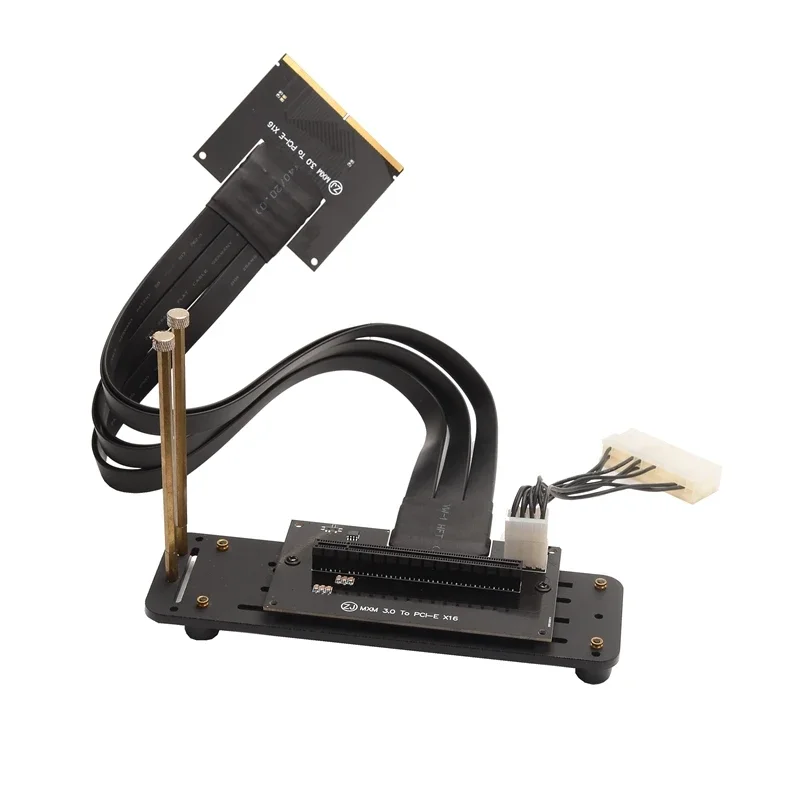

652mod Posted April 27 Posted April 27 2 minutes ago, SuperMG said: No you can't do anything. I asked for modders to find the solution for that for the X7200 but no one answers, it's a lost cause. I was able to do HD 7970M (green PCB, no audio) + RTX 3000 and it worked. I was losing a bit of performance maybe because my CPU wasn't Overclocked. Hmm... what about one of those weird mxm to pcie egpu adapters?
652mod Posted April 27 Posted April 27 2 minutes ago, momo25 said: Hmm... what about one of those weird mxm to pcie egpu adapters? Cuz I wanna have a reason to keep it, its a great machine ^^
SuperMG Posted April 27 Posted April 27 7 minutes ago, momo25 said: Hmm... what about one of those weird mxm to pcie egpu adapters? Anything newer that's plugged in the master MXM slot of the LVDS laptop won't work. GTX 770M, 780M, K3100M, K5100M, 880M aren't working too! Yes you can use eGPU from the ExpressSlot but the speed is at PCIE 2.0 x2, it's worse than the slave MXM slot which runs at x8. For some reasons, the X8100 accepts GTX 980M, M5000M, 780M, etc...
652mod Posted April 27 Posted April 27 11 minutes ago, SuperMG said: Anything newer that's plugged in the master MXM slot of the LVDS laptop won't work. GTX 770M, 780M, K3100M, K5100M, 880M aren't working too! Yes you can use eGPU from the ExpressSlot but the speed is at PCIE 2.0 x2, it's worse than the slave MXM slot which runs at x8. For some reasons, the X8100 accepts GTX 980M, M5000M, 780M, etc... I heard from another user its x16 2.0?
SuperMG Posted April 27 Posted April 27 7 minutes ago, momo25 said: I heard from another user its x16 2.0? ExpressSlot uses less bandwidth than the MXM slot. I do not recommend any eGPU configuration as you need an external power and your desktop GPU will get severely bottlenecked by the bandwidth. mPCIe is faster than ExpressSlot by not a lot too. MXM slot = 2.0 x16 SLi in use = 2.0 x8 Just get a Clevo X8100 instead.
652mod Posted April 27 Posted April 27 12 minutes ago, SuperMG said: ExpressSlot uses less bandwidth than the MXM slot. I do not recommend any eGPU configuration as you need an external power and your desktop GPU will get severely bottlenecked by the bandwidth. mPCIe is faster than ExpressSlot by not a lot too. MXM slot = 2.0 x16 SLi in use = 2.0 x8 Just get a Clevo X8100 instead. Nah, wanna keep my d900f. The x8100 has a mobile cpu. This adapter claims to use full x16 bandwidth
652mod Posted April 27 Posted April 27 1 minute ago, momo25 said: Nah, wanna keep my d900f. The x8100 has a mobile cpu. This adapter claims to use full x16 bandwidth I mean, sure its bottlenecked but it will be anyway by the first gen i7 even the 990x so wouldnt mean that much.
SuperMG Posted April 27 Posted April 27 (edited) 2 hours ago, momo25 said: I mean, sure its bottlenecked but it will be anyway by the first gen i7 even the 990x so wouldnt mean that much. I already told this won't work. The BIOS is so wacky and strange, it'll accept max GTX 680M or HD 7970M in the master slot. Clevo made the worse bios ever for X7200, D900F and P170HM... Anything new won't work. I already tried on the X7200. For some reasons the Maxwell cards in master slot work for Clevo M980 and X8100. Edited April 27 by SuperMG
