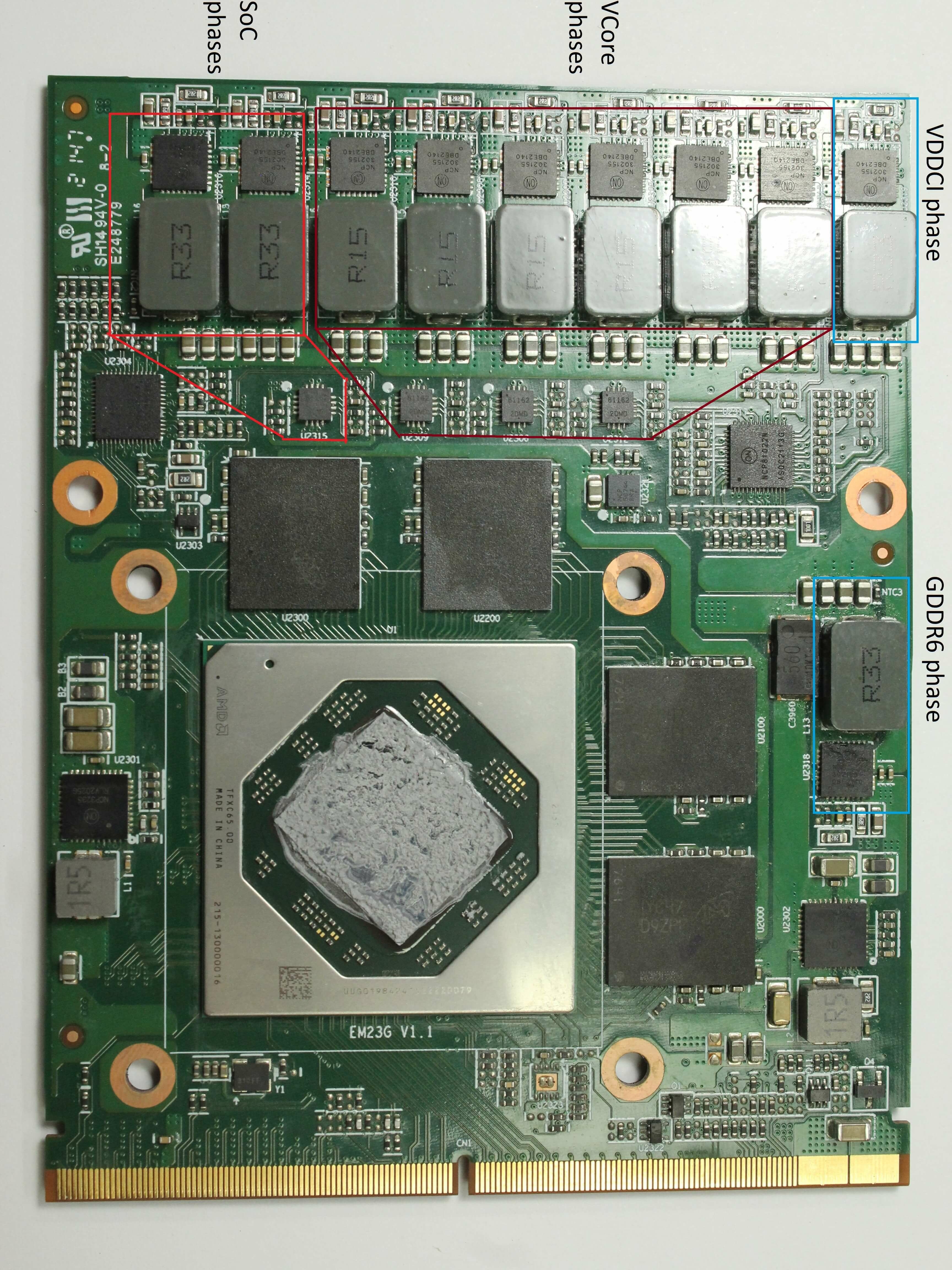

Will Posted December 11, 2025 Posted December 11, 2025 What about AMD cards? Do you know if it's the same thing? Your FPC cable would also be necessary and work? I have a Dell Precision 7720 and i'm planning on maybe upgrade its GPU to a RX 6600, specifically this one: It comes from a Thunderbolt eGPU dock and looks identical to the X-VSION card (has display port on DP A, B, C and D). Do you have any ideia if it might work? Thanks in advance
Chalybion Posted December 11, 2025 Posted December 11, 2025 38 minutes ago, Will said: Do you have any ideia if it might work? Thanks in advance Physically, the RX6600 VRAM is much closer to the GPU than the Dell MXM designs. You will need thin thermal pad strips to level the heatsink surface around where it contacts the GPU die. The VRAM will mostly contact aluminum, not copper, so they will run hotter. The right-side R33 and 1R5 components don't exist on Dell MXM designs, so the heatsink may not clear them without shimming or physical modification. Heatsinks are $20, so get one to test 🙂 Precision 7520 / Xeon E3-1535m v6 / 32 gb DDR4 2666 MHz CL15 / GTX 1650 Mobile / LP156QHG-SP(V1) Precision 7540 / i9-9980HK / 32 gb DDR4 2666 MHz CL15 / RTX 4000 / LP156QHG-SP(V1) / Delta Fans
SuperMG Posted December 12, 2025 Author Posted December 12, 2025 5 hours ago, Will said: What about AMD cards? Do you know if it's the same thing? Your FPC cable would also be necessary and work? I have a Dell Precision 7720 and i'm planning on maybe upgrade its GPU to a RX 6600, specifically this one: It comes from a Thunderbolt eGPU dock and looks identical to the X-VSION card (has display port on DP A, B, C and D). Do you have any ideia if it might work? Thanks in advance You need to obtain the datasheet of this card. If pin 23, 25 and 27 are disabled, you need the flex FPC cable mod. Make really sure eDP/DP is on DP_D. RTX 4070 MXM is better and works on 7720.
