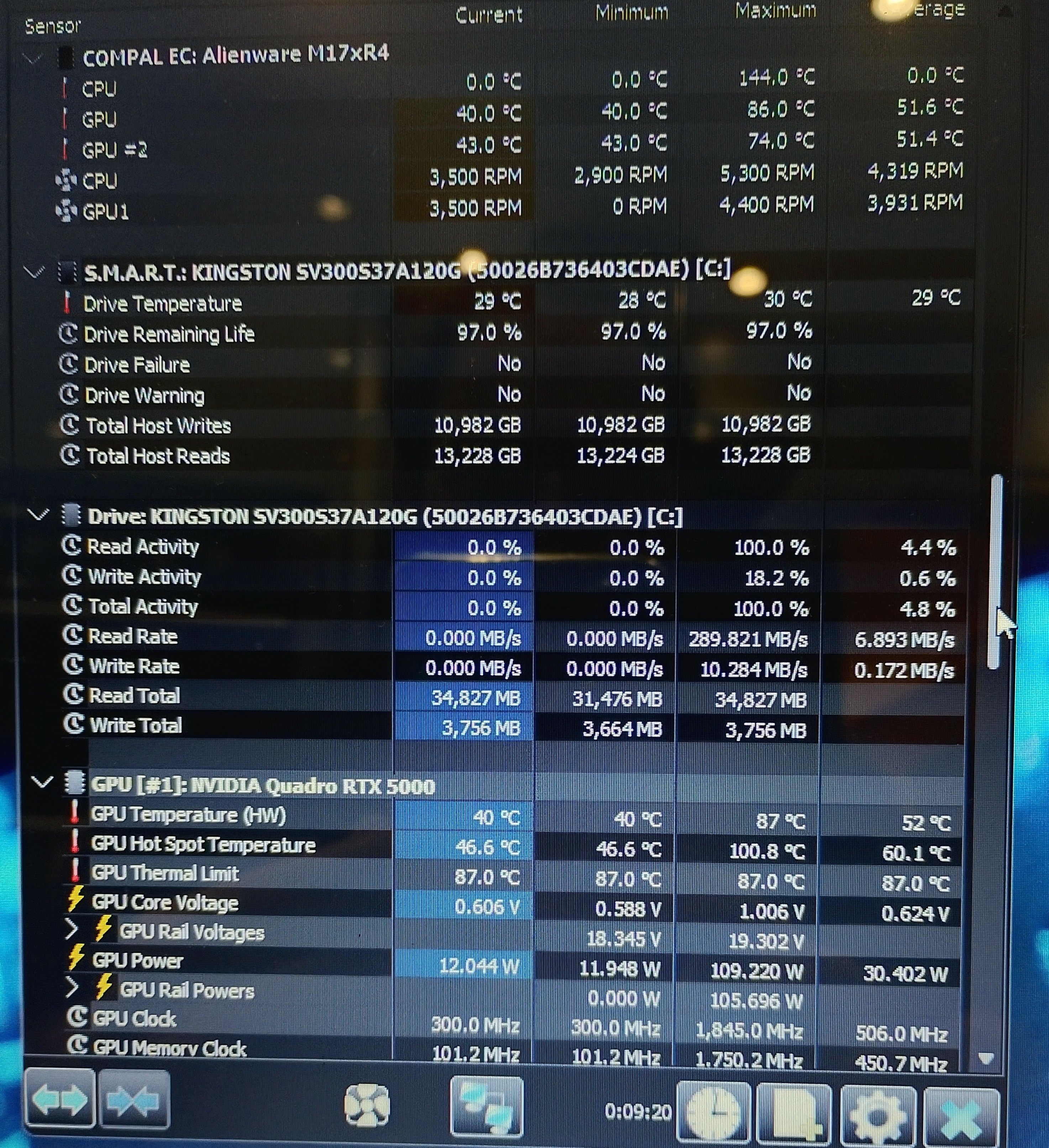

Ollie87 Posted January 16 Author Posted January 16 Hi all, having power delivery issues I think, running on max settings for example on dead by daylight 2 with ray tracing enabled I should be getting around 55 FPS, shortly after the drivers crash then causing the GPU to show 0C in hw info. I will look to downclock and reduce the millivolts but MSI afterburner is a bastard to get the controls unlocked. Does anyone have any knowledge to shed on this ? Didn't have as much problems with the Rtx 3000
Ollie87 Posted January 17 Author Posted January 17 so far had no luck bypassing locks on MSI afterburner, i can only assume its to do with the vbios on the quadro rtx 5000, voltage remains locked on afterburner, if anyone has any ideas please let me know, i will look to try in a few games today to see if this is viable, temps seem ok, i have since used a grizzly thermal strip, my idle temp with increased fan is around 45c - 49c - under load around 76 to 82c, i may swap it out to grizzly thermal paste as im sure i was achieving lower temp with paste. i have since removed silicon pads and used silicon paste instead, i did however notice the wattage on the card must of spiked to 114watts under high load, so im now wondering if its the spike causing the instability at higher graphical settings. if this continues i may have to accept defeat and change the card back to the rtx 3000 😮💨
Ollie87 Posted January 17 Author Posted January 17 ok, tried a different game - looks like i never reached the thermal limit but i get a game crash when playing into the game, i do have a feeling the power delivery must be the issue at hand i think...
Jerryzago Posted January 17 Posted January 17 I can assume by your experience, the GPU hits it's thermal limit and shuts of. It stops sending power to the core, leaving you with the internal GPU, thus you have 0 degrees showing at HWinfo. Meaning the GPU is absent from the system. I am not sure, but since you had a 980m, the heatsink is the 100watt one? Alienware M18x R2 / i7 3720qm -> i7 3940XM / Dual 7970m -> 980m SLI -> HP Quadro RTX 3000 Alienware 17 R1 / 4710MQ -> 4930mx / 880M GTX -> PNY Quadro RTX 3000 HP 8570w / i7 3820qm / Quadro K2000M HP DV6500 / i7 T7200 -> i7 T9500 / 2GB RAM -> 4GB RAM / Atlas OS
Ollie87 Posted January 18 Author Posted January 18 Hi all, having power delivery issues I think, running on max settings for example on dead by daylight 2 with ray tracing enabled I should be getting around 55 FPS, shortly after the drivers crash then causing the GPU to show 0C in hw info. I will look to downclock and reduce the millivolts but MSI afterburner is a bastard to get the controls unlocked. Does anyone have any knowledge to shed on this ? Didn't have as much problems with the Rtx 3000. The heatsink from memory is the one that was on the 660M, I can see the difference between that and a photo of the 100 watt rated version, I have considered ordering a full copper heat sink maybe that would reduce the heat or potentially getting a LLyano V12 laptop cooler, I have just changed drivers to the enterprise drivers and will test. Haven't tried with the edp and 2k panel el yet untill I know the card works ok, don't want to start a new head ache just yet 🤣
