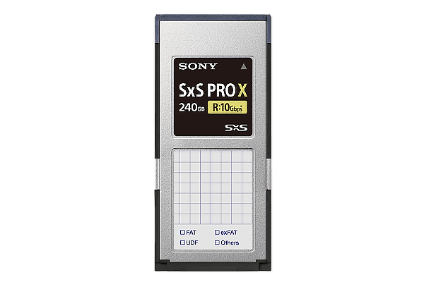

Has anyone heard about Sony SxS Express card series?
Sony's SxS express card supports up to 1TB and 1.4GB/s file transfer speed.
I think this may work on M4800's express card slot.
