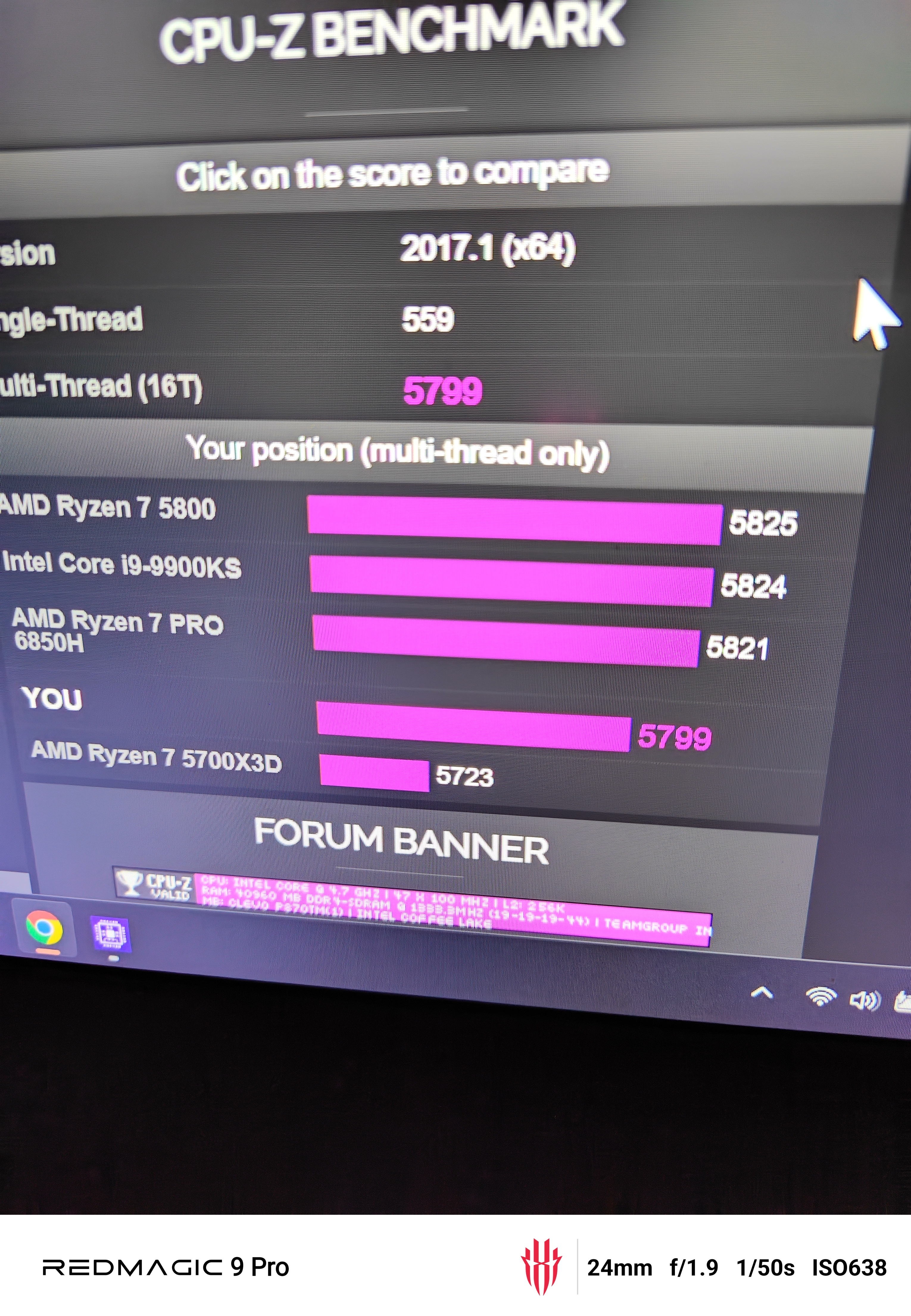

zerokool Posted July 16, 2025 Posted July 16, 2025 Still testing but getting better scores . At 5 ghz the single core is a bit above 600 but puts out to much heat lol .
zerokool Posted July 16, 2025 Posted July 16, 2025 Just now, zerokool said: Still testing but getting better scores . At 5 ghz the single core is a bit above 600 but puts out to much heat lol . My plan is to de lid the CPU . Put better compound on it and 5ghz all core . Regardless the QTJ1 is still a nice CPU

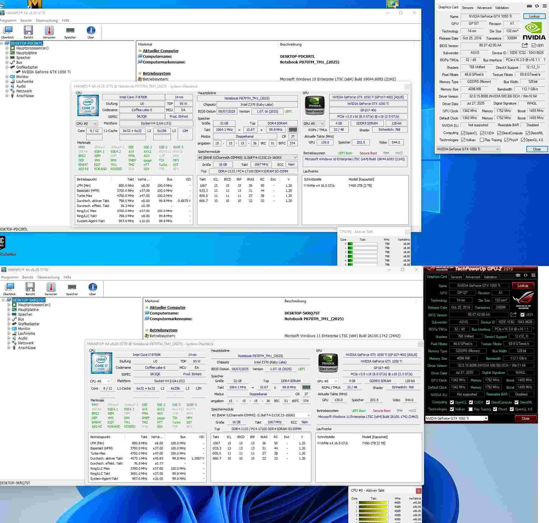

Developer79 Posted August 7, 2025 Posted August 7, 2025 Hello P870xx/TM-Friends, here my last Updates for P870TM-Bios with my Desktop-Extension for Win10/11. All works perfectly... 2
