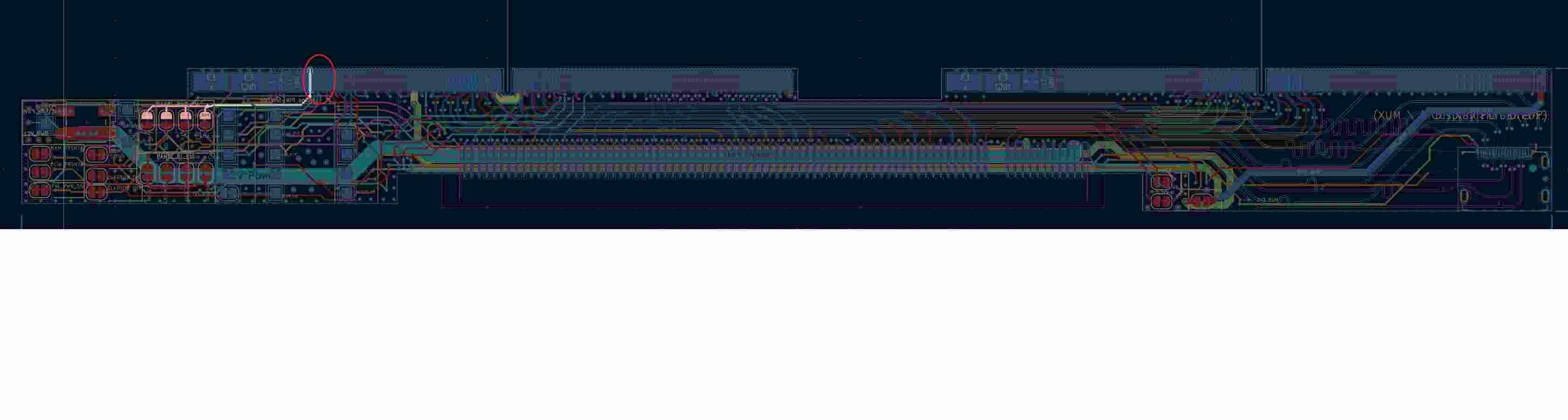

SuperMG Posted August 20 Share Posted August 20 59 minutes ago, Developer79 said: Hi, Yes, you're right! The adapter I developed also uses this pin assignment. I can control everything via jumpers on my board! Pins 23/25 are simple jumpers for switching on, and pin 27 is pulse width modulated. However, I found out during my tests that this pin is not necessary. In the picture, you can see how I have taken the PINs into account on my board! Greetz Yes but my screen is an eDP display, my Quadro P5200 and Quadro RTX 3000 have these pins I guess, otherwise that's why the RTX 4070 MXM doesn't work. I don't see the screen powering on, on my laptop. However with a compatible card, first the screen backight powers on and then the video signal is out. ZRT saw my messages but didn't even reply... Does the RTX 3080 from clevo have these PANEL pins? Link to comment Share on other sites More sharing options...

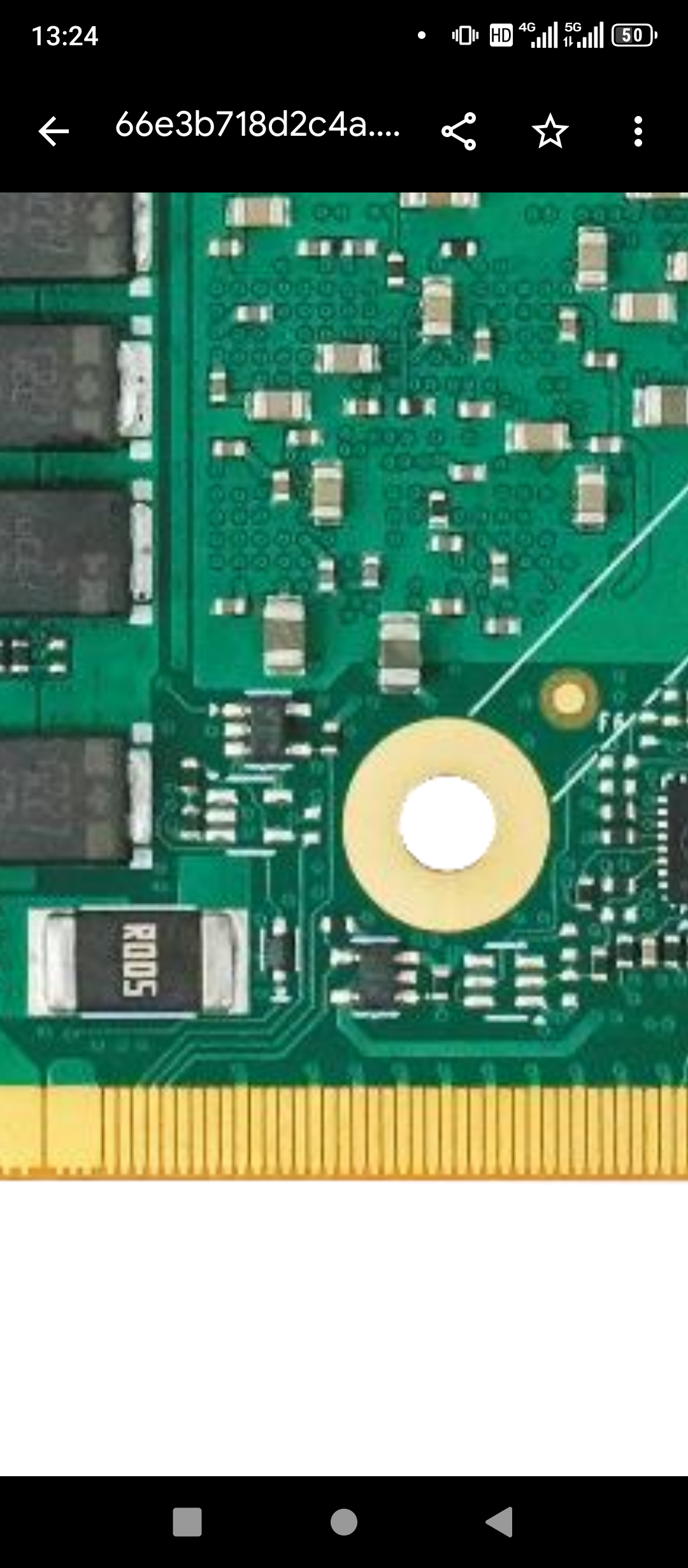

SuperMG Posted August 20 Share Posted August 20 2 minutes ago, Developer79 said: eDP pins are fixed, so the display power-on pins are also supported! You can see this in the pictures! Yes the DP_D are fixed. I looked and saw 3 pins on the back of the PCB. I hope these are the PANEL pins. They have electrical lines but they are missing some IC and capacitors... I think the lines are here but not connected I suppose? Link to comment Share on other sites More sharing options...
Developer79 Posted August 20 Share Posted August 20 17 minutes ago, SuperMG said: Yes the DP_D are fixed. I looked and saw 3 pins on the back of the PCB. I hope these are the PANEL pins. They have electrical lines but they are missing some IC and capacitors... I think the lines are here but not connected I suppose? You need to take a closer look at the back. Of course everything is routed. If it's routed, it works! 1 Link to comment Share on other sites More sharing options...
SuperMG Posted August 20 Share Posted August 20 (edited) 1 hour ago, Developer79 said: You need to take a closer look at the back. Of course everything is routed. If it's routed, it works! Hello here is a picture. (Updated picture) Edited August 20 by SuperMG Link to comment Share on other sites More sharing options...

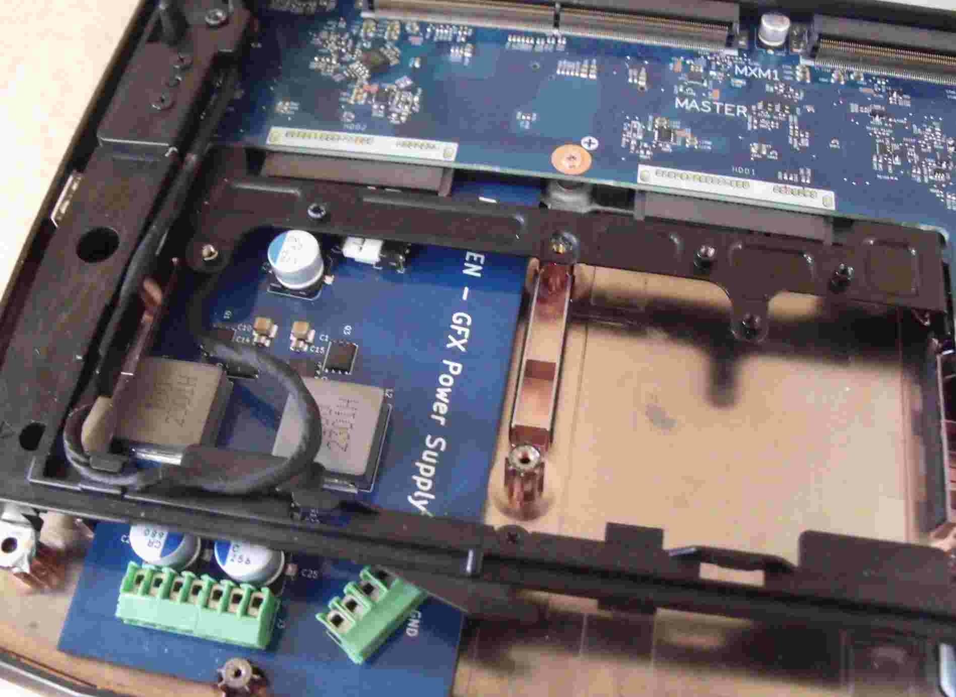

Developer79 Posted August 20 Share Posted August 20 On 8/20/2025 at 3:01 PM, Kastner said: Is this adapter available for sale or you made for yourself? Also how do you manage to power the GPU? Yes, I developed everything myself for the P870TM. It also works for the other P870xx models except for the P870DMG. Good question about the power supply. I developed a power board to supply 12V. Everything runs internally via graphics card power supply for the GTX1080 SLI series for the P870xx at the time. I also have pictures of the installation and with my development tool. Then the laptop can be locked and used as built by Clevo. Link to comment Share on other sites More sharing options...

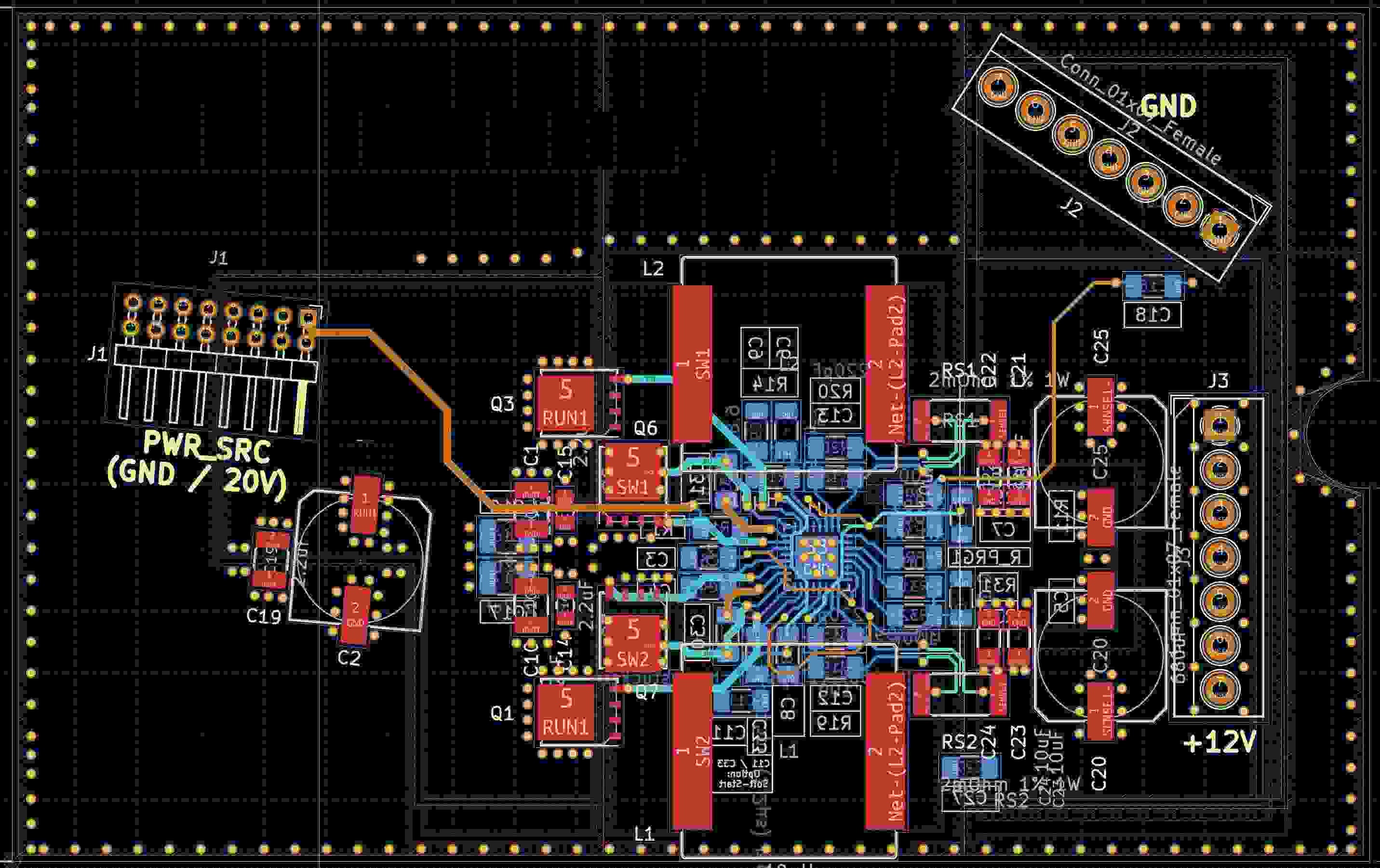

SuperMG Posted August 20 Share Posted August 20 12 hours ago, SuperMG said: Hello here is a picture. (Updated picture) Damn, this looks hard. I suppose PWR_SRC is where you get the power from the mobo/PSU connector, correct? Did you also see my picture? Do you see what's wrong with pin 23, 25 and 27? Link to comment Share on other sites More sharing options...
Developer79 Posted August 20 Share Posted August 20 7 minutes ago, SuperMG said: Damn, this looks hard. I suppose PWR_SRC is where you get the power from the mobo/PSU connector, correct? Did you also see my picture? Do you see what's wrong with pin 23, 25 and 27? Yes, but everything is original in your project with the 4060 MXM. No, the pin assignment looks normal. Link to comment Share on other sites More sharing options...
SuperMG Posted August 20 Share Posted August 20 3 minutes ago, Developer79 said: Yes, but everything is original in your project with the 4060 MXM. No, the pin assignment looks normal. But... On the schematics it's says N/A on 3 of the pins. Pin 25, has a missing component and it's for the PNL_BL_EN. I don't even know if the PWM pin is complete or no, I see some missing components next to it. Pin 23 looks normal I guess? If you're saying everything is normal, then why these type of cards like X-VSION, doesn't work with my eDP display? But the Quadro RTX 3000 from HP works... Link to comment Share on other sites More sharing options...
Kastner Posted August 21 Share Posted August 21 7 hours ago, Developer79 said: Yes, I developed everything myself for the P870TM. It also works for the other P870xx models except for the P870DMG. Good question about the power supply. I developed a power board to supply 12V. Everything runs internally via graphics card power supply for the GTX1080 SLI series for the P870xx at the time. I also have pictures of the installation and with my development tool. Then the laptop can be locked and used as built by Clevo. This is a truly amazing work! It is a next level of modding.. If this development complete that make MXM cards for P870 series dispensable. I have a few more questions if you willing to give away your development info. What is the output wattage of your DC-DC? Could you use 2 DC-DC powering one from the master and the second from the slave? So you can have two 8 pin 150W. The vapour designed for two 1080 with almost 400W in theory could it work with desktop card? What about the big ones(4080/4090 and 5080/5090) with the 12VHPWR? Do you planning to make a PSU for them or these are using too much? Do you planning to make your own DP to eDP converter to use the internal screen? Clevo P870DM2 9900k GTX1080 Clevo P775TM1 9700k RTX3070 Link to comment Share on other sites More sharing options...
