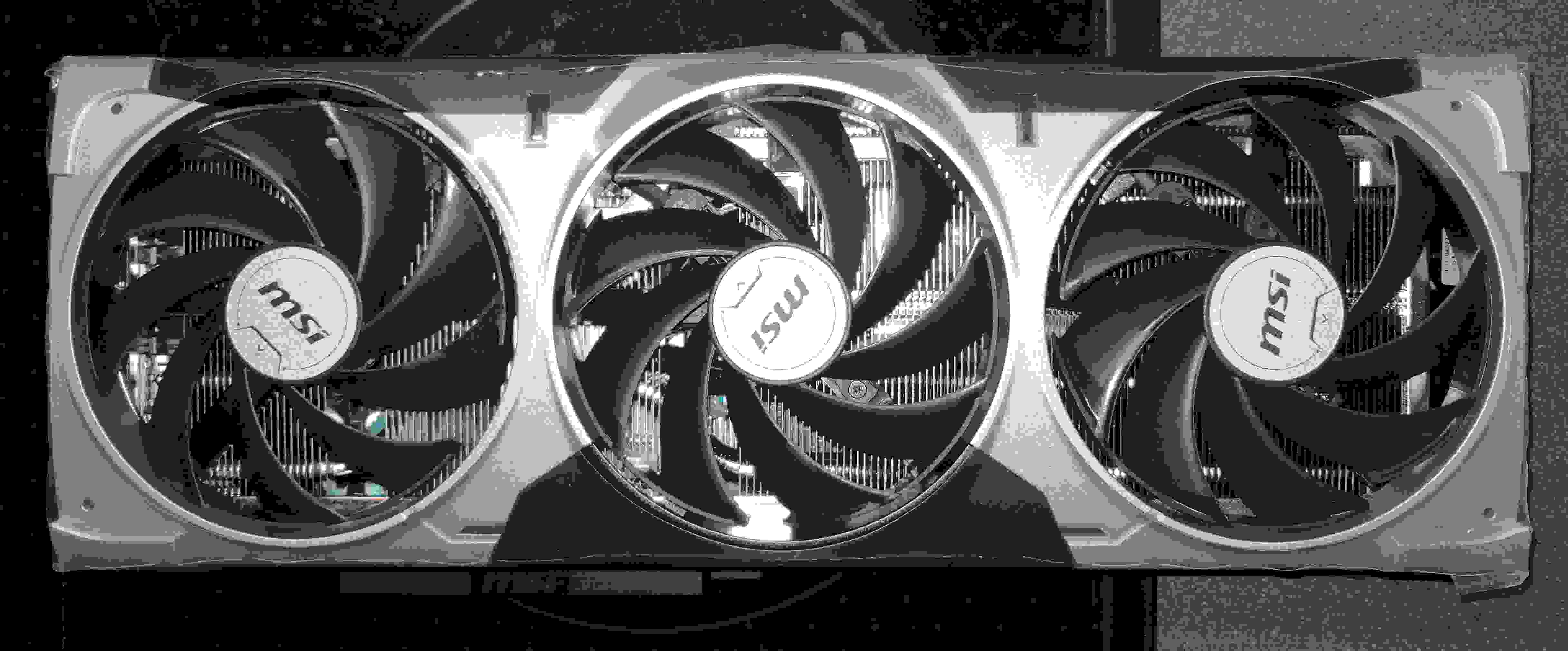

Developer79 Posted February 10 Posted February 10 On 2/5/2026 at 9:44 AM, Czaker said: Hi, as I said, the RTX 5070Ti Ventus is on its way to you. I believe this will accelerate your wonderful project and extend the life of the P870 for many more years! I heartily encourage you to support the Developer79 project! It's doing something laptop manufacturers don't want and probably never will do with laptops. Best regards. Dariusz Hello Darius, Thank you very much again for your help with the graphics card. It has now arrived and looks like new!!! Now I can build it in peace and implement this card in the P870xx. 1. I'll measure the PCB for the DisplayPort channels and route the cables. 2. Design the brackets for the card. 3. Develop cooling—water or vapor chamber. Let's see what ideas I come up with. Best regards, Ralf 1 1
