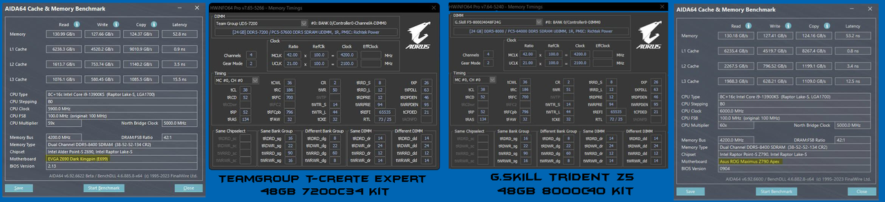

Just finished up some memory testing on the Strix Z790i.
I think this board has potential but I'll need to dial in the CPU at 8000 to see
how it compared to the MSI then switch back to the MSI and rerun all these tests
but in the end it is going to be 6 of 1...half a dozen of the other methinks.
I did single sticks and then dual sticks.
Conclusion:
Slot A taps out at 8800 for posting
Slot B taps out at 8600 for posting
G.Skill sticks:
Stick A  was able to post up to 8800 in slot A
Stick A was able to post up to 8600 in slot B
Stick B was able to post up to 8400 in slot A and B
Both sticks posted at 8400 (MSI only posted at 8200)
A+B = only pass TM5 at 7600
B+A = able to pass TM5 at 8000

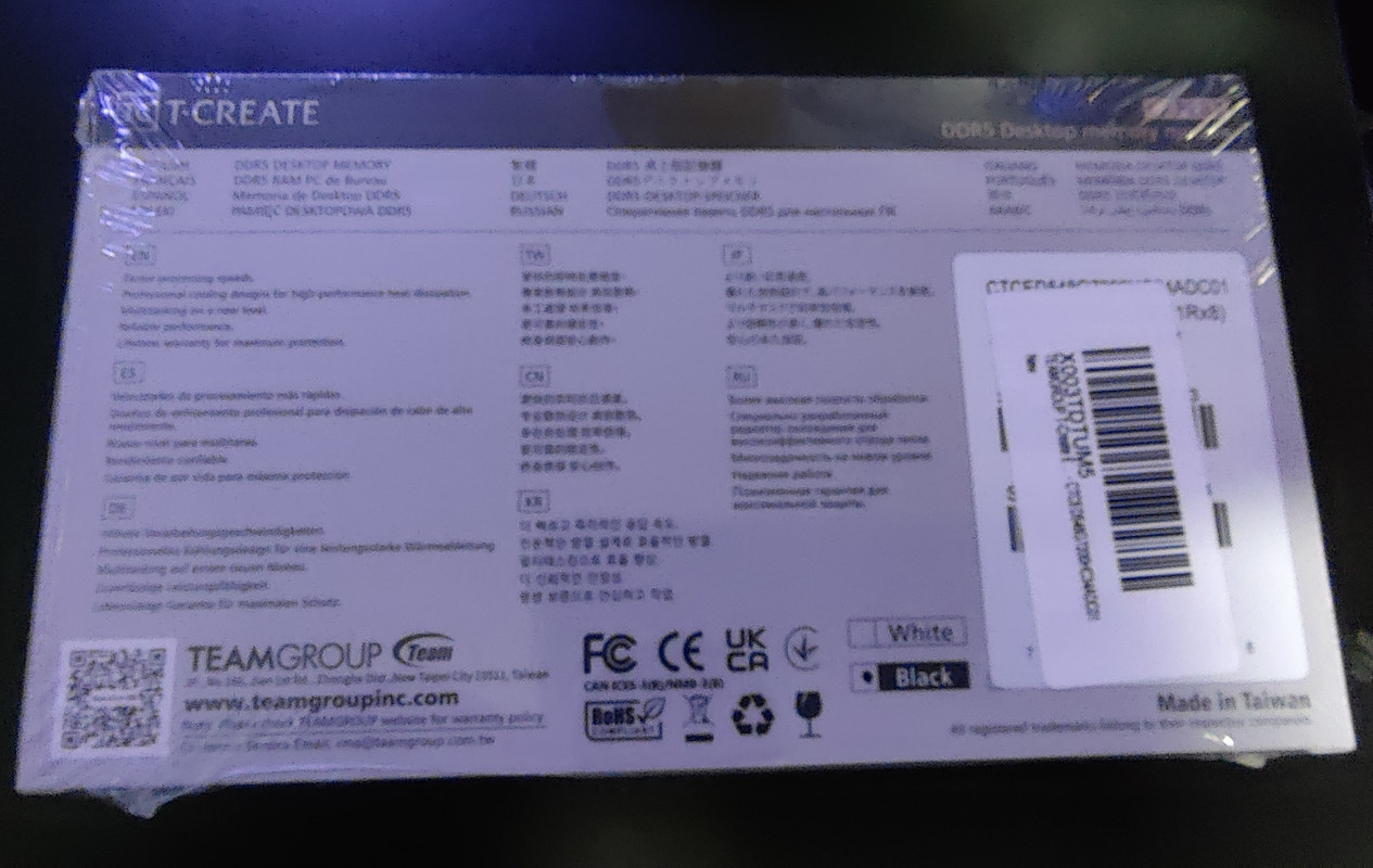

I’m going to order some next week. I did consider the G.Skill 8400 sticks. But they are too super crazy expensive, and I don’t trust the ram will be any better than what I have. I could get (2) of these kits for $390 and keep the best two sticks, return the others. And I can quickly exchange on Amazon if they all suck.

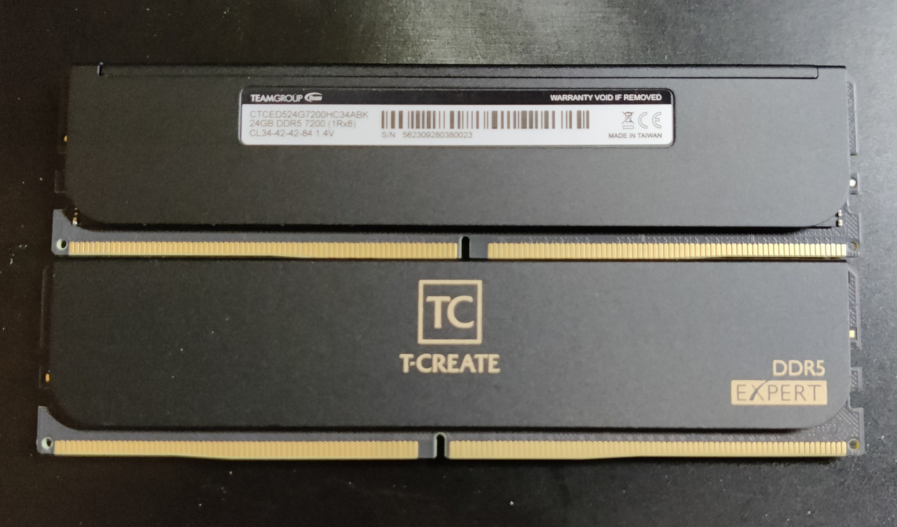

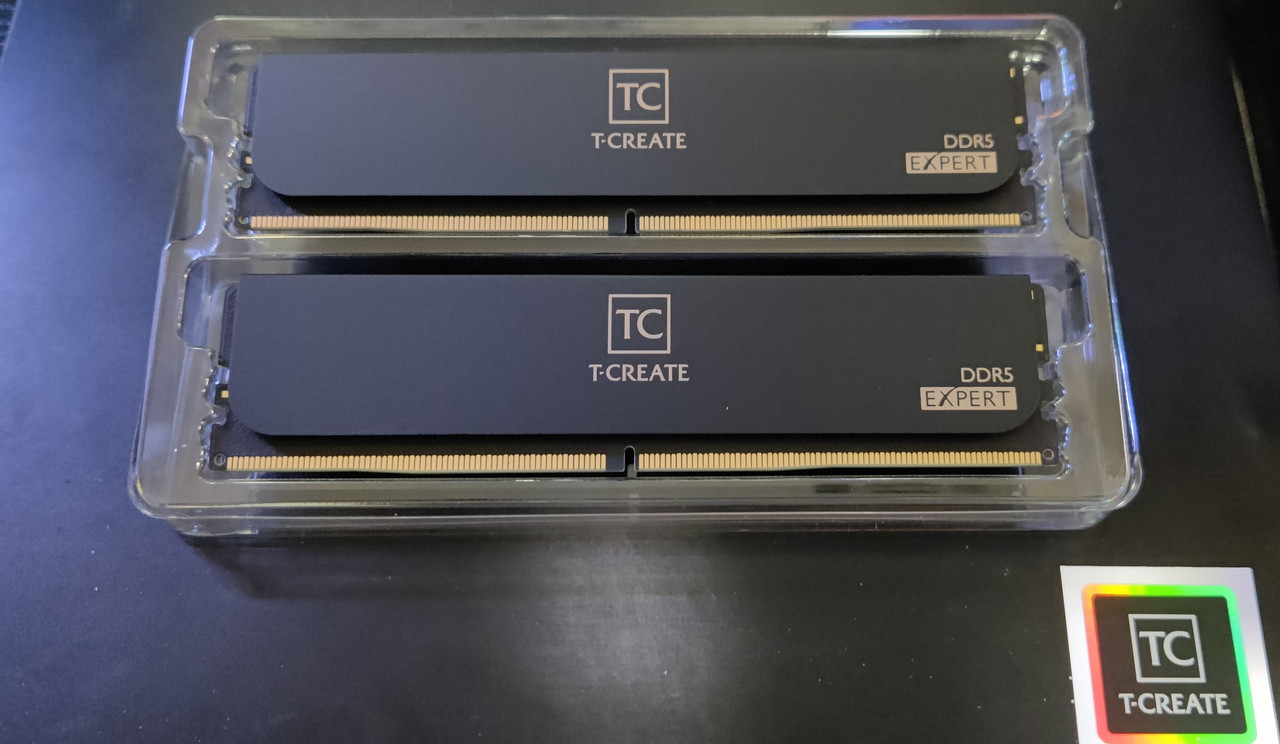

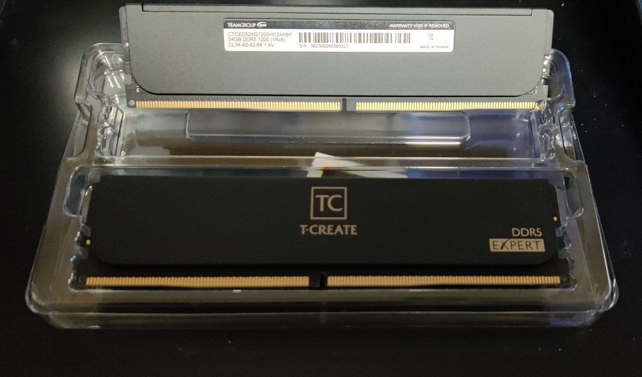

On 11/10/2023 at 8:19 PM, Mr. Fox said:
I would expect they are very good, hence the name of them and the absence of RGB. Only way to know is to buy a kit and see. RMA if they are trash. Mr. Potty-Mouth Jufus the Dufus swears by them. Mine are supposed to be here on Sunday. I will know within 15 minutes if I am keeping them or sending them back for a refund. I have several saved memory profiles to apply that will tell me almost instantly if they are gems or junk. Removing the heatsinks by soaking them in lacquer thinner is very easy if they are good enough to keep.
Well, not a bad kit. Quality is fine. The advertisement (even on the box) of a "one piece design" on the heatsink is just straight-up false. It is two pieces. The seam is not obvious at a glance and it looks like one piece. Not sure I am going to keep it because it is not remarkably  better than the RAM I took out of the Dark. It runs the same memory overclock as the G.SKILL kit on the Apex. I will think about it for a day or two. Not really gaining anything for the money spent. The 16GB*2 generic green A-die sticks are basically just as good. The only measurable benefit, which may not even matter in the grand scheme of things, is the extra 16GB of memory capacity. The extra capacity is worth something, but I am not sure that is a good enough basis for keeping versus RMA/refund.

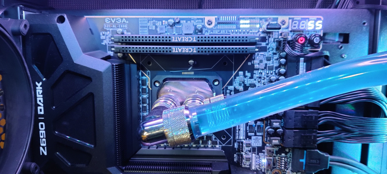

Here is the XMP default.
Here is the memory overclock matching the Apex.
If I keep it then, of course, it will have the heating blankets removed and the water-cooling kit on the generic A-die sticks will be installed on them. Just a matter of whether or not I decide it is worth the extra money and associated hassle. I'm kind of leaning toward "no" but we will see if I change my mind in a few days. I gained nothing on overclocking capacity, but also didn't lose anything except the slightly tighter timings possible with the 16GB first-generation A-die modules.
Nah... slept on it and do not need to think longer. No overclocking benefit over what I already have. The looser timings and higher voltage are worth mentioning. I don't need the extra 16GB. Sending it back for a refund makes the most sense. It deserves mention that the T-Create modules have dual XMP profiles; the mediocre 7200 and an even more mediocre 6000.
