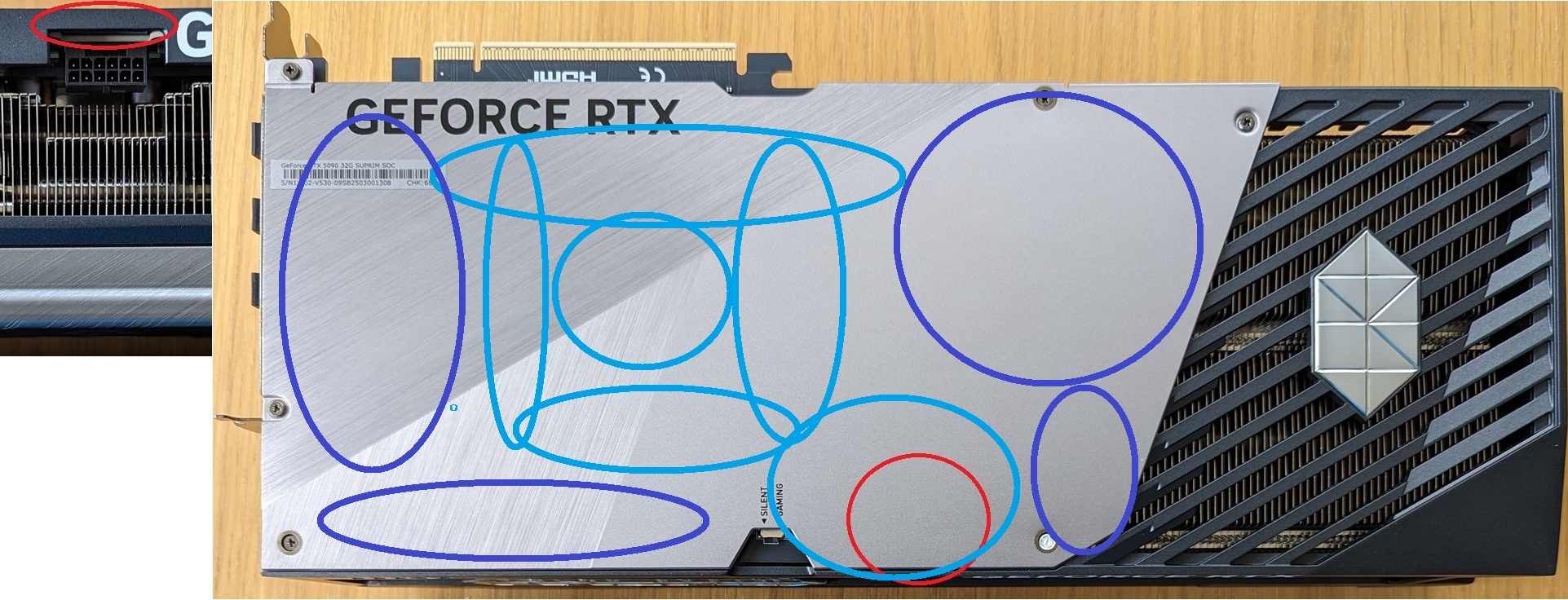

Can you explain or photo what you mean? I am trying to picture this and can't imagine where you applied the putty.
sure thing, lemme grab two of the pics i initially took to illustrate, pretty straight forward actually:
with the card installed in standard horizontal orientation, the power socket is on the underside of the PCB. at stock, there is a thermal pad placed on the pcb backside directly on top of the connector, with the pad connecting to the metal backplate (red circles). ive removed the pad and used two 30g TG putty pro batches to fill out the gaps over the core, vRAM and the power connector, all tracing a coherent line and connecting them (blue circles). then i just slapped Phobya Ultra 3mm thermal pad sheets onto the rest of the PCB backside where there was still enough space (indigo circles).
sorry for the amateurish illustration, just a quick n dirty thing to provide some visuals 😄
Thank you. That makes perfect sense now where you placed it so the connector can shed its heat onto the backplate.
