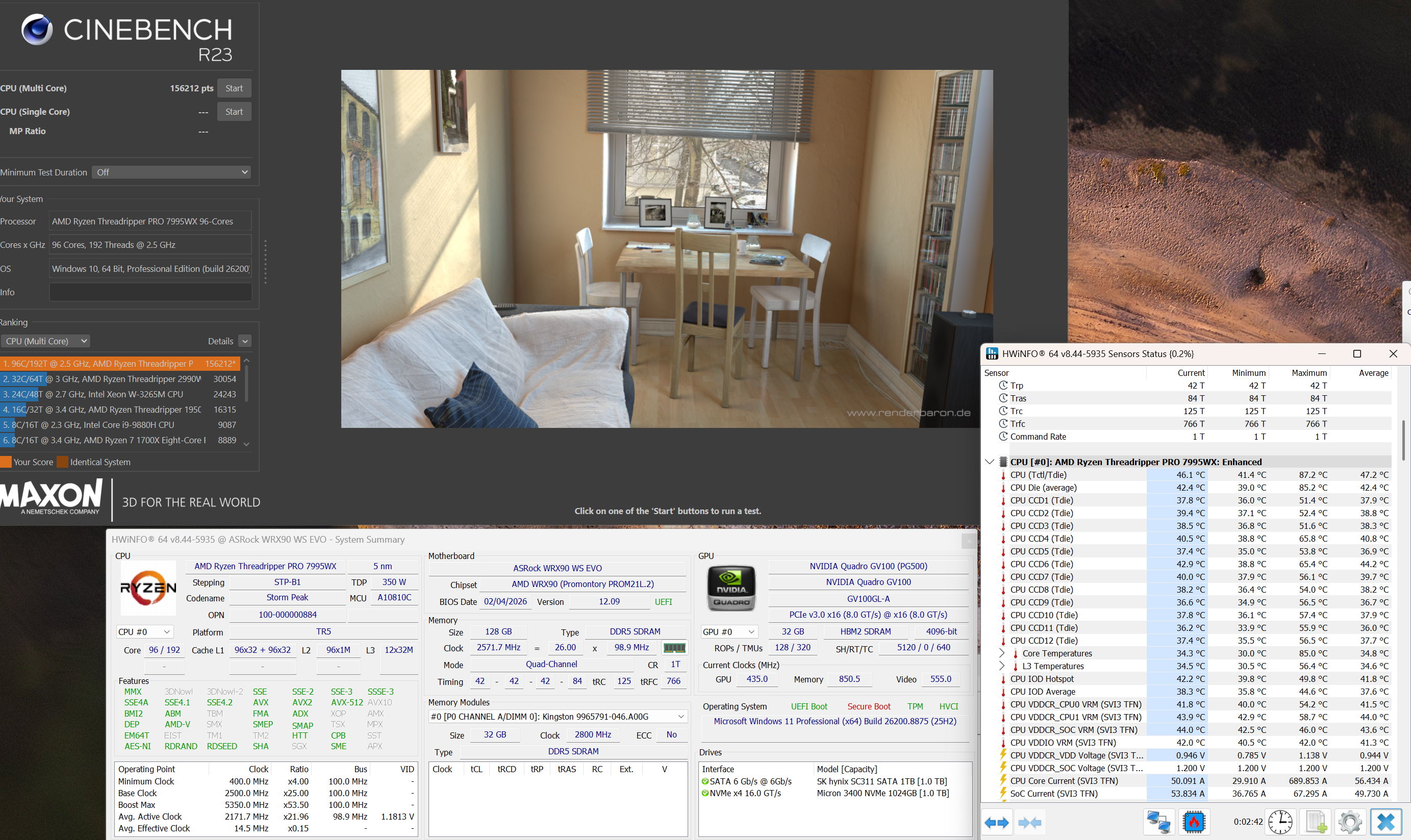

I had some time to play with the threadripper platform and tried a PBO with scalar 2x and -10 on all 96 cores, went from 119k to over 153k 😄 But the second try it shutdown 🤣 Still have the 1200w PSU 1U inside that the case came with so i think this is the weak link..i need to mode the case, cut it so i can add  Bquiet 1200w ATX PSU titanium but dont have the time for the work right now
