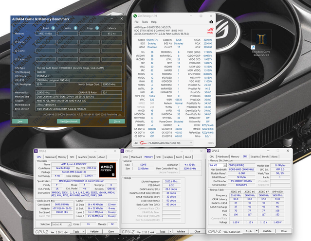

Good news. Yes, SP118 is good for 9950X3D2. That is what mine was that I sold to @Reciever and the 9950X that I sold to @damric at oc.net was as well. SP118 is average or a 9950X (non-3D). My 4585PX is SP119, which is better than average for 9950X3D/4585PX (which are typically something like 115.). All of them will boot 8400 2:1 and run 2200 FCLK and run 8000 2:1 100% stable with 2200 FCLK very easily.
That's excellent @Reciever got everything up and running! And from the looks of it, he’s got it running really great too! You know, I actually almost kept my first one that was stuck at 2167fclk, and on the very last day to return, I had a change of heart lol (Glad I did!). But I’m playing with it. But the SP#’s are looking good on this one! The 1st CCD is good, but the 2nd CCD is very strong looking.
I set a 1.180v Vsoc voltage and loaded right in Windows at 2,200fclk. No wheas! I will do some testing to ensure all is well with it. My last 9950X3D2 would not load 2200fclk no matter what you did! I tried literally everything.
Now time for some memory testing, but at this point I’m liking it much better than that very first one.
EDIT:::  2,200 FCLK + 6400c30 Gear 1:1 works perfectly fine so far.

He is using a profile I tuned for the 9950X3D2 and I bet he would be happy to export the CMO file, zip it and upload it here if you wanted to tinker with it to see if it works well for yours.

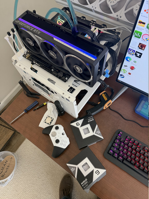

Do you have another platform to test it with the block on real quickly to see if it boots with a display out?
Nothing that would be quick, but I had a sneaking suspicion of a couple of things.
I dusted my radiator nearby, and I also used an aftermarket pci bracket that came included with the alphacool waterblock (alphacore iirc). Luckily I didnt make the loop super lean in tubing since I know how I am.
Anyways with the GPU slipping between Gen 1.1 and 2.0 (pointing to a signaling issue), the aftermarket bracket and possible contamination to dust, I went after the easiest solution.
Removed the card while retaining the loop. Removed the PCI bracket, lightly dusted the pcie lane and 70% alcohol on the pcie traces of the GPU and installed without the bracket.
Video is back! Was confused initially as one screen came back but not the other, turned out that cable fell out (woops!)
Lets just ignore that lol. I absolutely blame ALL OF YOU for stepping up my cooling. I still like big air coolers but stepping back into water cooling has been an experience that I can enjoy and measure. Its more efficient displacement but more importantly takes up significantly less space.
@Mr. Fox I am fairly confident that some dust must have been on the 9070 XT been keeping an eye on it this evening and its been sitting at Gen 4 (set manually in bios as part of diagnosing). As always everything I have purchased from you over the years has been well shipped, and exactly as advertised. Its really nice to be able to buy something set it aside for when you are ready, execute the plan and just know everything will be as expected. Even Hiew still sings your praises, he immediately sold his 5800X3D set up and enjoyed building his gift with the previous bundle. I never knew compiling shaders could move so quickly!
@tps3443 just let me know if you want Brother Fox's profile, thus far its been rock solid for me on my setup. I can probably have it tomorrow night if you want it.
I mentioned to Fox in our messages that I am pretty sure this platform I am running now is about as good as it can get if you are running 8-pin power. When ever the 7900 XTX @ 500w cant handle 120 FPS in games ill just set 60 and couple that with lossless scaling with the 9070 XT. Already have 100+ hours of Monster Hunter: Worlds at 4k120hz using that method. With GPU prices being such as they are, I'll ride this combo for as long as I can.

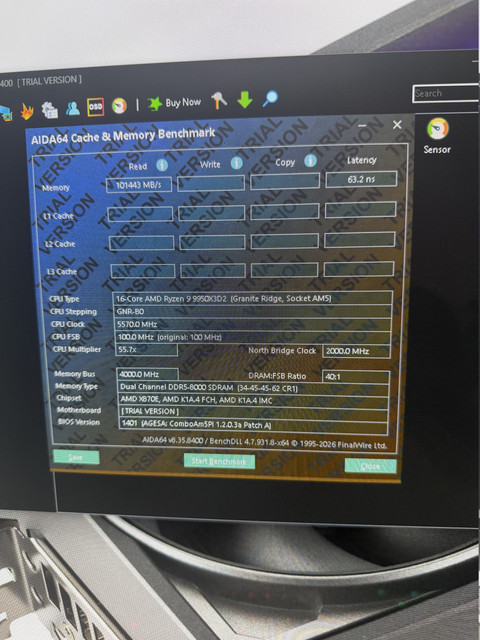

So far I have been strictly playing with 1:1 memory tuning. 6400c28 is completely solid even with 2,200 fclk. I think I may even can stabilize 6600 1:1. But it starts to show IMC limits at 6600 (1:1)
I just tried 1:2 today for the first time, DDR5 8000 1:2 posted up first try. Even with only 1.400v VDDIO. There was definitely something seriously wrong with my last setup to not work.
PS: These are my setting below.  I can't seem to get my latency down much. I am wondering if its OS related at this point. I even tried some manual Nitro Path settings. I am on a really old bios 1401 from 05/2025.

The 16GB G.SKILL modules are definitely better for Ryzen than 24GB sticks, especially on ASUS.
Try the Strix X870E-E memory settings I used in this video. Bear in mind that X3D CPUs are always going to have a memory latency penalty, usually 1 to 3 ns. Set the "Core tunings Configuration for gaming" to Legacy and that should bring it down a bit.
If the 8000 C34 settings are too tight, try the 8000 C36 settings that I use on the B850MPOWER. There is almost no difference in memory benchmarks between the two. Too small to matter.

Thanks! It works! I copied all of your settings. Only thing I changed was, I flipped the CCD0 55.50 and CCD1 55.25 etc, and I ran 1.500v VDD mainly because I am not sure how good my ram is, I think you had the 6000c26 sticks.
But I may try 1.480v now.

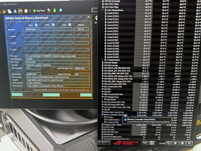

I cannot run 1.480v VDD, but thats alright.
When I run R23 it hangs the whole system. I’m not really sure where to start.

Sounds like your CPU is being voltage-starved based on the behavior you described. If you are running CCD0 55.50 and CCD1 55.25 you're going to need to manually set Actual VRM Core Voltage (set Core VID the same of 10mV higher) for somewhere between 1.375V and 1.425V (depending on your CPU) or drop them down to 54x or 53x depending on what voltage those core ratios need. If you are running PBO with DOS (Dynamic Overclock Switcher) enabled your Curve Optimizer negative offset might be too deep and that can make the transition from low-load PBO to high-load manual overclock is too dramatic. If the CPU has not been delidded it is going to be very difficult to run 54x or higher than 1.275V-1.300V due to overheating. Each CCD is very small and temperature sensitive due to the lack of thermal dissipation surface area. Much more so than Intel. My Ryzen CPUs tend to freeze the OS when overheated rather than thermal shutdown. I don't know why.

@Reciever and @tps3443 if you don't already have it, download this modded version of ZenTimings. It was previously shared by @safedisk on HWBOT and OC.net and it has a few features the normal releases do not have, including memory temperature and power, WHEA error counter and CPU die temperature. The sensors for VDDIO typically do not work unless the BIOS is set to Auto for VDDIO, but this modded version may fix that as well. (It fixes it on my B850MPOWER.) This app functions portably. No installation nececessary other than the prompt to install PawnIO on first launch. (PawnIO must be installed or ZenTimings will not work. PawnIO is a replacement for WinRing0.)
@tps3443 also check your Nitro settings to confirm the BIOS is automatically assigning them as 1/3/1 and manually correct if not (shown in ZenTimings). Make sure your Bank Refresh Mode is "Normal" (not "Mixed") and manually set it if not. This will make it so only tRFC is used. tRFC2 and tRFCsb/pb are not used in Normal mode. You can set them to "1" in Normal Bank Refresh mode, or not set them at all, and it doesn't matter since their values are ignored. In Mixed mode latency is higher and those values do matter.

I am testing the 2nd 9950X3D2, and it has a “Superman” IMC. Even stronger than the other one.
This one runs 6600c30 1:1 without any fuss, but only 2,167 FCLK.
So now I have a choice to make.
#1 (9950X3D2) 2200fclk@ 6400c28 1:1 Easy Mode SP118.
#2 (9950X3D2) 2167fclk@ 6600c30 1:1 Easy Mode SP118.

So, I was worried this would happen lol.
Don't give up on the one that only runs 2167 just yet. If the voltage suggestions I texted to you work you might be able to run 2200 FCLK stable. If they do not work, then I would choose CPU #1 that does run 2200 FCLK at 6400 C28.
The 2200 FCLK is more important than the 6600 C30. That is because the FCLK is the frequency that connects the CCDs and IO die and being limited to 2167 is not ideal because it becomes a bottleneck that affect more things adversely than just being able to run a 200 MHz higher RAM frequency. Because these components are physically separate, they must communicate across the CPU package. FCLK dictates how fast data can travel between these chiplets. If FCLK is low, it creates a bottleneck where your memory sends data faster than the internal highway can handle. Conversely, pushing FCLK too high past its physical stability limits (usually a maximum of 2200 MHz on Zen 5 CPUs) results in audio crackling, USB dropouts, system crashes or no boot (code 00).
Running high memory frequency on Ryzen has diminishing returns, especially on X3D chips. You are better off focusing on bandwidth, which is why 8000 2:1 is better than 6400 1:1. It allows more data to pass through in the same amount of time due to higher bandwidth. You will find that 6600 1:1, 8000 2:1 have similar benchmark scores, but 8000 2:1 is higher bandwidth and allows you to do a little further with performance. And, 2200 FCLK matters for both configurations.
The CPU that can do 6600 C30 1:1 has a very strong IMC and a weak fabric. Stronger fabric trumps stronger IMC unless the IMC is really horrible. There is not going to be much difference between 6600 C30 and 6400 C28, but a 2167 FCLK would hold you back and probably have measurably higher latency.
The fabric is sort of like a transmission. If you have a strong engine and a fragile transmission with the wrong gear ratios the strong engine is going to be of limited benefit because it cannot push the performance to the wheels where it matters most.
First of all, congratz on getting two great chips!
Second, have you tested their core strength and not just the IMC?
Third, How are you testing? This is a situation I would throw Karhu at both of them and see what rises to the top for their IMCs
Lastly, quite honestly to me, 8000+ is end game now for AM5 if only marginally so because while 6600 is nice the real end goal for AM5 is 2200+ and 8000+. I've upended all my timings and settings centered around 8000+ because at worst it performs the same as 6400 while at best it actually does a smidge better. The problem also is if you can only run 2167 then that throws out of sync a bit matching 2200:6600.
Test both of them at 8000, 8200, 8400 and see which one rises to the top next. Real testing TM5 Extreme at least or Karhu if you want that end game verdict of where they stand realistically.
