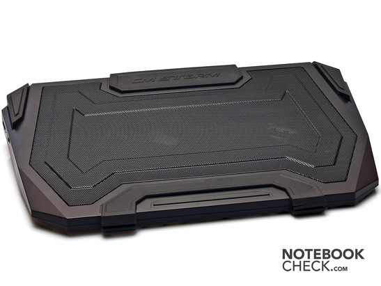

duskw4lker Posted March 4, 2022 Author Share Posted March 4, 2022 I've been tempted in the past to buy this .. thing 🤣 that claims to cool down your lappy beyond recognition with its dual blowers and hermetically sealed chamber of absolute freezing madness. The reviews seem positive enough though. but what concerns me is some kind of myth? or misinformation? around this kind of cooler that uses blowers instead of a regular fan, and that supposed problem would be damaging your laptop's own fans because of spinning way too fast beyond the intended max speed due to the volume and pressure of air inside that sealed chamber (4500 rpms at max speed from those blowers according to the manufacturer) any thoughts? https://www.amazon.com/IETS-Cooling-Flexible-Colorful-Adjustable/dp/B07WVK2ZZ9 Link to comment Share on other sites More sharing options...

serpro69 Posted March 5, 2022 Share Posted March 5, 2022 On 3/4/2022 at 4:26 AM, duskw4lker said: I've been tempted in the past to buy this .. thing 🤣 that claims to cool down your lappy beyond recognition with its dual blowers and hermetically sealed chamber of absolute freezing madness. The reviews seem positive enough though. but what concerns me is some kind of myth? or misinformation? around this kind of cooler that uses blowers instead of a regular fan, and that supposed problem would be damaging your laptop's own fans because of spinning way too fast beyond the intended max speed due to the volume and pressure of air inside that sealed chamber (4500 rpms at max speed from those blowers according to the manufacturer) Damn that thing looks super futuristic, would probably look very cool along with something like Alienware M18x R2. As for damaging the laptop's fans, I'm not sure how that would happen. Most laptops have a thin mesh covering the air intake slots on the bottom, and hence the air that is blown into the them will dissipate quite a lot. Also, looking at the video, the air does not go straight up like it would from a fan, but rather it blows more or less parallel to the laptop then starts curling up around the middle. Spoiler 1 GitHub Currently and formerly owned laptops (specs below): Razorback -> MacBook Pro 16" (M4 Pro) (work) Serenity -> Dell Precision 5560 N-1 -> Dell Precision 5560 (my lady's) Razor Crest -> Lenovo ThinkPad P16 (work) Millenium Falcon -> Dell Precision 5530 (work) Axiom -> Lenovo ThinkPad P52 (work) Moldy Crow -> Dell XPS 15 9550 Spoiler Razorback: MacBook Pro 16" M4 Pro (14-core CPU, 20-core GPU) 48 GB RAM 1 TB SSD MacOS 15.1 Senenity / N-1: Dell Precision 5560 i7-11800H CPU 1x32 GB DDR4 2,666 MHz 512 GB SSD NVIDIA T1200 FHD+ 1920x1200 PopOS 22.04 Link to comment Share on other sites More sharing options...
duskw4lker Posted March 5, 2022 Author Share Posted March 5, 2022 1 hour ago, serpro69 said: Damn that thing looks super futuristic, would probably look very cool along with something like Alienware M18x R2. As for damaging the laptop's fans, I'm not sure how that would happen. Most laptops have a thin mesh covering the air intake slots on the bottom, and hence the air that is blown into the them will dissipate quite a lot. Also, looking at the video, the air does not go straight up like it would from a fan, but rather it blows more or less parallel to the laptop then starts curling up around the middle. I. must. not. spend. more. money 😵. You make an interesting point, the mesh that is commonly placed at the intake should dissipate some of the pressure, and yes, the air is not being blown directly hmm... 🤔 Link to comment Share on other sites More sharing options...
seanwee Posted March 6, 2022 Share Posted March 6, 2022 On 3/4/2022 at 11:26 AM, duskw4lker said: I've been tempted in the past to buy this .. thing 🤣 that claims to cool down your lappy beyond recognition with its dual blowers and hermetically sealed chamber of absolute freezing madness. The reviews seem positive enough though. but what concerns me is some kind of myth? or misinformation? around this kind of cooler that uses blowers instead of a regular fan, and that supposed problem would be damaging your laptop's own fans because of spinning way too fast beyond the intended max speed due to the volume and pressure of air inside that sealed chamber (4500 rpms at max speed from those blowers according to the manufacturer) any thoughts? https://www.amazon.com/IETS-Cooling-Flexible-Colorful-Adjustable/dp/B07WVK2ZZ9 A member of the MSI Enthusiasts discord I manage just bought this for his GF65. He figured it would be the best option for the GF65 since that laptop doesnt have any direct fan intakes and so a sealed cooling pad like this would be helpful in forcing air through the laptop. When it arrived and tested it however, the temperatures were 3C worse than not using a cooling pad. He said that the fans ran slow and was barely pushing any air through. In fact, it was restricting the amount of fresh air the laptop could intake due to its sealed design. Basically, avoid this cooling pad at all costs 9 hours ago, serpro69 said: Damn that thing looks super futuristic, would probably look very cool along with something like Alienware M18x R2. As for damaging the laptop's fans, I'm not sure how that would happen. Most laptops have a thin mesh covering the air intake slots on the bottom, and hence the air that is blown into the them will dissipate quite a lot. Also, looking at the video, the air does not go straight up like it would from a fan, but rather it blows more or less parallel to the laptop then starts curling up around the middle. Hide contents Even with my custom cooling pad forcing tons of air into the laptop intakes, I have not observed any "damage" to the fans. In fact, the fans run quieter than before since they no longer have the high pitched whooshing sound from air being sucked into the laptop as air is already being blown into the laptop. 1 1 1 ASUS Strix Scar 17 Ryzen 9 7945HX CB R23: 37202 32GB x2 DDR5 6000 CL34 Hynix A-die RTX 4090 Laptop (Shunt modded) Firestrike graphics: 58 334 || Timespy graphics: 27049 || Port Royal: 17013 || Steel Nomad DX12: 6639 Link to comment Share on other sites More sharing options...
