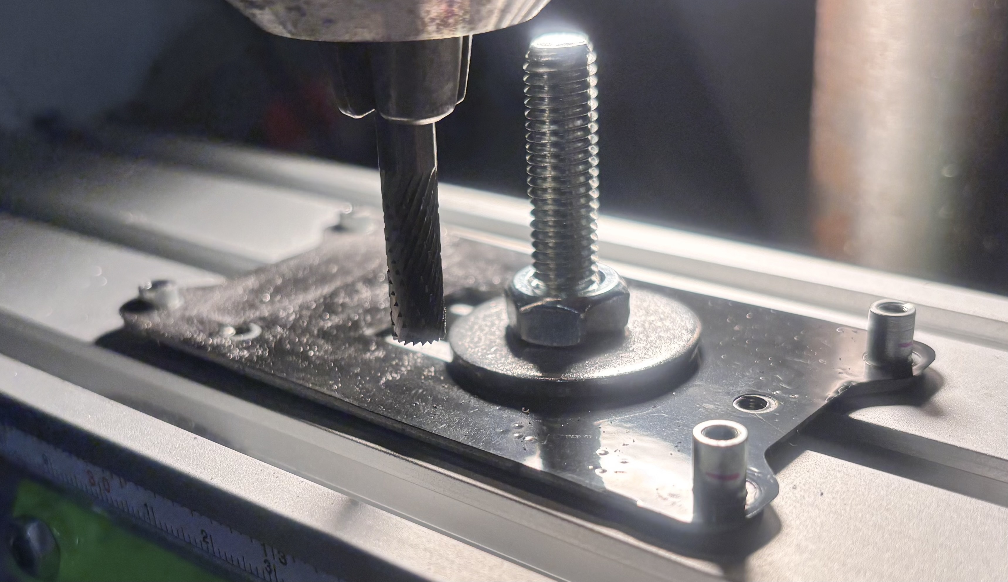

KabyZen Posted September 5 Author Share Posted September 5 On 8/5/2025 at 2:54 AM, zerokool said: Cool looking forward to your findings 🙂 I just chose option 1. Used a Dremel to cut the bracket then sanded it down to required height. Threads are still there. Did end up stripping the heatsink screws a year later so popped them out and am now using regular old laptop screws (I think M2.5x5). 1 1 Link to comment Share on other sites More sharing options...

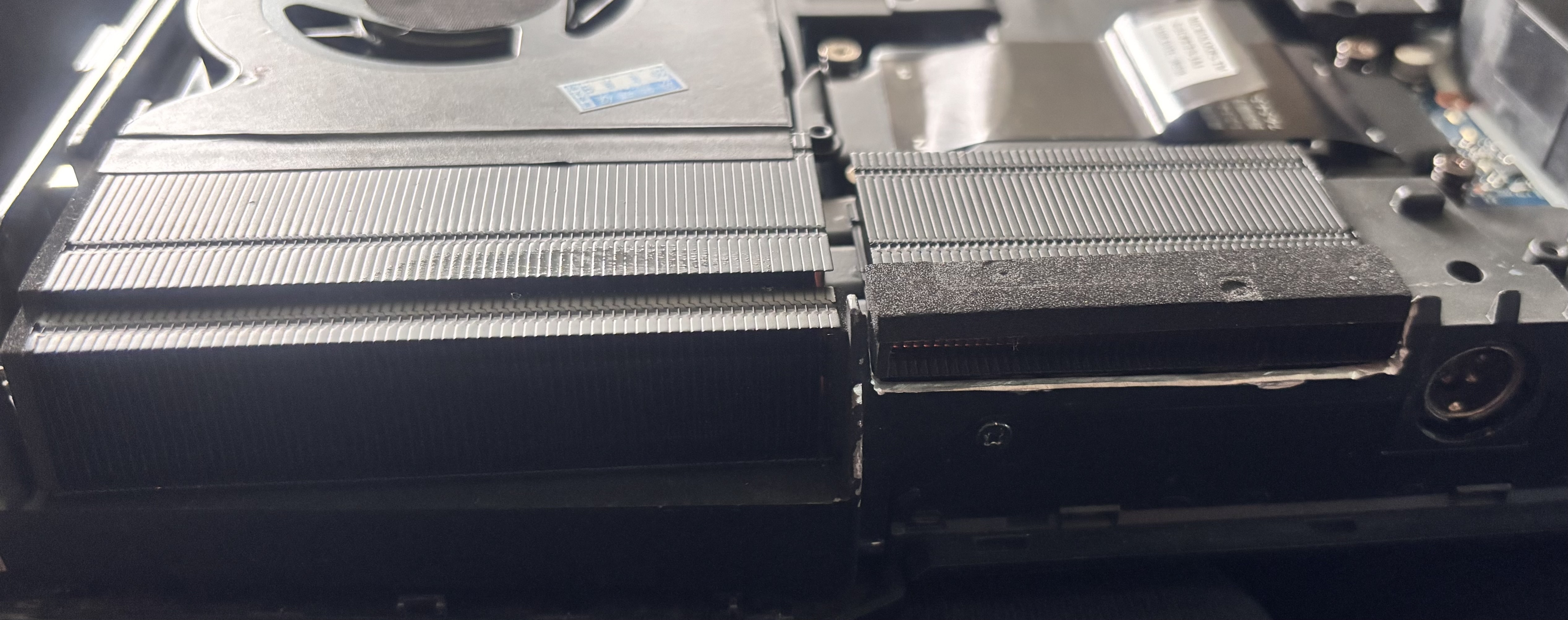

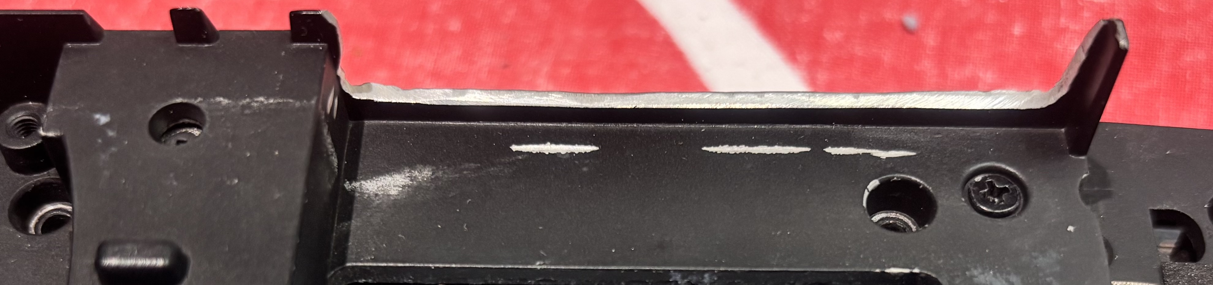

Kastner Posted September 6 Share Posted September 6 On 8/5/2025 at 8:54 AM, zerokool said: Cool looking forward to your findings 🙂 I did the cut too and decided not to make a new bracket. I always wanted to keep original parts but not in this case. It would have been a lot of work and this one only take an afternoon. So you have to cut 4mm from the original bracket you should have enough tread to use it properly. I used a drill with a milling bit. And cut the frame to fitt the extra radiator. It is a worthy mod I think this cooling is superior than the old one. The next step will be the second fan mod. 1 Clevo P870DM2 9700k RTX3080 Clevo P775TM1 9400F GTX1080 Link to comment Share on other sites More sharing options...

Kastner Posted September 6 Share Posted September 6 7 minutes ago, KabyZen said: I sometimes regret not waiting for the P870TM now haha. Yes, indeed have to work a bit but the TM is no better then DM2 or DM3 apart from this cooler. As I followed @Developer79 work and tests on P870 there is no difference in P870s apart from DM. 11 minutes ago, KabyZen said: I originally wanted to buy a TM bracket from Eurocom but they didn't have any at the time. I just bought from Ali it was €50 something and it is worth it. It is the best Clevo laptop in my opinion and unfortunately it will remain the best as it looks like.. Clevo P870DM2 9700k RTX3080 Clevo P775TM1 9400F GTX1080 Link to comment Share on other sites More sharing options...

Kastner Posted September 7 Share Posted September 7 45 minutes ago, zerokool said: Yeah kind of hard without a drill / cutting press or machine tool lol . You can do like the post before me just use dremmel or a grinder. Clevo P870DM2 9700k RTX3080 Clevo P775TM1 9400F GTX1080 Link to comment Share on other sites More sharing options...
