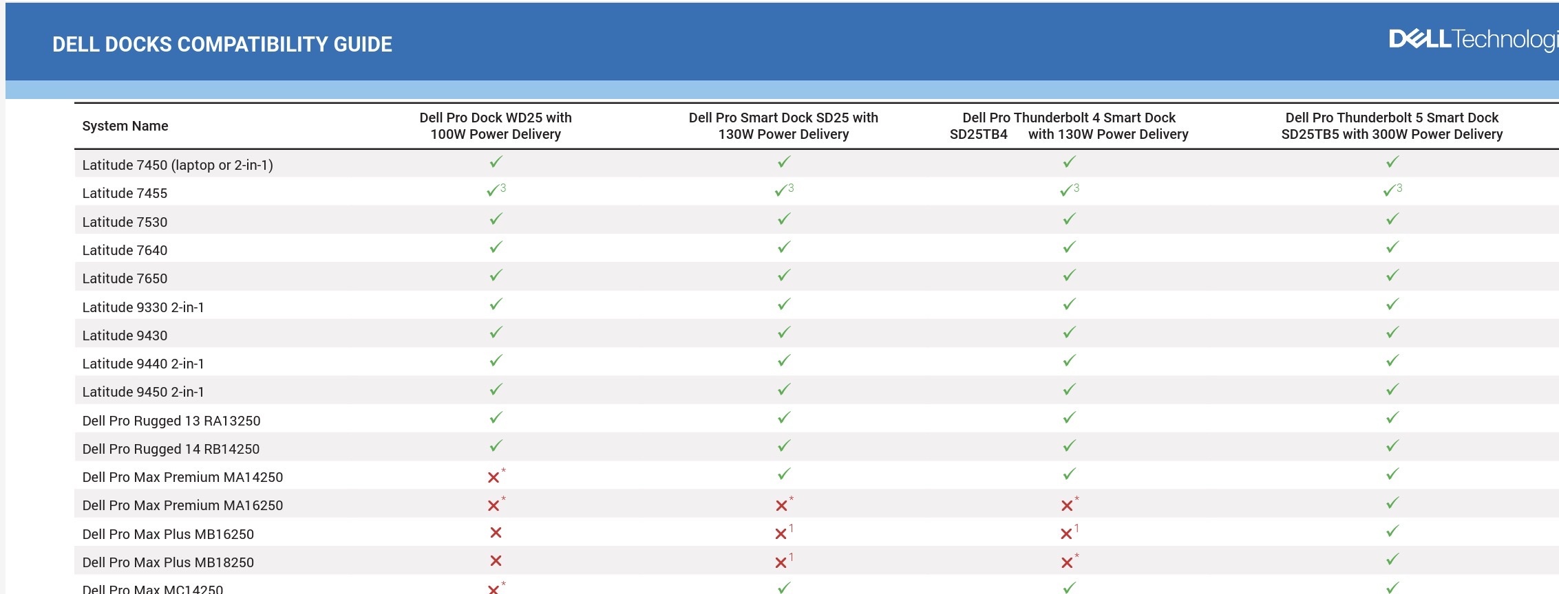

SvenC Posted October 1 Share Posted October 1 9 minutes ago, capitainealbator said: Hello, any idea about my question? 😉 🙂 Yes, it is shown as compatible here dell_docking_compatibility_guide.pdf.external I have the Pro Max 18 Plus with iGPU only and that works flawlessly with my old WD19DC. Dell Pro Max Plus 18 * Ultra 7 265HX * 64GB CSoDIMM * 4TB, 2TB, 2560x1600, iGPU previous; Dell Precision 7680 * i7 13850hx * 64GB SO-DIMM * 4TB, 2TB, 1920x1200 previous: Dell Precision 7740 * i7 9750h * 48GB * 512GB, 2TB, 4TB * RTX 3000 * 1920x1080 Link to comment Share on other sites More sharing options...

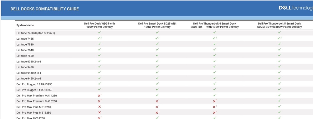

Cadtot Posted October 1 Share Posted October 1 Yes, the SD25TB5 supports the Dell Pro Max 16 and 18 - has a 300w power supply. It seems to be the only current dock model that does. Compatibility matrix attached. Link to comment Share on other sites More sharing options...
capitainealbator Posted October 1 Share Posted October 1 Thanks @SvenC and @Cadtot 🙂 @SvenC: I have a WD19S: do you think it could be ok for a Pro Max Plus 18 with RTX4000 ? Link to comment Share on other sites More sharing options...
SvenC Posted October 1 Share Posted October 1 54 minutes ago, capitainealbator said: Thanks @SvenC and @Cadtot 🙂 @SvenC: I have a WD19S: do you think it could be ok for a Pro Max Plus 18 with RTX4000 ? The WD19DC has two USB-C plugs and allows up to 210W. I guess the WD19S can only provide 130W, which is not even enough for the iGPU-only PMP18. I would expect it to work if you connect your power adapter and the WD19S - so, periphery from the Dock and power from your power adapter. Dell Pro Max Plus 18 * Ultra 7 265HX * 64GB CSoDIMM * 4TB, 2TB, 2560x1600, iGPU previous; Dell Precision 7680 * i7 13850hx * 64GB SO-DIMM * 4TB, 2TB, 1920x1200 previous: Dell Precision 7740 * i7 9750h * 48GB * 512GB, 2TB, 4TB * RTX 3000 * 1920x1080 Link to comment Share on other sites More sharing options...
AL123 Posted October 1 Share Posted October 1 5 hours ago, SvenC said: The WD19DC has two USB-C plugs and allows up to 210W. I guess the WD19S can only provide 130W, which is not even enough for the iGPU-only PMP18. I would expect it to work if you connect your power adapter and the WD19S - so, periphery from the Dock and power from your power adapter. I’ve only tested with the power supply connected and 1x usb-c connector from wd19dcs , this seems to work ok as a solution to not buy the new thunderbolt 5 dock but still not ideal as you have to remembered to take the 280W usb c power supply with you everywhere. 1 Link to comment Share on other sites More sharing options...

Cadtot Posted October 2 Share Posted October 2 7 hours ago, AL123 said: I’ve only tested with the power supply connected and 1x usb-c connector from wd19dcs , this seems to work ok as a solution to not buy the new thunderbolt 5 dock but still not ideal as you have to remembered to take the 280W usb c power supply with you everywhere. I run two WD19DCs, one fully powering a Precision 7750 supporting two 4K screens, and the other supporting a Precision 7710. The 7710 uses one tail from the WD19DC to support one DP 4K screen, and I use HDMI to support the second 4K screen. All works fine. :) Link to comment Share on other sites More sharing options...

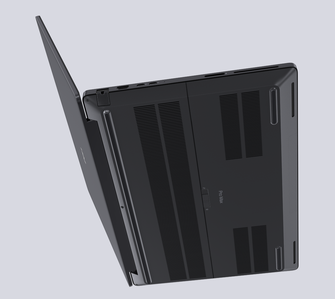

1610ftw Posted October 20 Share Posted October 20 Sorry to hear that you are missing the door - would that door be for the PCIe 5.0 slot? I am also surprised about the number of different bottom designs - do you not have the one in the picture you posted above but a third option? Link to comment Share on other sites More sharing options...
