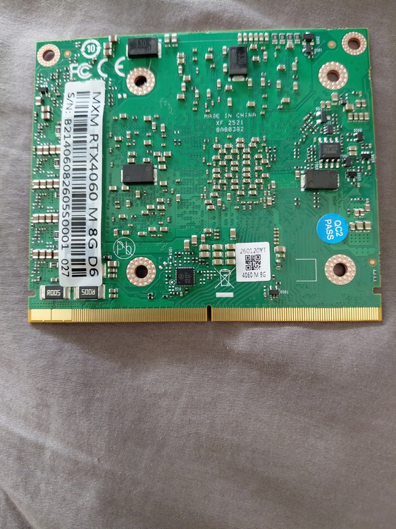

Derpmaster69 Posted December 5, 2025 Posted December 5, 2025 @SuperMGwill the flex cable mod work on zbook 15 g2, it only has an eDP display (so no LVDS). I plan on getting a PELADN rtx 4060 MXM since XVSION 4060 will not probably work as they pull 115W (Zbook 15 g2 has an MXM a slot max 75W. My main question is, does the zbook 15 g2 have the backlight pins as needed or should I solder them in another way? Nice hack by the way to show that socketed laptops will always stay superior Sorry for tagging you if it was offensive
SuperMG Posted December 5, 2025 Author Posted December 5, 2025 1 hour ago, Derpmaster69 said: @SuperMGwill the flex cable mod work on zbook 15 g2, it only has an eDP display (so no LVDS). I plan on getting a PELADN rtx 4060 MXM since XVSION 4060 will not probably work as they pull 115W (Zbook 15 g2 has an MXM a slot max 75W. My main question is, does the zbook 15 g2 have the backlight pins as needed or should I solder them in another way? Nice hack by the way to show that socketed laptops will always stay superior Sorry for tagging you if it was offensive Yes works. Make sure it's eDP on DP_D because of the Nvidia VBIOSes. Peladn don't sell anymore I believe.
