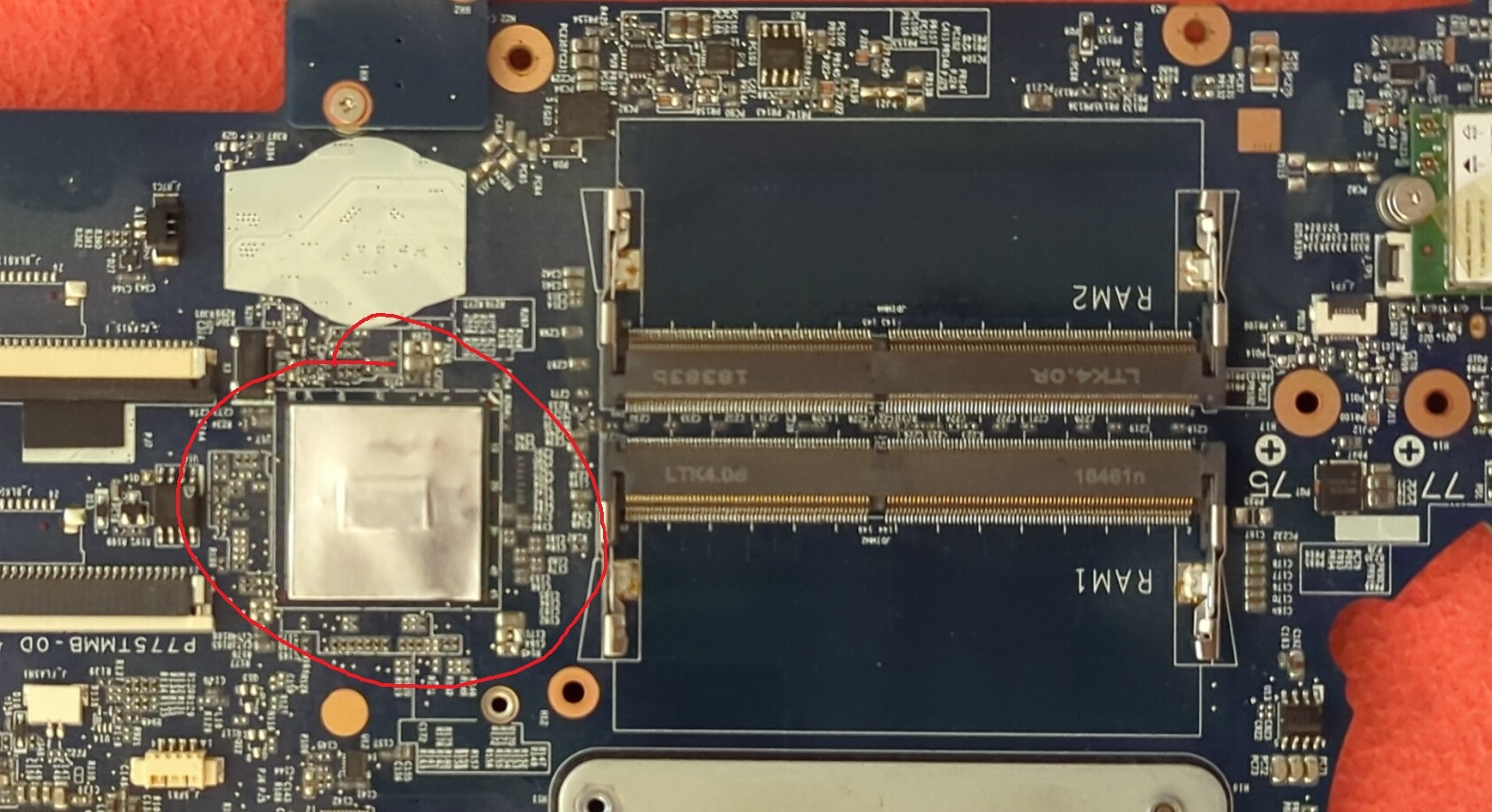

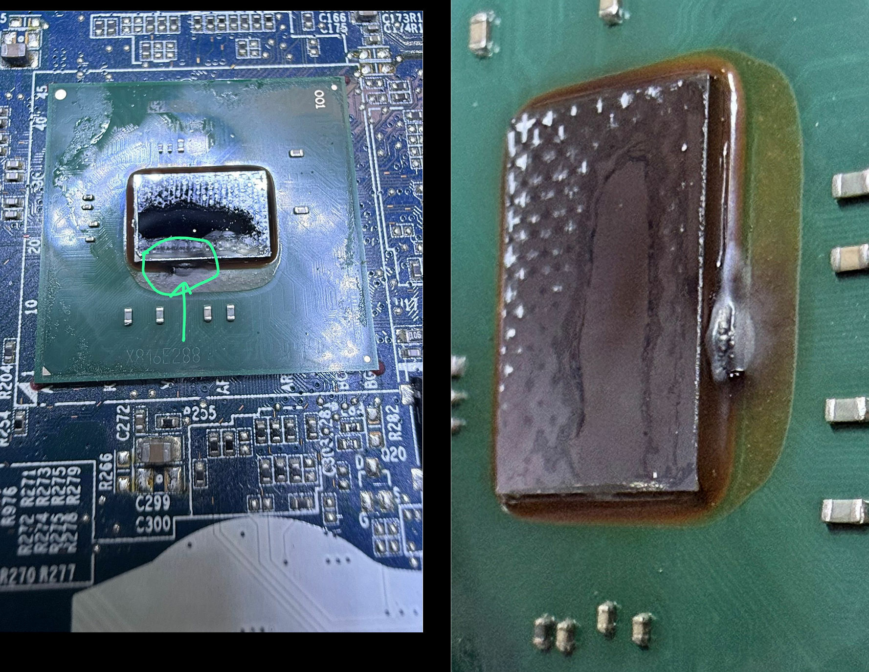

dude-137 Posted May 1 Author Posted May 1 @zex4, @JadeRover I've removed absolutely all components except the motherboard and tested, no reaction on the plugged charger. I have then completely disassembled the laptop, to investigate the MB in more detail. I noticed a couple of differently coloured spots. Dunno, either it's normal, or it's unnormal, or it's simply caused by the white marshmallow-like cooling pads being stuck to those areas. I've attached the pictures (1: the spot near the power plug, 2: what's on the other side, 3: the other spot, 4, what's on the other side [some unknown chip]). The charger is out of the question, I have both 330W and 230W, and also my friend has an older-gen Clevo. Chargers are alright. I don't have a spare GPU, there's been no need, but anyway, as I removed all components leaving the MB alone, and it still doesn't react to power in any way, GPU is kinda out of the question i guess I don't have a multimeter unfortunately, and nearly zero practical experience in diagnosing micro-electronics
JadeRover Posted May 1 Posted May 1 2 hours ago, dude-137 said: I have then completely disassembled the laptop, to investigate the MB in more detail. I noticed a couple of differently coloured spots. Dunno, either it's normal, or it's unnormal, or it's simply caused by the white marshmallow-like cooling pads being stuck to those areas. I've attached the pictures (1: the spot near the power plug, 2: what's on the other side, 3: the other spot, 4, what's on the other side [some unknown chip]). Ok, unfortunately this will only get you so far, usually shorted capacitors/mosfets aren't visible with the naked eye. Darker areas on motherboards can be usual heatspots (around CPU VRM, battery charging circuit, etc). These can be false positives. Nothing stands out from the pictures you gave. Unknown chip is the CPU chipset btw. 2 hours ago, dude-137 said: I don't have a multimeter unfortunately, and nearly zero practical experience in diagnosing micro-electronics Ok, that's a bummer, a multimeter is a really usefull tool, even for everyday electronics (making sure wires are connected, etc). I would highy recommend getting one, even 10 dollar/euros multimeters are well worth the price in my opinion. Even with not that much knowledge, you can trace short circuits easily with one and know if your GPU is shorted, CPU vrm shorted, chipser shorted, etc... The next step would be to get the laptop to a repair shop, a good shop should have a motherboard diagonistics fee. Make sure they actually diagnose the motherboard properly, most repair shops just plug it in, say it's dead and recommend a motherboard replacement. You can read reviews/check the websites of repair shops and make sure they actually do real motherboard testing. 1 Precision M6700 : i7-3740QM | P3000 6gb engineering vbios | 20gb DDR3 1600Mhz | FHD ips dreamcolor | delta fans Zbook 17 g3 : i7-6820HQ -75mv | M3000m 4gb | 16gb DDR4 2400Mhz | FHD ips Precision 7720 : i7-6820HQ -80mv & 102.7mhz BCLK| Zotac GTX1060 6gb, 100w OC vbios | 16gb DDR4 3011Mhz | 1440p165hz (upgrad) Zbook 17 g5 : i7-8850H, -140mv | P5200 16gb | 32gb DDR4 2666Mhz | FHD IPS
dude-137 Posted May 27 Author Posted May 27 On 5/1/2026 at 7:54 PM, JadeRover said: The next step would be to get the laptop to a repair shop, a good shop should have a motherboard diagonistics fee. Make sure they actually diagnose the motherboard properly, most repair shops just plug it in, say it's dead and recommend a motherboard replacement. You can read reviews/check the websites of repair shops and make sure they actually do real motherboard testing. Done! According to the repair shop diagnostics, the faulty component that needs to be replaced is the Platform Controller Hub (PCH) chip. Any idea what this chip is? What is it responsible for, how could it permanently fail? On 5/1/2026 at 7:54 PM, JadeRover said: Ok, that's a bummer, a multimeter is a really usefull tool, even for everyday electronics (making sure wires are connected, etc). I would highy recommend getting one, even 10 dollar/euros multimeters are well worth the price in my opinion. Even with not that much knowledge, you can trace short circuits easily with one and know if your GPU is shorted, CPU vrm shorted, chipser shorted, etc... Yeah, should consider getting one in the future. 😊

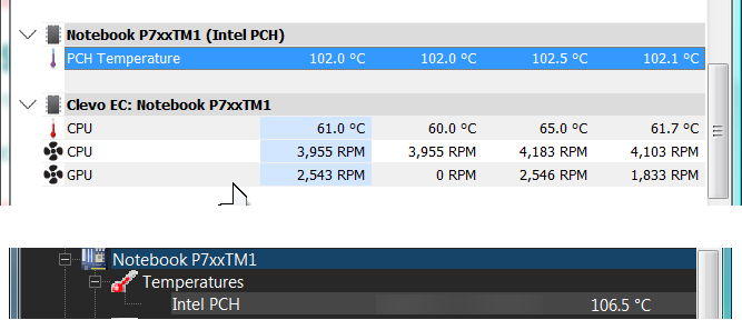

dude-137 Posted June 15 Author Posted June 15 A while has passed, more research and observation was made. Out of the blue, I noticed something I've never been paying attention before. The PCH temperature field in my HW monitoring program. And I made a bad conclusion: the PCH continuously runs at 102-103°, sometimes reaching 106+°! All the time! (see image 1). This effectively renders it as the hottest-running component on the entire MB! I also noticed that doing Fn+1 gradually lowers PCH temps to 90-95° and then they sit in this range. But then what, need to be in Fn+1 mode all the time? For the temps that are not extreme but are still very high? Combined with the fact that the component that bricked my PC was PCH (see image 2 where two images are combined), I made the following assumptions: No proper thermal handling of PCH in all laptops, which might be one of the main reasons why laptops' MBs die. - In all laptops, no proper cooling of PCH is bad but is taken by laptop manufacturers as normal-by-design. Sadly, Clevo is among the bad guys that haven't done anything in this direction. - For proper thermal handling, the placement of PCH should have been on the other side of MB where airflow actually exists, not under the keyboard (see images 2, 3, 4). - Or even better, it could have been moved to under-the-heatsink location, so that the heatsink was actively cooling it, and the owner could apply thermal paste not only to CPU and GPU but also to PCH. - My PC got bricked because of 7 years of continuous use with this design flaw and with PCH always running as hot as 100-107°, which caused the chip to fail permanently one day. Custom PCH thermal handling solution/mod is really needed, especially in powerhouses like P751/P775/P870, in order to make them live much longer. Look at how the situation is out of the box, on images 2, 3, 4. Unfortunately I have no idea about how to measure the distance between the PCH's metallic cover layer and the barebone's metallic frame below the keyboard. And this is important to know to proceed. Generally, I have several ideas that come into mind are: 1. Putting a good silicon thermal pad of the right thickness right on the PCH's metallic cover layer, so that it aso touches the barebone's metallic frame, thus thermally connecting PCH to it and helping to keep it cooler by using the barebone as one big heatsink. 2. Finding some thin copper heat-dissipator-style heatsink that can be applied on PCH in CPU-style (with thermal paste like MX4) and would fit between the PCH and the barebone's frame, and bending its copper "arm"/heatpipe in a way that it touches the metallic frame, thus again "leaking" the heat to the barebone's frame. Honestly, I don't think such thin solo CPU-style heatsinks exist. UPD: no, this is a stupid and unfeasible idea. 3. <..?..> Are my assumptions correct? Are there any other ideas for thermally connecting PCH to the metallic frame under the keyboard? PS: To roughly estimate the distance from PCH to the frame, i stuck 3 1mm pieces of double-sided tape together, put them on the PCH, and put the top laptop cover with KB-bay back, to finally get this stacked tape block stuck to the metallic frame, which means that the distance (and the needed thermal pad thickness for the idea №1 above) is 2.5mm < x <= 3mm. See images 5, 6. As I know, such a thick thermal pad of 3mm thickness won't make it any better, so the idea №1 above needs to be modified or discarded (am i right?).
Scruffy Posted June 17 Posted June 17 u need pch replacement. there should be a code written on it like slrxxx to identify the correct model. that lateral burn mean something burned inside the die.

harkaz Posted June 30 Posted June 30 @dude-137 A 100+ degrees Celsius PCH temp is definitely not normal and not a design flaw on Clevo's part. The max I have got with regard to PCH temps is 80 degrees Celsius. I would suspect an electrical problem (overvoltage maybe?).
dude-137 Posted July 2 Author Posted July 2 On 6/30/2026 at 11:36 AM, harkaz said: @dude-137 A 100+ degrees Celsius PCH temp is definitely not normal and not a design flaw on Clevo's part. The max I have got with regard to PCH temps is 80 degrees Celsius. I would suspect an electrical problem (overvoltage maybe?). Yeah that's the thing I think too, this looks too bad I've never overvolted anything, I only undervolted the 9900K to the stable -95,and that's it. Btw, maybe there's smth I could check also in the BIOS? I have Obsidian Unlocked BIOS, where/what should I look for if anything?

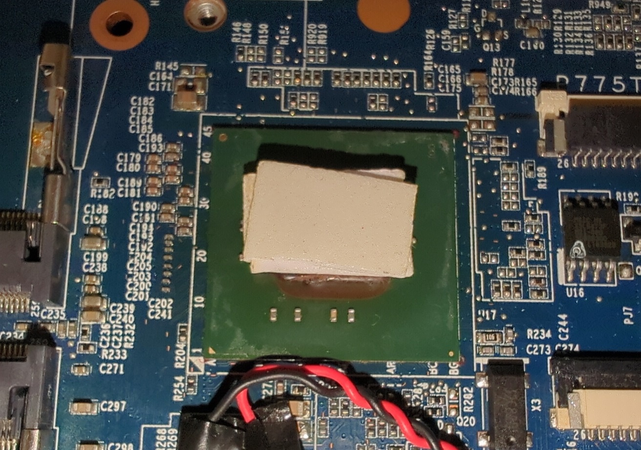

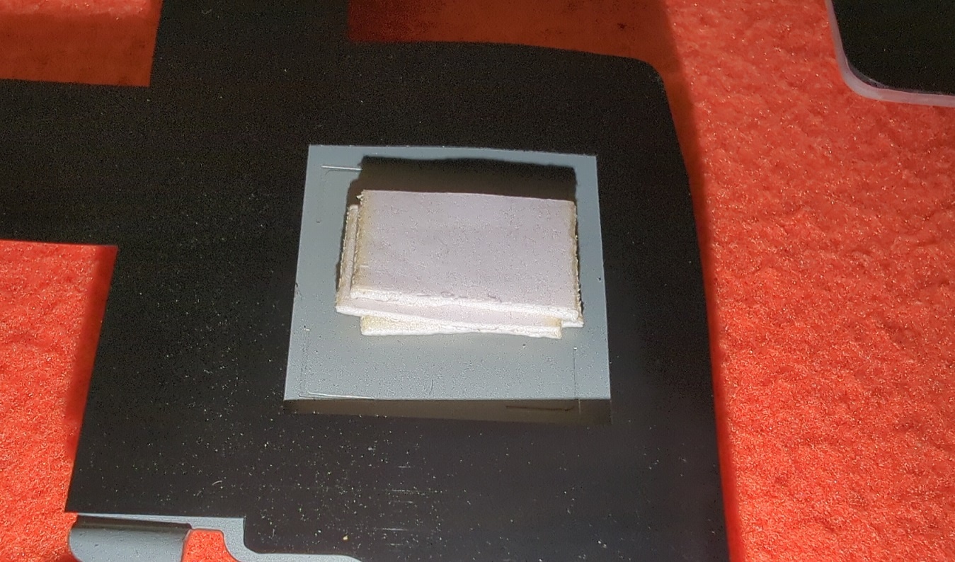

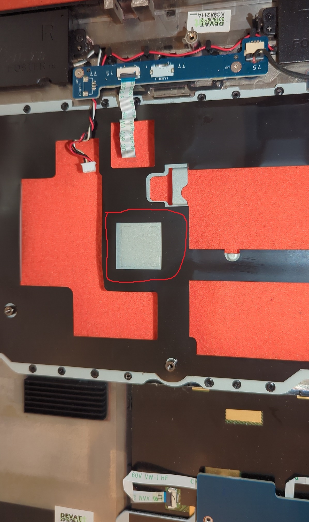

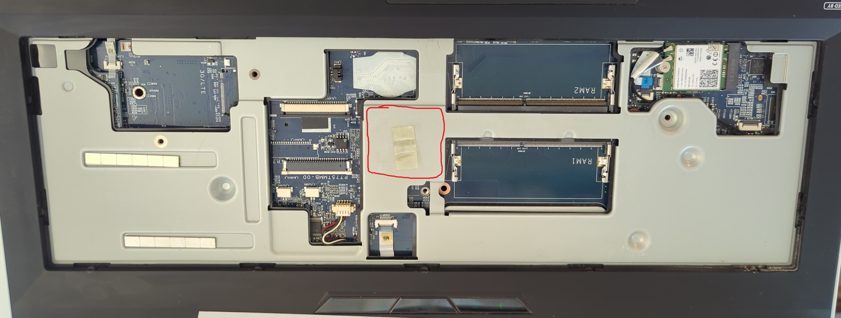

dude-137 Posted July 2 Author Posted July 2 I've made a hardware mod with applying a square copper plate on the chip and thermally connecting it to the metallic frame right above it. Changes: - First 15-20mins after boot, looks better, 95 degrees instead of 103-106 without Fn+1, 82-84 instead of 95 with Fn+1. - (no Fn+1) As the time goes by, temps gradually go up and up, and at some point I reached a new maximum: 110. Holy hell. - (with Fn+1) Temps go down slower than before, but still they go down to 82-85 degrees with Fn+1. - What the hell: I think, the metallic frame above PCH / under KB is just really bad at temperature dissipation. I understood this by removing KB and touching different areas on it while having the PC running. At some point, the area under PCH reaches its heat limit that can no longer be effectively transported with this bad temperature dissipation, and so temps just go up and up. Now my HW-level idea and plan is to lead the heat out of that area directly to the fans, the most realistic and light-weight idea is to do it using naked copper wires @ 0.5-1mm thickness, routing them from the PCH / square copper plate and the frame area above - to the left to the CPU fan, and to the right to the GPU fan - having them attached to the frame and thus also sharing some heat with it and its distant areas that are currently "unreachable" for the heat. Attaching the wires to the inner side of the frame first of all, and maybe also adding on the upper side. Good idea, or mehh? xD If anyone has any ideas, tips, advises, I would be grateful. :-)
harkaz Posted Friday at 08:47 PM Posted Friday at 08:47 PM @dude-137 Based on my personal experience: Using "Balanced" Windows Power Profile when idle - clock set to 3.60 GHz the temp fluctuates around 60 degrees. "High Performance" profile will lead to a gradual overheating of the PCH up to ~80 degrees - clock at 4.68 GHz. CPU core voltage offset around -72 millivolts. In my opinion, the voltage of the power rails of the PCH should be measured. I have never modified the cooling system at all and still I am far from 100 degrees (also many VMs are running synchronously).
